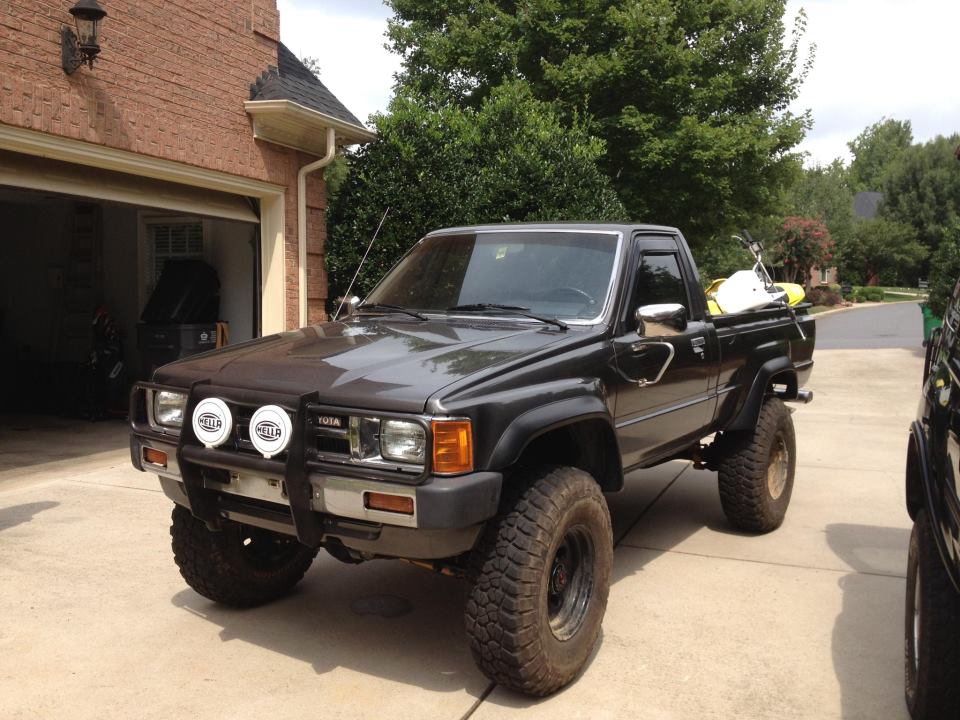

My Driveway!
Just thought I would post a pic of my driveway. This is why I get up and go to work everyday to save extra money to spend on the children!

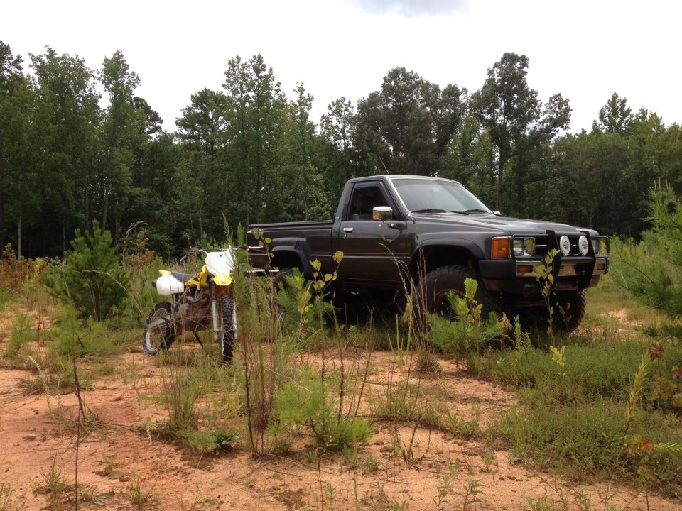

Heres a couple pics of the yota from today. Took the dirtbike out for a bit.

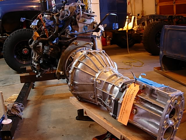

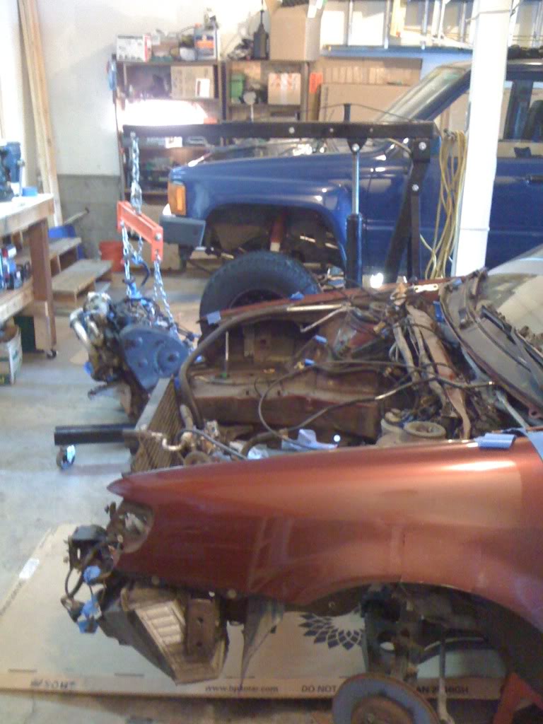

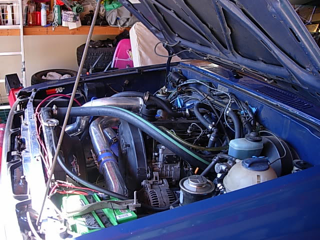

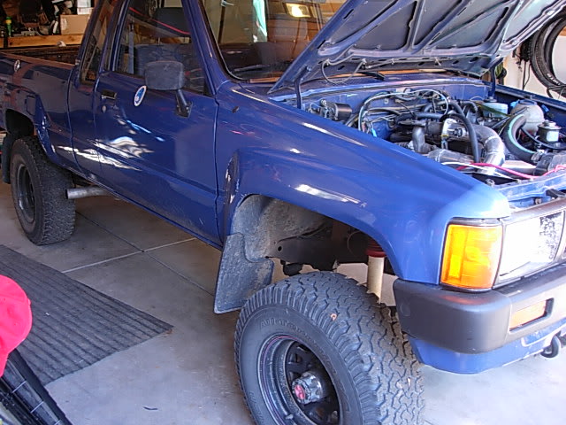

Here's my little 1984 Toyota Diesel with a '97 VW 1.9 liter TDI in it. The engine is from a Passat. It makes approx. 130hp & 200+ ft lbs of torque thanks to Bosio .520 PowerPlus injectors and a http://www.frankenbuilt.com tune. 2.5" exhaust with mild resonator, EGR delete, K&N air filter, FMIC, ACME transmission adapter (edit: ACME's adapter proved to be 1/16" out of center. http://www.shadowwerx.com/ made a new one centered/machined to within 1/1000 of an inch), used the stock G52 transmission, Marlin Crawler/Seco 1800lb clutch, Trailgear crossmember mount, 2.0kW Hi Torq starter, Sky rear disc brake conversion, and lots of other stuff... with lots to go. This Toy's suspension is worse than stock: 3-leaf Rancho lift springs from ages ago are rattling my kidneys daily (this is my daily driver here at 6000'). Suggestions on good, softer, bolt-in leaf springs are welcome. I'm enjoying seeing others' rigs and reading what folks like suspension-wise.
Build thread is here:
http://forums.tdiclub.com/showthread.php?t=304345
Image links below take you to a lot of pics on my photobucket showing starter and flywheel changes, motor mounts, t-case positioning and gearbox changes, etc. etc. Lots of pics.
About to take apart two perfectly running vehicles - yikes!

Pulling everything apart

G52 ready to meet 1.9 TDI

Power Plant

Profile

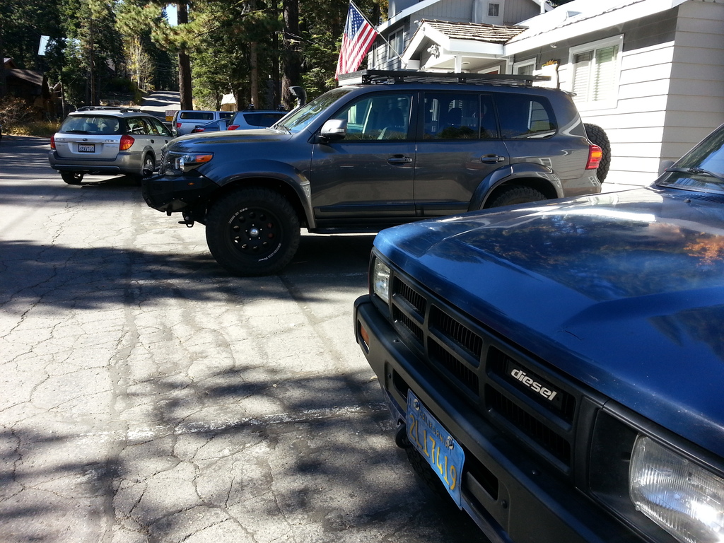

2015 Land Cruiser (by SMC Fabworks) with '84 Toyota TDI - what a difference 30 years makes.

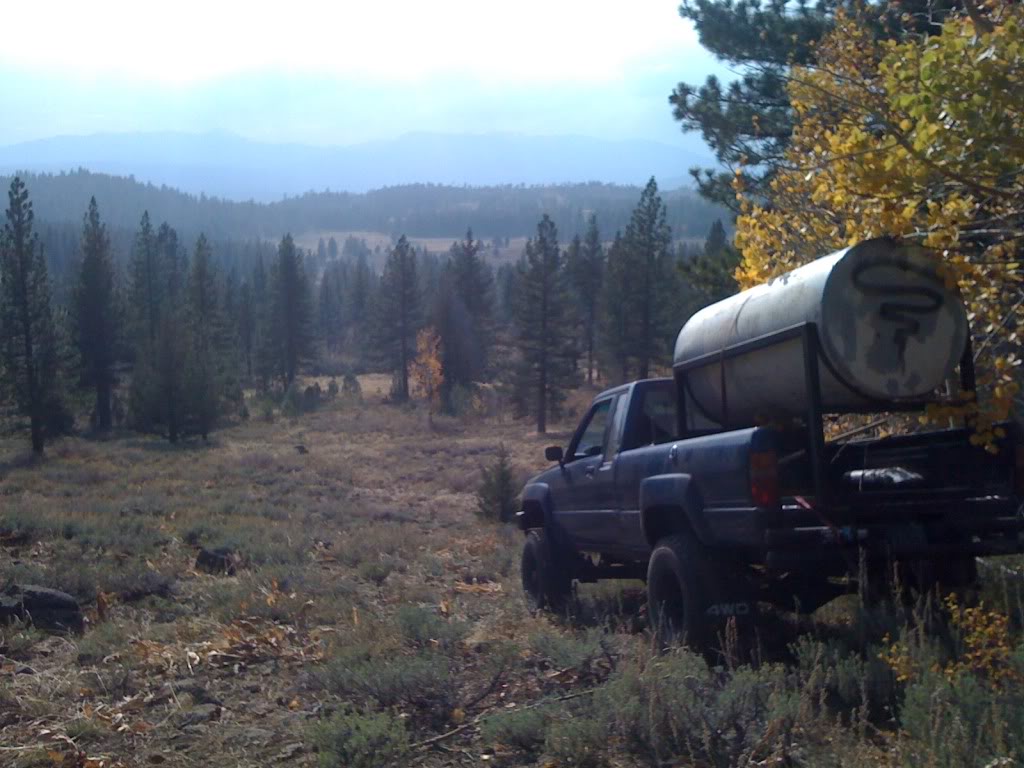

Delivering a water tank to roadless spot.

Originally Posted by sam24th
Interesting way to load a bike.

Nice work. Did you mount your air filter behind the headlight or run it under the fender? Heres a comparison of my 87 1.6 VW TD in my 85.

love that picture witht the water tank trukee. sweet diesel. make sure to submit that for the calendar contest
Old Aug 23, 2012 | 02:24 AM
  #1316
rokblok's Avatar
Joined: Feb 2011
Posts: 1,869
From: The Dirty South
^^ x2. I would love to have a fuel tank that size, plus the TDI, and travel the country. Just fueling up once before I left....
Old Aug 23, 2012 | 07:00 PM
  #1317
grant526's Avatar
Joined: Jan 2008
Posts: 562
From: Sacramento Valley, Ca
Talk about needing add-a-leaf springs to carry the extra weight...
