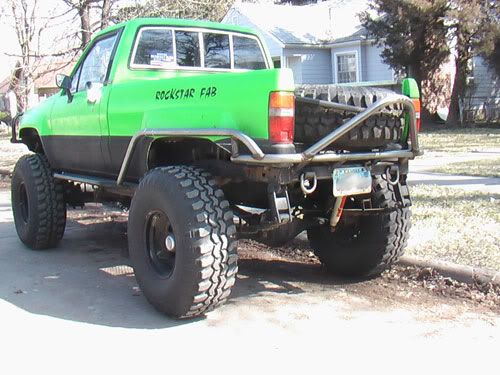

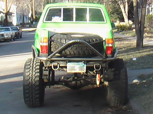

can someone post up some pictures of an 84 or 85 pickup with a dovetailed and bobbed bed id like to have a picture with the tail gate on.
and yes i know i did search just couldnt find anythin when i searched i might have not typed in right in the search but figured id be easy to ask.
and is this street legal? both bob and dovetail.

as far as being street legal it is gonna depend on where you live.
In Oregon the tires have to be covered with a fender/mudflaps.
with google I found these:
http://pirate4x4.com/forum/showthrea...ve+tail&page=2
Originally Posted by fprbrooks
Here is how I did mine. Bobbed 12" and dovetailed
probably one of the best write ups: http://pirate4x4.com/forum/showthrea...ight=dove+tail
Originally Posted by MUCHADO
Cut floor out and mock'd up:
Finish'd up with and expanded metal floor, new fabb'd bodymounts and some tubage:
more sheetmetal is going to get cut and the kickers coming off the mini stinger serve as bedside supports since when you dovetail a bed you lose support from the floor and the sides get floppy.. now the sides are as sturdy/sturdier than stock...
http://www.pirate4x4.com/forum/showthread.php?t=431193
