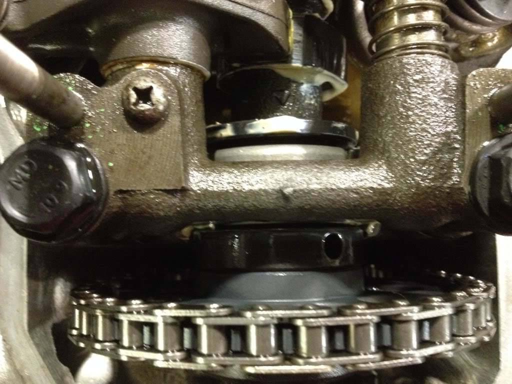

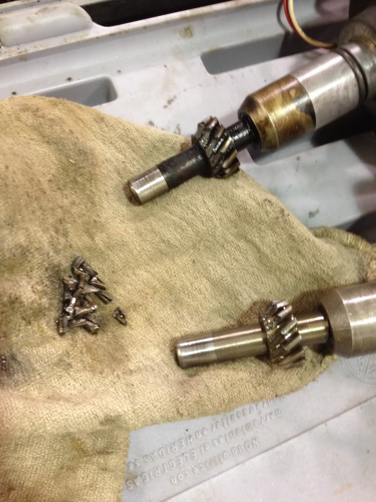

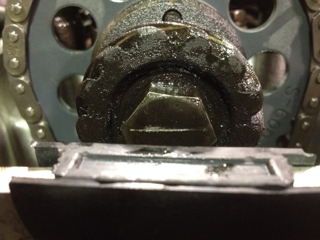

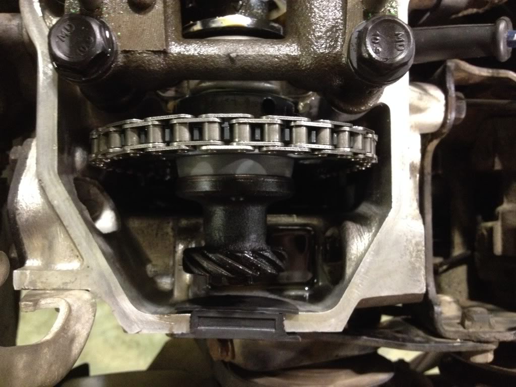

Ok guys. Many of you know that I have been building a new 22re to go into my runner. Well I finally get it in today and try to start it up. Its backfiring like the timing is out. No big deal. But before this I realized that the distributor was not seated all the way on the head. So I had to give it a few taps with a rubber mallet to get it to seat the last 3/16's or so. Still no big deal right. But I pulled the distributor out to swap with another one that I had and found that the gear on the distributor was ground down!!!!!!! Both of my distributor gears got destroyed from the Cam gear!! I cannot figure out what is going on here. Everything is new in the block or has been redone. Like the cyl head, block, etc... New engnbldr 268 cam and timing kit. Any help is appreciated guys.
Heres a few pics.

OK, I picked up a third Distributor, Installed it in the head, cranked the engine over by hand with the valve cover off so I could watch what was going on. I did not even get a full revolution around and it started eating off the distributor shaft gears.

Is it possible that the cam gear is to far in or out? Meaning to far towards transmission, or to close to radiator... If that makes sense.
It seems like there may be a spacer/washer added or missing from one side or the other. Because you stated the cam is seated properly, and the distributor can't move up or down, so the cam gear being to far forward or back is the last option.
Can we get pics from the same angle that the distributor goes in? A close up from the driver side of the head/distributor area.

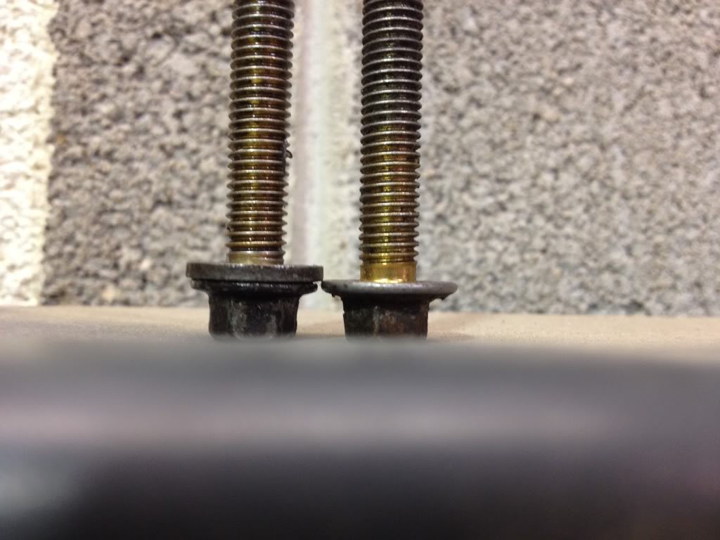

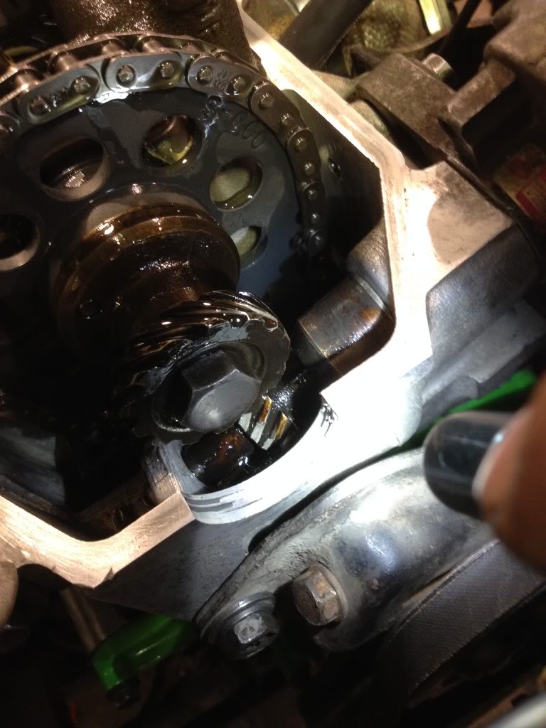

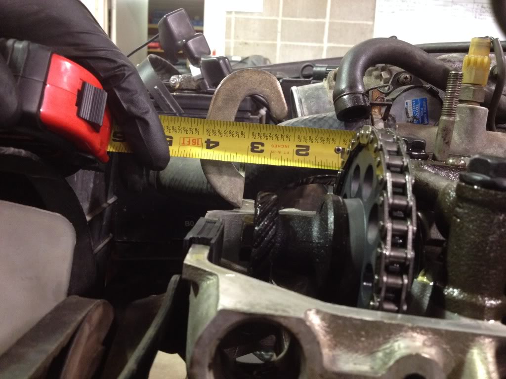

Here's a few pics. Of new and old engine
Here's the new engine. I scribed the bolt with a ruler on the head surface
Old engine. Same procedure

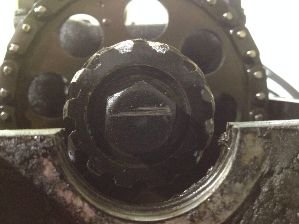

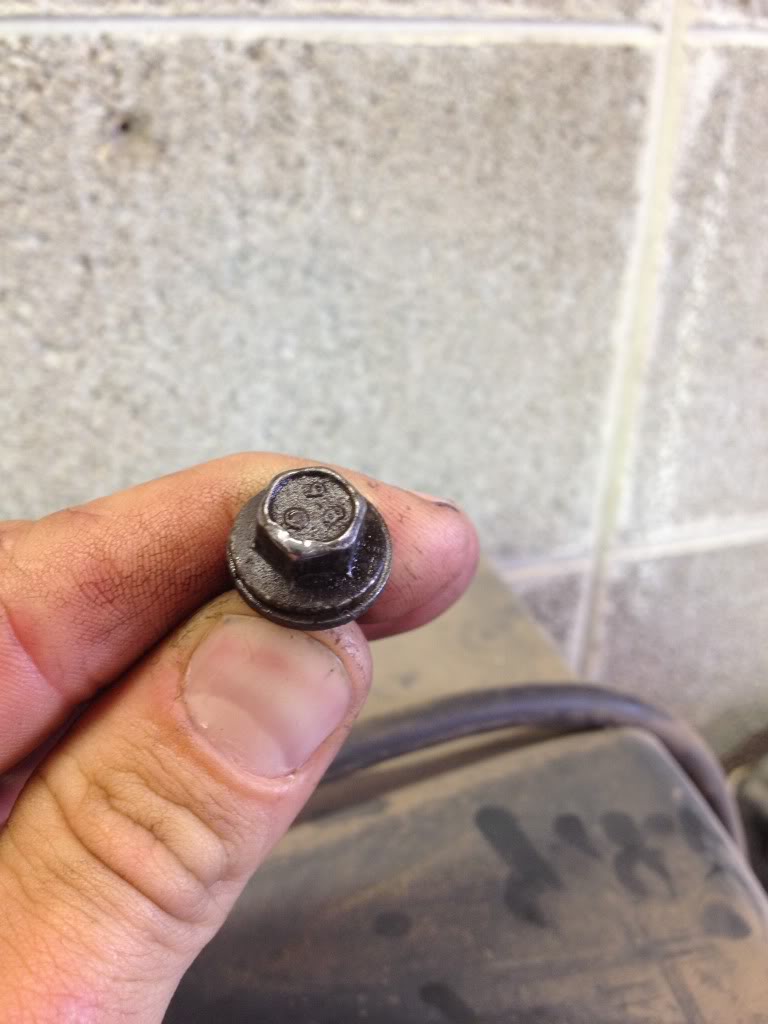

I figured out the problem. After a few hours of installing the distributor into my new engine and then the old engine, then the new engine again. I found that the distributor was always sitting 1/16 of an inch out away from seating in the cyl head. I ended up draining out the puddle of oil that collects where the hidden timing cover case bolt sits and Voila!! I had a bolt in there that had a washer on it, causing it to sit about a 1/16th of an inch to high.
Just enough to cause the dist to stick out to far.
What was happening was that the distributor gear was getting bound up between the cam gear and the Timing cover bolt. Therefore causing the gears to be shaved off.
Here are a few pics of the bolt that was the suspect.
Thanks for all the help guys. This was driving me crazy.
Here are a few photos.
The bolt with the washer causing the issues on the left
Heres the top of the Bolt where it was getting worn down from the distributor gears.
