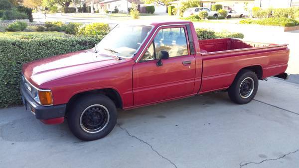

Hey guys, I've been wanting an older pickup for a while and even though I was looking for an EFI model I found a '85 in good condition so I pulled the trigger on it.
I don't like the low-rider looks so I have a 1.5" BJ spacer on order as well as a basic AAL. I might upgrade the tires to 215/75/14 (currently 195/75/14) depending on the fender gap after the aforementioned lift but dont' want to overdo it. I really have no intentions of converting it to a 4x4 (I have a built SUV for that). In fact, the looks of this beige 2WD really appeals to me.
BTW, why are we (84-85) trucks are in a separate room than the rest? are there major differences between 84/85 and 86+?

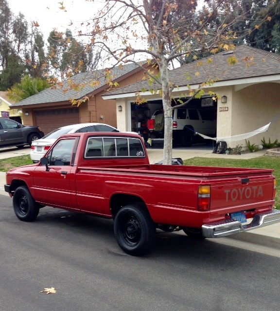

Also put in some elbow grease with the orbital buffer which brought back some shine. Not sure for how long because the paint literally lifted off and into the orbital pads (ruined 2 pads in the process). This however should buy me some time before I get it repainted. I was thinking of throwing some clearcoat on it- the rattle can variety to protect the paint but I'm afraid the clearcoat itself might not adhere to the paint and start flaking off soon.

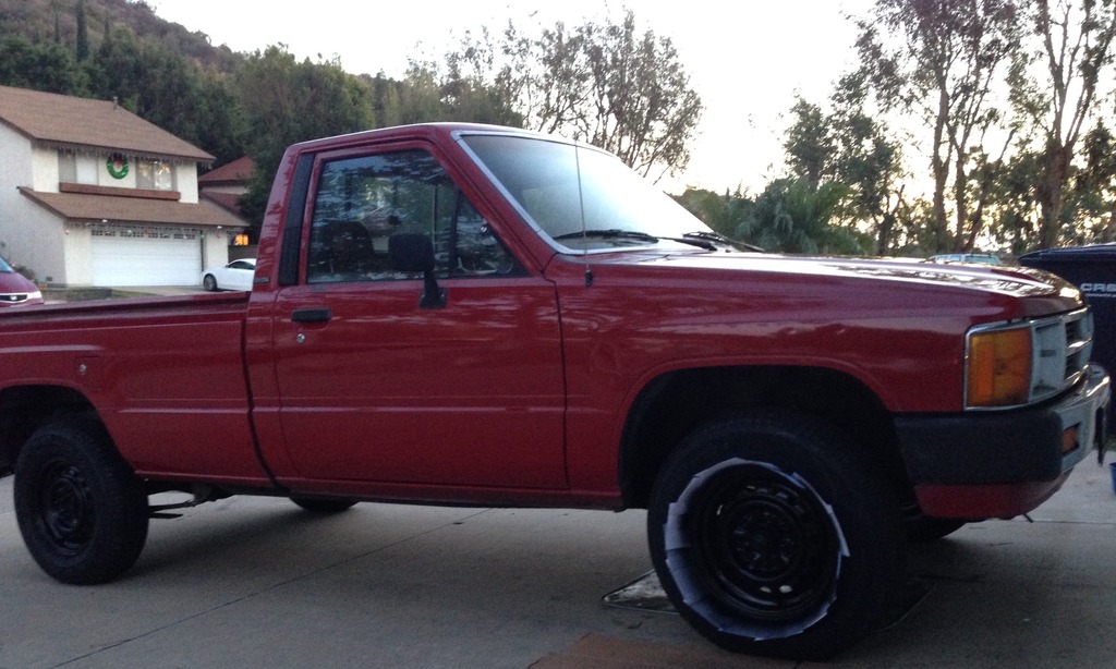

I snapped a couple of pics today while touching up the wheels. It sits about 2.25" higher in the front and about 3" higher in the back compared to when I got it. I'd like it to be level but I'm sure the AAL will settle over time. Also removed the toolbox from the bed- which will limit storage but I like the cleaner look. Same with the chrome trim rings around the wheels.
Before:
After:

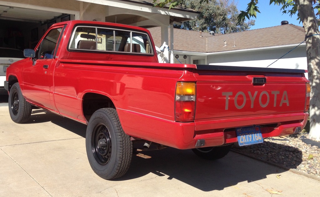

Thanks! a couple of more shots for good measure

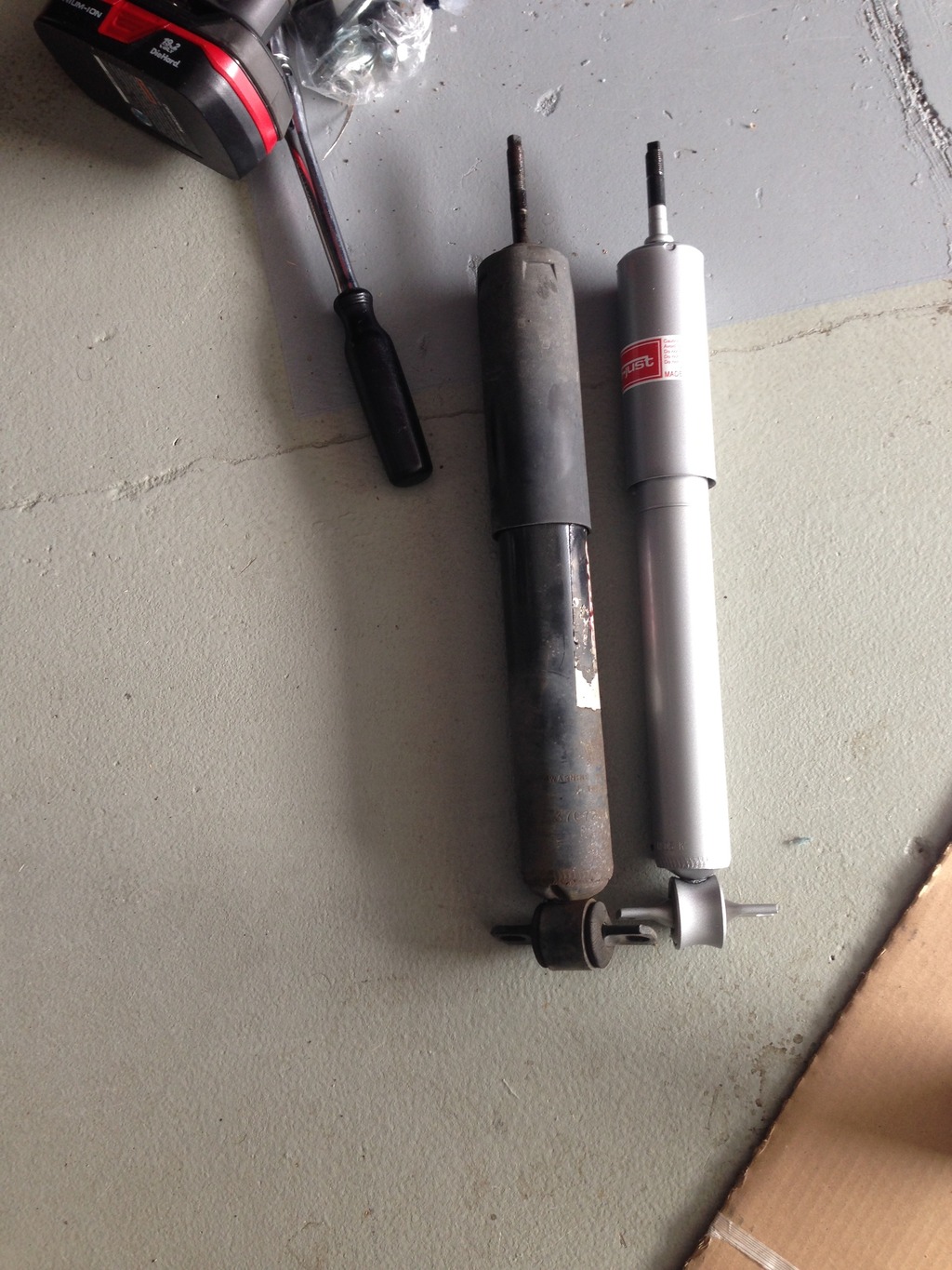

Cleaned out the interior and installed new KYB gas shocks at all 4 corners. The old Sensatracs were surprisingly the same length (I was hoping the KYBs were a little longer). The old ones are also much more substantial but the ride quality has improved by quite a bit. The truck still has choppiness going down the road which I think is the shocks maxing out due to the lift.

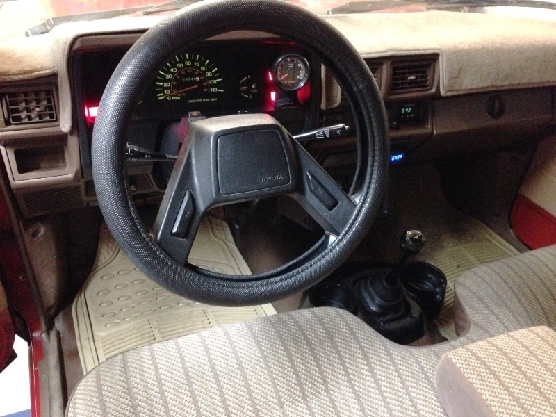

Here's a pic of the interior with the Ford Ranger cup holder console and the tachometer. The bright blue LED is a USB plug in the cig lighter that shows the voltage, amps and interior temp - $15 on Amazon. Not a clear pic as it was dark already.

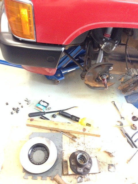

The front brakes always pulsed, likely the rotors were warped and having no previous records I decided to change out the front rotors, pads, inner and outer wheel bearings and the seal. Took about 3-4 hrs for the whole job but now I won't be so worried on twisty roads about the wheel bearings going out and the brakes are now smooth. Although they don't have the bite that I was hoping for- may have to bed them in for a bit before I decide if they're good enough or not.
I still have to change out all the ball joints and tie rods etc just cuz I have no prior history and the steering wheels is a bit vague with more free-play than I like.

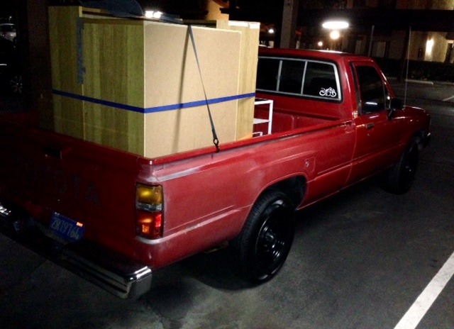

Earning its keep, helping a friend move:
