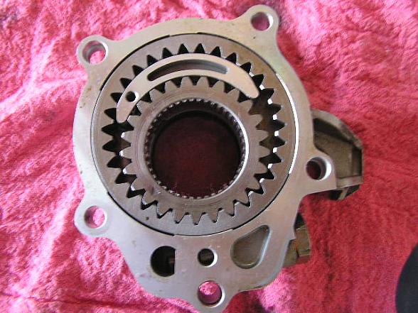

Can anyone answer these questions
Earlier I started a thread about my oil pressure problem..
Here is a picture of my (85 4runner 22RE) oil pump.
I have taken the grears out and looked but I dont see how this this thing pumps oil. Since I am haveing trouble with it taking a long time (20-30 seconds) to build oil pressure does anyone see anything wrong??
Can anyone explain these mysteries of the universe??

Looks good to me, might have to looked it over with the FSM and check tolerances. Have you tried putting a REAL gauge on to make sure that your oil pressure takes that long?
http://en.wikipedia.org/wiki/Gear_pump

Yea just like that animatied pic up there it uses 2 gears to pump oil as i passes through both gears and is forced in a hole. Any who your gauge may not be working properly. Is there bookoo engine noise to where it seems like lack of oil? You can try replacing the pump but your guage might be fualty.

Ths is a fairly newly rebuilt engine with a new oil pump. It has always taken a long time to build oil pressure..

was the oil pump primed correctly when installed?
https://www.yotatech.com/forums/f116...priming-78784/
