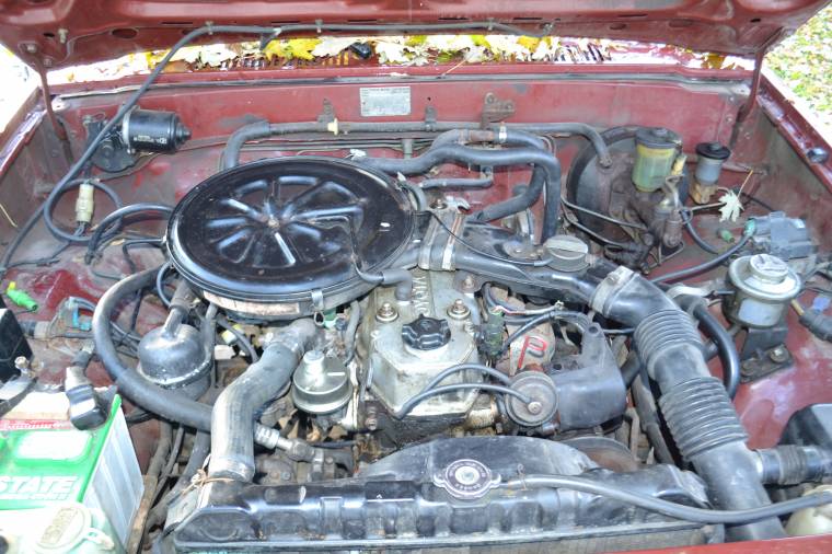

Well, there wasn't much action over in the newbie section, so I thought that I would try it over here. Anyways, I just recently pickup up this 1985 Pickup 2wd for $2300 (How did I do?). It says sr5, but the vin shows that it's a deluxe, so I'm not sure what's up with that. The guy I bought it from said that his dad had bought it in 1996 with 112,000 miles, then drove it around town up until about three years ago. It now has 148,000 miles, but is kind of running rough and dying at when off of the throttle (hopefully just bad gas). The interior looks pretty good, but it definitely needs a new stereo and door handles.
So far I have changed the spark plugs and air filter, but plan to do the spark plug wires, distributor cap, oil and filter change, valve cover gasket, fuel filter, and anything else that I can think of. Also the bed has a couple of rusted out spots in the floor, and the seams are starting to separate, so I'll need to do something with that.

Well, I'm having some new problems. It started right up and idled well while it was in the driveway, but when I backed it into the street to park it on the curb it kept stalling and then refused to start. I eventually got it to run enough to get it back into the driveway. I'm hoping this is just because he said that it hadn't been driven much in the past 3 years, and it had a full tank of gas. I still plan to do the cap and wires, and anything else, but I have also noticed a grinding sound coming from what seems to be the transmission. It happens in neutral, both with the clutch depressed and released, so I'm not really sure what that is. I'm still trying to do some DIY diagnostics, but I not that sure of what I'm doing.

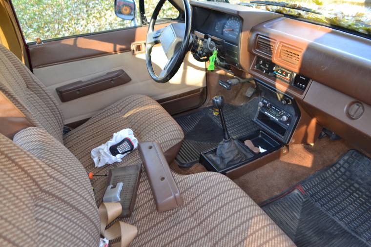

Thanks!The interior looks kind of torn apart in that picture, I was taking out the lock cylinder in the door to get a new key made. I think that once we get it insured we are gonna take it to a shop to get one of those "new car" inspections and just see what's up. I'll probably get the cat converter replaced at the same time because there was some shoddy work in trying to get a leak fixed, and there is exhaust just pouring out.

Step one. Take that jank arse factory carb off and out a Weber 32/36 on it. Will more than likely solve most of your issues. The factory carb is a cranky miserable little carb that is finiky and a pain in the butt to rebuild.

Nothing mixed about it. I have a factory aisin carb. I rebuilt it with my own 2 hands. (pics in trekker thread) Its an over complicated pile of crap. The design itself seems to collect dirt. They never stay in tune long. The electric choke is a nightmare of linkages that only a swiss watchmaker can truely understand.
Weber is much more simple. Less parts. Easier to jet. Cleaner. More effiecient.
Looks really good. Cheaper than a new aisin. Makes more power. Really cleans up enginebay.
It is really a no brainer.
On my very short list of things to do to my trekker. Even after rebuild, my choke is a turd. I need a decent carb to finish my driveline assesment.

Have you changed out your fuel filter? Cheap and easy and often overlooked, it cured what I thought were my "crappy" Aisin carb issues.

I was also wondering about the timing chain. Well, the PO said that he recently replaced the chain with one he had laying around, because he knew that it was a weak point, but he didn't say anything about the guides. Would it be worth it to replace all that stuff when I dig in there to replace the valve cover gasket, or do I have some time? Also, what is the "chattering" supposed to sound like, like how loud is it? Thanks.
