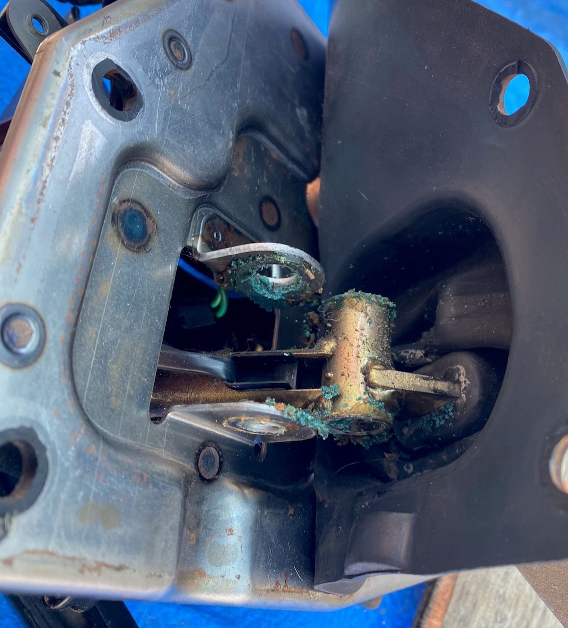

My 1985 pickup's floor shifter for the automatic is loose and I'd like to fix it. I found a video for a newer model and it was a simple bushing replacement. I haven't found where to get replacements for my '85.

found the bushing issue. blue stuff were the bushings. Amazon seller has them as does many other places. Must be an issue. now if I could just find the plastic slider that's hooked to the shift. Mine was broken and that missing piece leaves a hole to the top side of the transmission.

There are blue ones and rubber ones. See my post I recently made

What recent post I searched you posts back to 11/29/23 and found nothing ? no matter, too late, this morning I installed blue ones.
