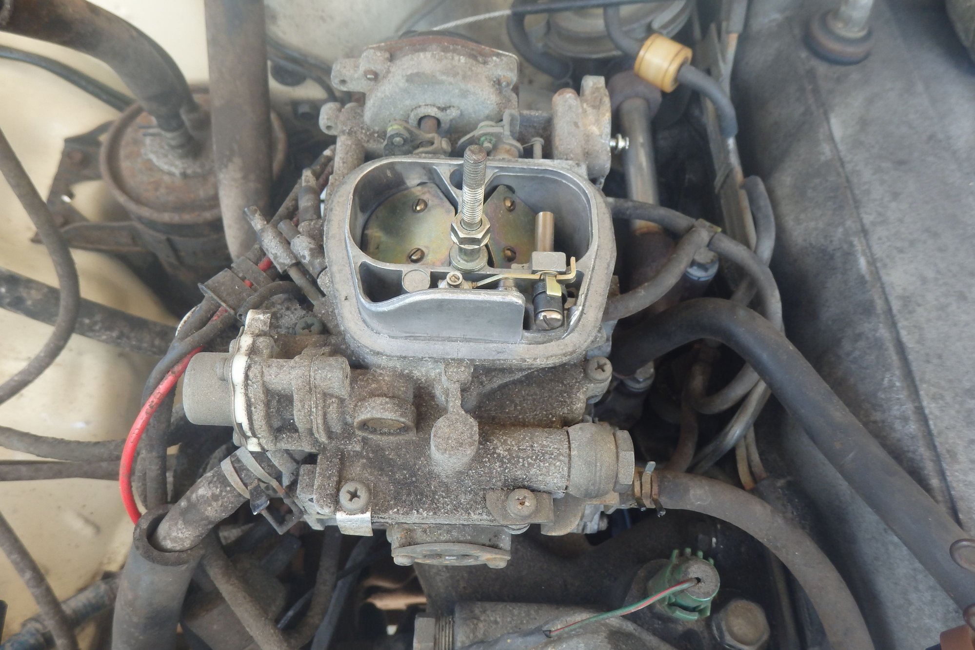

My 1985 Base model Pickup with 22R will start but not idle at low speed without stalling. When it was still running well enough to drive, it was running very rough and surging/hesitating badly. My first thought was that it might be the Auxilary Acceleration Pump (AAP) again, which I have replaced twice before. I took it out and the diaphram seemed flexible and could see no damage or holes. I MAY have re-installed it backwards, and that may be when the inability to idle at normal speed started. Today I tried removing it, to be sure it was installed correctly, and that's when things went from bad to worse. First, the spring fell out and after quick seach haven't found it yet. Next, the diaphram was stuck onto the long needle that connects to or is part of the acceleration pump itself, which did not want to come off. After destroying the AAP, the long needle now won't go all the way back in.
I have never rebuilt or replaced a carburetor, but have a friend who can help me. I started looking for different options and was surprised by the quantity of carbs out there that say they are for this model.
Any and all suggestions on brands, new vs. rebuilt, suppliers, and how to be sure the carb I get is the right one for my truck are all requested.

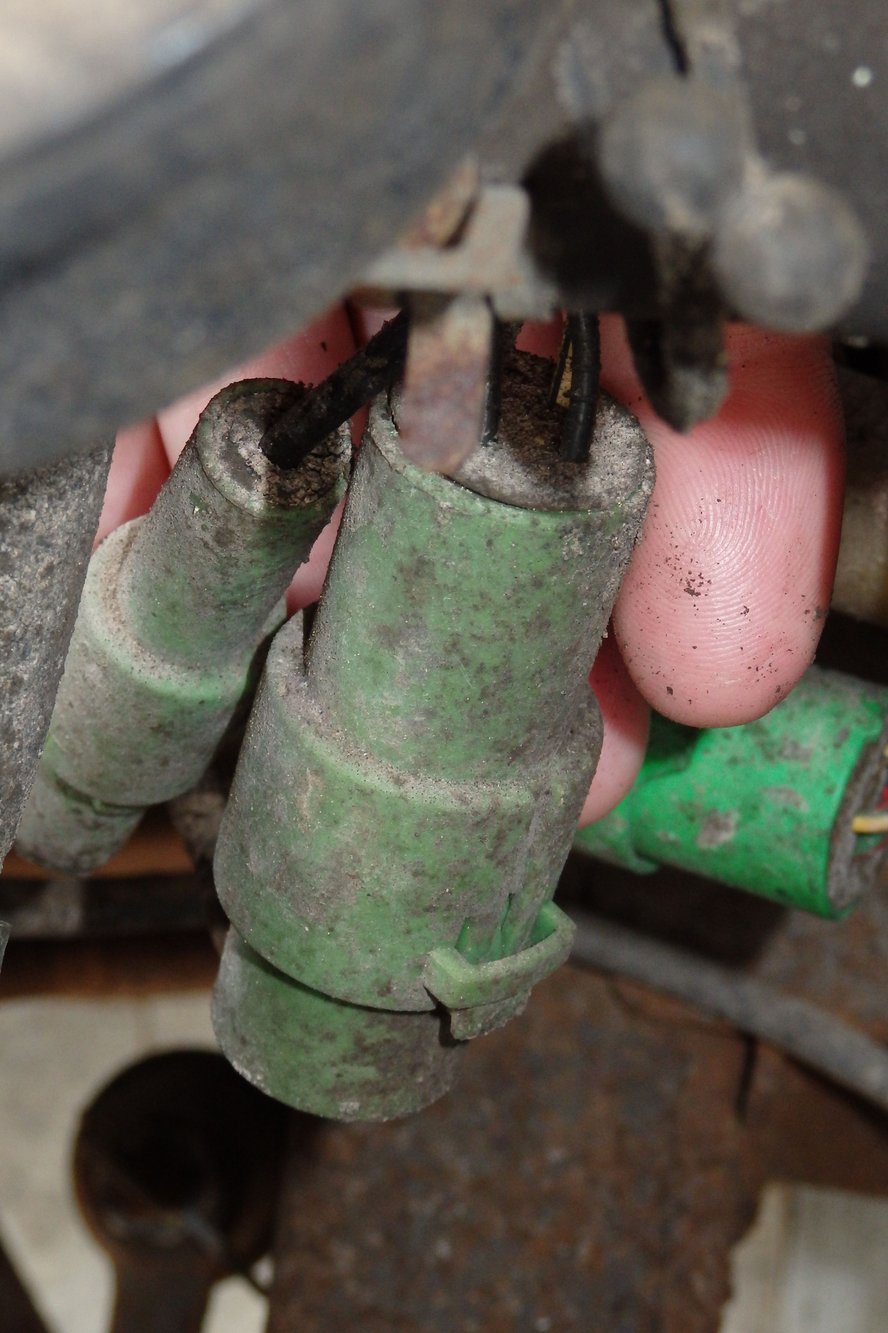

Arg. I didn't remove the AAP ... I think I removed and destroyed the Choke Breaker! I wondered why I had to use a ratcheting right angle screwdriver before and not this time ...
Have found some carbs with a round plug connector and a square plug connector (for the Automatic Choke connection) Just want to confirm its round on mine? One red wire and several smaller black wires that connect a foot or so away from carb?

That would be the round plug.

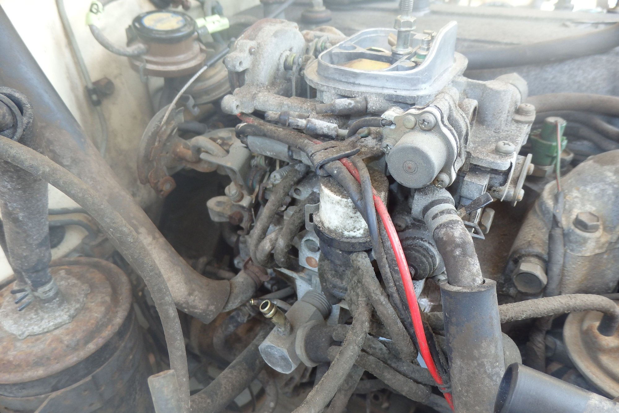

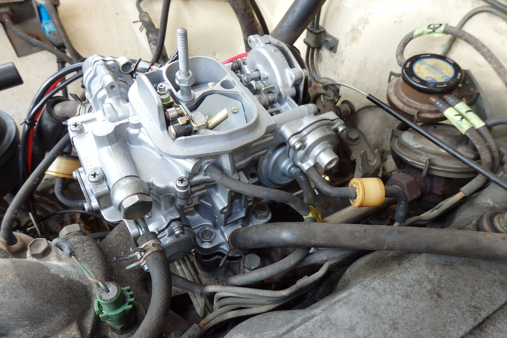

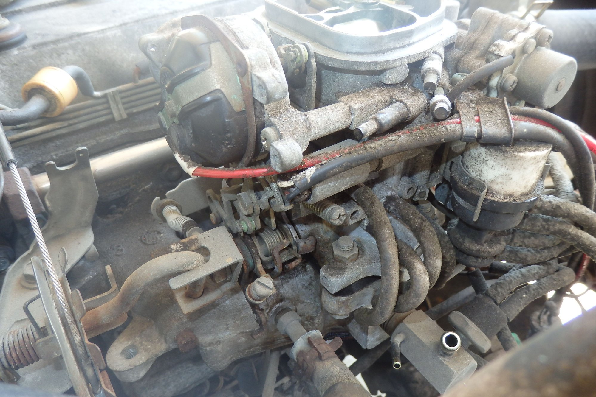

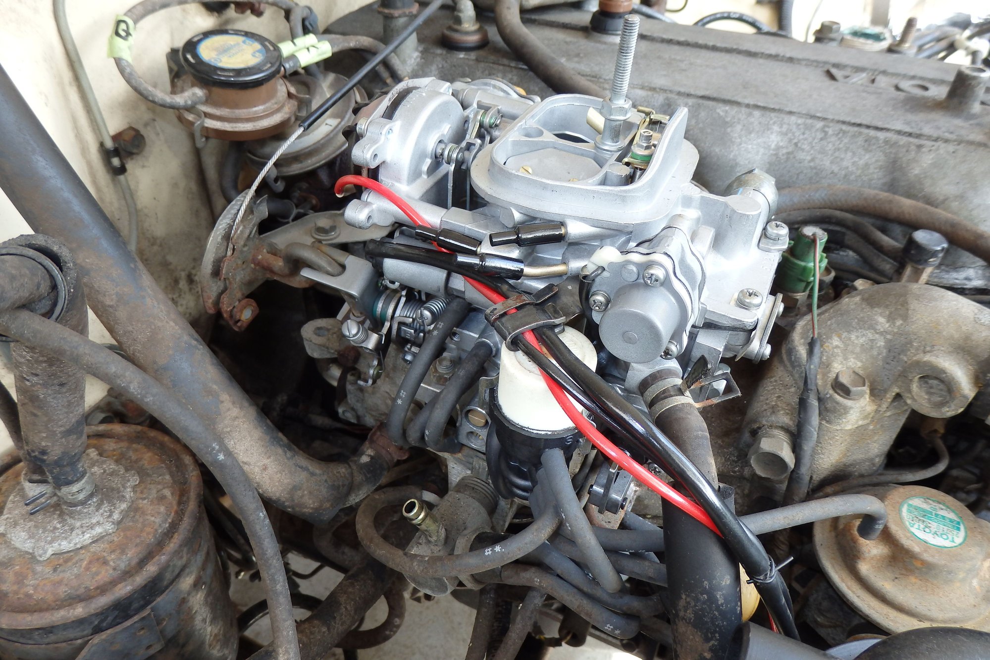

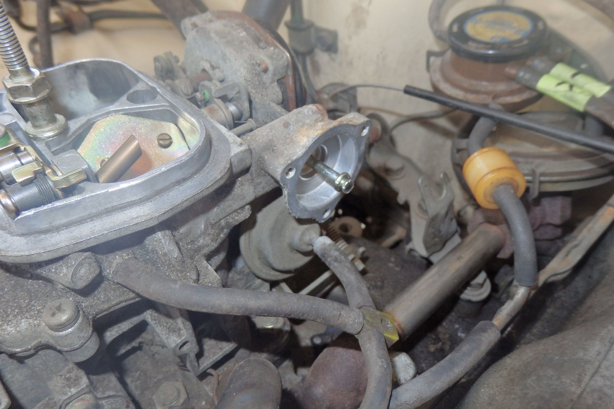

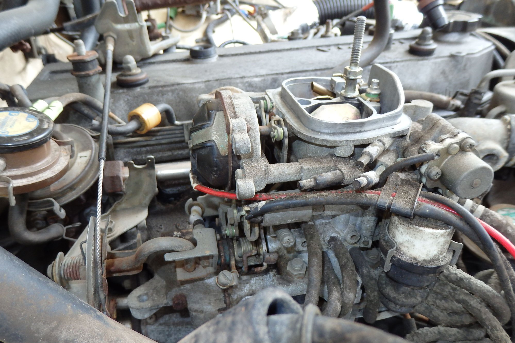

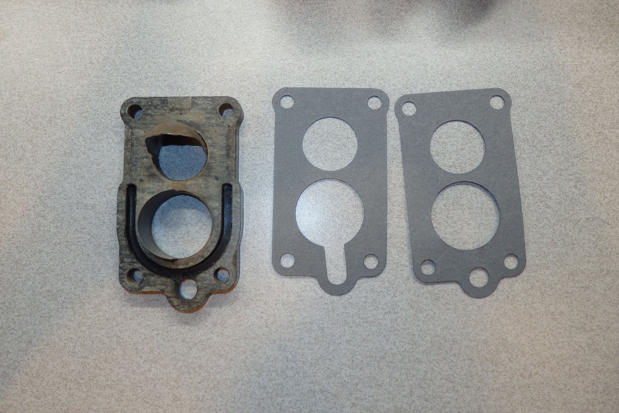

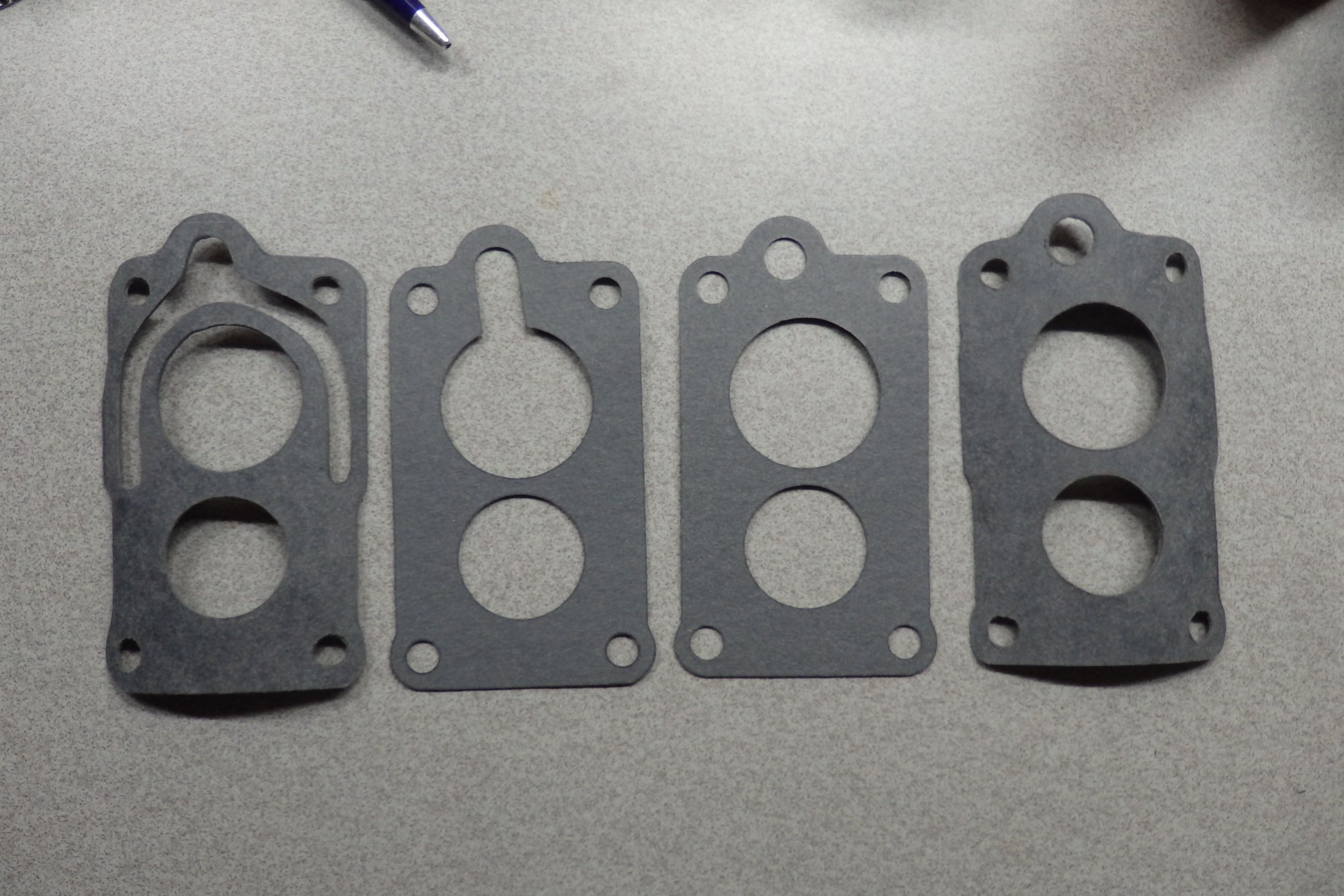

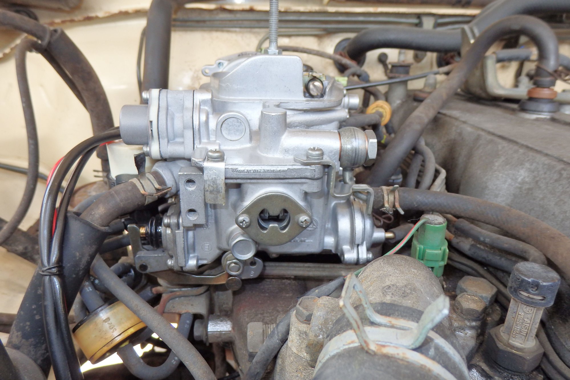

Thanks for all of the comments, suggestions, and recommendations. I considered National Carburetors, but then came across another company called Guaranteed Carburetors and used them. The total cost was about $100 less than what National Carburetor would have charged to rebuild and return my original carb. The turnaround time was fairly quick (estimated to be 2 weeks) and was in their shop for about a week once they received it. After re-installing it, the truck ran great for my first test drive. But, then the same symptoms I had before returned, with engine "bucking". After ruling out possible fuel line deterioration issue and replacing all 1/8" ID vacuum tubing, issue was finally diagnosed as a faulty spark plug wire and a new set of wires installed. Have driven a few times since and carb seems to be working great. Overall experience was good, and I was able to return base gaskets (one of which didn't match my insulator plate) for a refund. I wound up making my own gaskets for about the same cost ($9). Some rebuild kits come with the gasket I needed, but apparently not the rebuild kit which Guaranteed Carburetors uses.
Gaskets as received from Guaranteed Carburetor
Gaskets I made, comapred to those received from Guaranteed Carburetor
