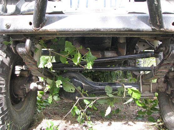

i am of no help, but id go with the leafs, they are relieable and prentiful in the NW!!! here im using one for a streering stabilizer. ha ha just kidding i thought it was funny picture from yesterdays wheelin'.
