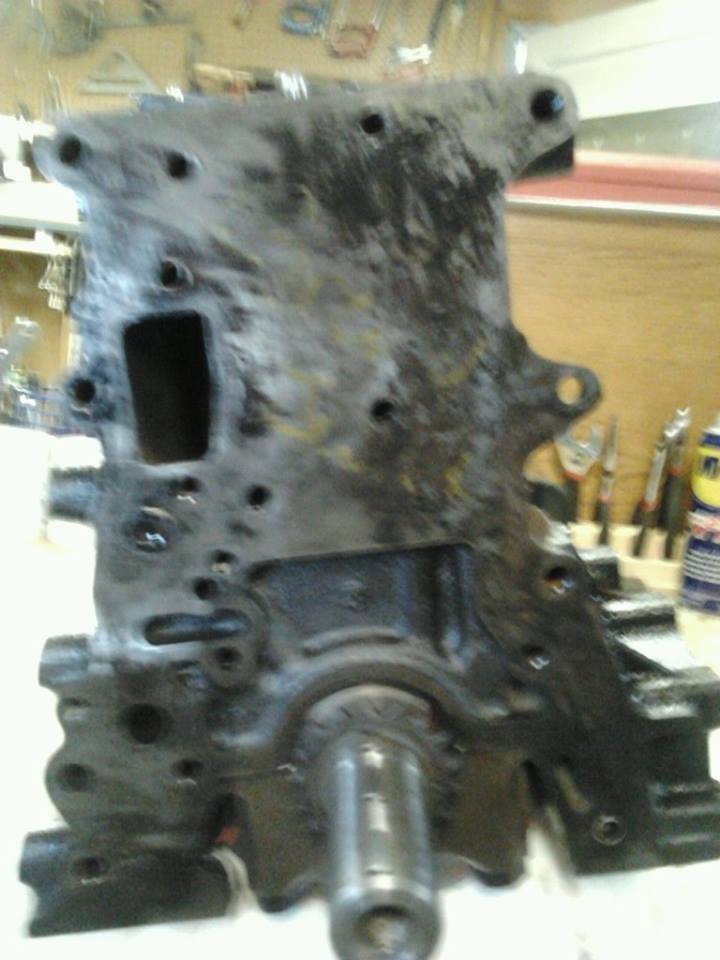

GUESS WHAT?
Old Jul 9, 2015 | 12:48 PM
  #149
mwisham's Avatar
Joined: Sep 2014
Posts: 184
Likes: 6
From: South Georgia
I know most of those pics are of the new one, but one pic looks like it is the old block. Is that right or are all those pics of the new block? Have you got the old block out yet?

Can't get old one out!! I'll have to repost the pictures because they are from Facebook and I have been told some of you can't see them. These are all of the new one. I told him I think he will need to take the wheels off and that will lower it down quite a bit and possibly someone can get it out. He has jacks under it right now. He can't lift it and neither can I. Maybe drop the old one and then put the wheels back on after the new one is put it and that will raise it up. Then possibly tie a rope around the old one once the truck is running and back up and then drag it out of the way. I don't know. We are totally at a loss and no money to rent a cherry picker or even buy one. That is not an option. This sucks!!!

These were found in the oil pan...bits of plastic and grains of metal
Stuff we found in the oil pan...plastic, metal shavings, pieces of metal, etc. Didn't find the missing piece of the head gasket tho!! Hmmmm

That looks like parts of the timing chain guides. Did he replace the old ones when he replaced the timing chain the first time? They make metal guides that is what most people upgrade to when they replace the timing chain. It probably had plastic ones originally that have broken and fallen into the oilpan over a period of time.
