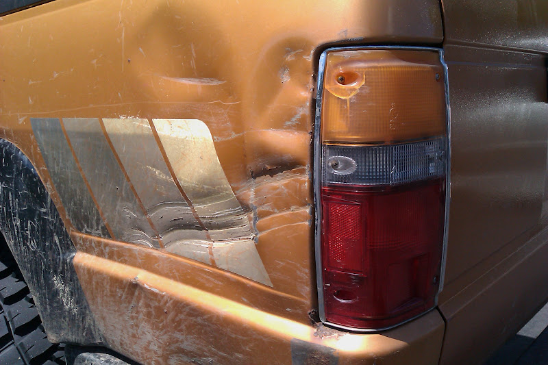

Finally put a dent in the body, while on the trail this weekend I had someone back into my truck, denting this very same spot about 4 months ago. The trails were pretty slick with all the rain we have had. Kept sliding left as I was crawling up a ledge. I didn't notice this rock until after I had hit it, and drove past it. Looked back and saw my tail light swinging by the wires.

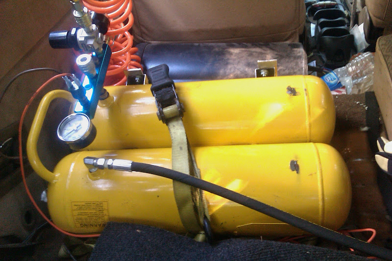

I picked up a used 12v compressor this summer and installed OBA.

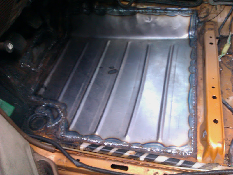

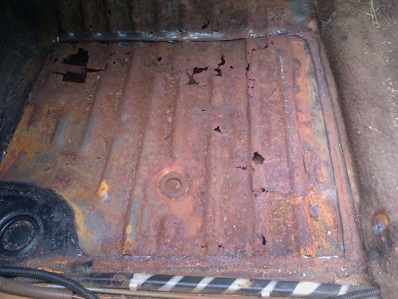

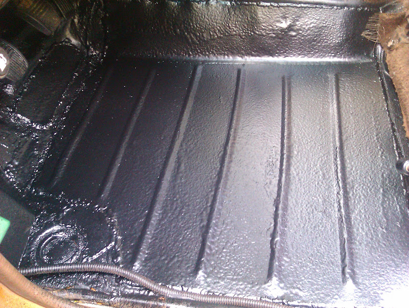

My drivers side floor pan was rusted out, I had a sheet of 22 gauge steel welded over it for most of the summer as a temp fix. This weekend I finally cut the rust out and fixed it the right way with some 16 gauge steel.
