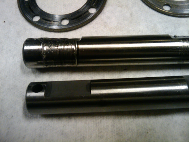

Getting the rear bearings off was not a easy task, took a lot of force and some heat as well. Now before I did any of this, I tore down my old 85 axle and mocked everything up. I wanted to see how bad this job was going to be. The 85 axles came apart with very little effort, it raised my confidence on doing this project quite a bit. But the 88 axle didn't go nearly as smooth. And after getting both axles torn down, the splines on the ends were mushroomed out a bit
I had to hand file the ends back into shape, which took a few hours. I used the locker side gears to check the splines as I filed.

Also installed new seals and wheel bearings while I was at it.Getting the rear bearings off was not a easy task, took a lot of force and some heat as well. Now before I did any of this, I tore down my old 85 axle and mocked everything up. I wanted to see how bad this job was going to be. The 85 axles came apart with very little effort, it raised my confidence on doing this project quite a bit. But the 88 axle didn't go nearly as smooth. And after getting both axles torn down, the splines on the ends were mushroomed out a bit
I had to hand file the ends back into shape, which took a few hours. I used the locker side gears to check the splines as I filed.Once the axle shafts were taken care of, I moved onto the diff. Pulled it out and dropped it on the dolly to work on it. Marked the bearing caps and pulled everything apart. I was a little nervous about taking the ring gear off, but I had faith in my self after a beer

And I believe it is the only locker of that style for the Toyotas that comes with a new cross pin, which you can see I needed.

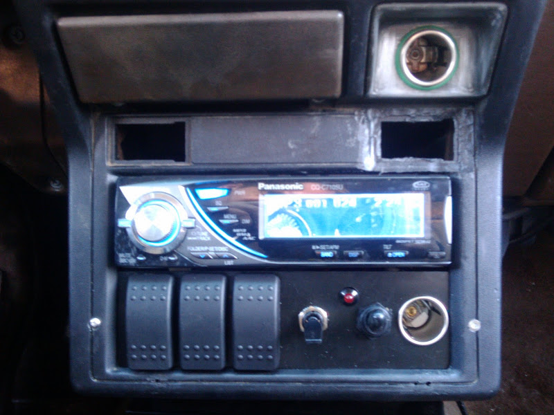

I started to work on my window wiring, a few weeks ago my drivers side window controls quit working. I used a computer connection as a quick disconnect for the wiring. Well without the plastic splash shields up front, the wiring took a heavy hit of salt and water. Didn't take long to eat away the connections.
So my solution is to rip out all the factory window wiring. Move the switches into the cab, under the radio. Then I will only need to run 2 wires to each door for the windows, I might keep the pointless door lights as well. But either way I will have far less wiring to deal with, and heavier gauge as well.
So I contacted 12volt guy for 3 of his rear window kits :eek: I cutout a switch panel from a sheet of Delrin I had last night, and its a little flexy. Going to have to do this one out of aluminum. The 3 switches on the left are for the windows. Next is the front E-locker switch and light. Then I decided to add in a 12volt plugin with a power switch, so I can have a hot power outlet without the key.
Here is my crappy cell phone picture of it in the truck.
