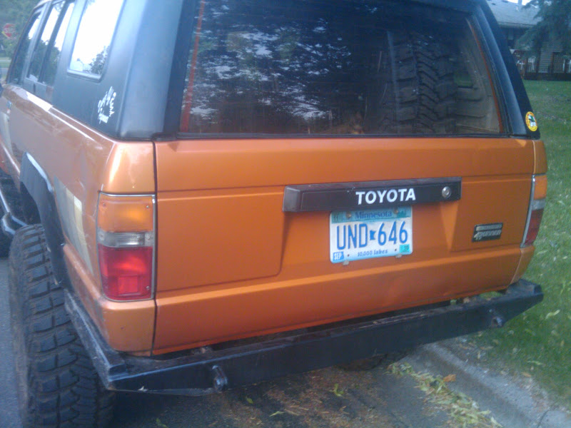

Painted the front fenders, and a new tail gate last weekend. The new paint is a little darker, I'll be repainting the entire truck once I am done patching up rust spots.
Cell phone shot of the new tail gate

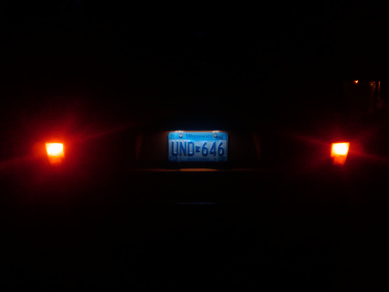

And last night I installed a LED light strip for a license plate light. Figured I have been pushing my luck, driving this thing around for over a year now without one.
