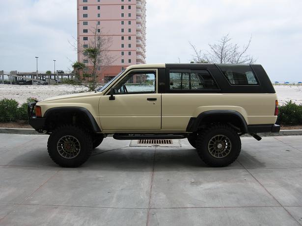

Guys, I'm a big fan of OME and have the them on my 85 4Runner. He said he wants minimal lift and I got 3+ inches. In fact, I had to install a drop draglink because the lift wouldn't work with my OEM draglink.
OME makes stock height kits for the 80 series landcruiser but not for the gen1 4Runners.
Here's a photo of OME's on an 85, heavy front and medium rear.
