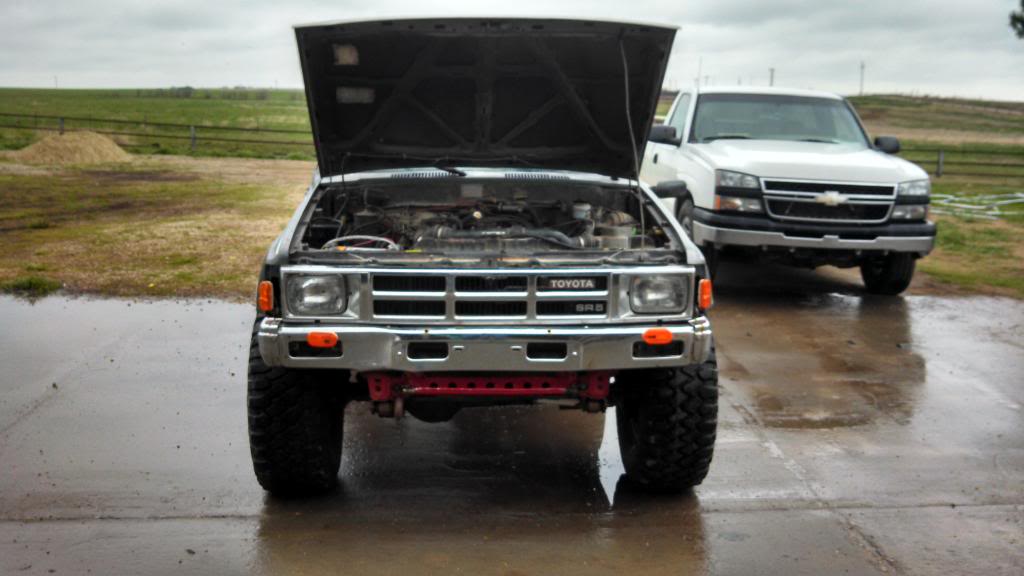

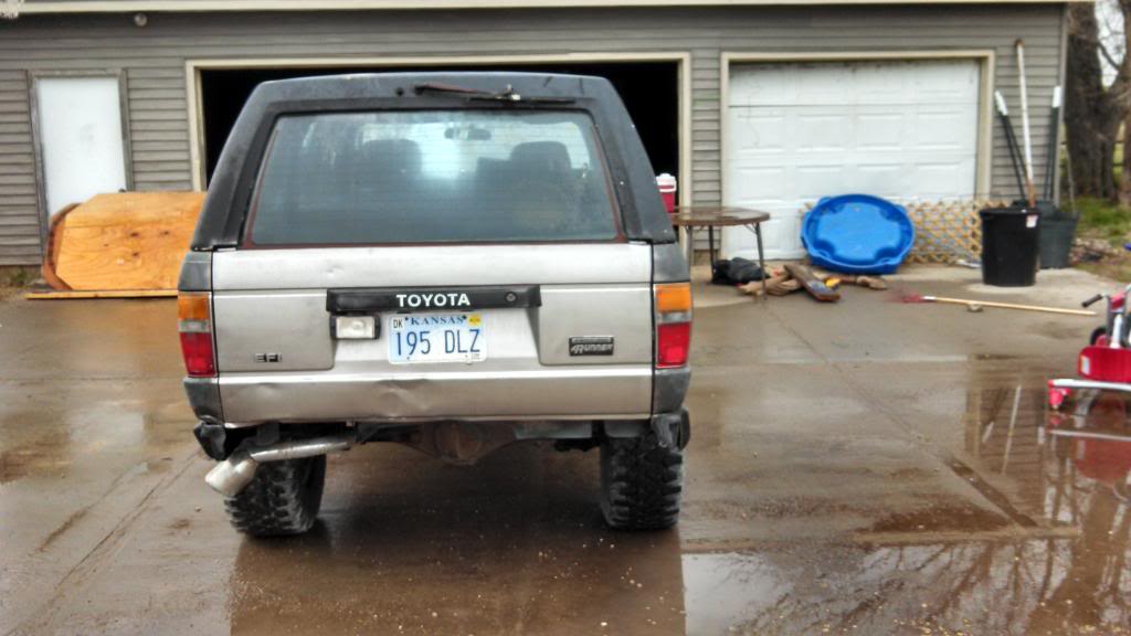

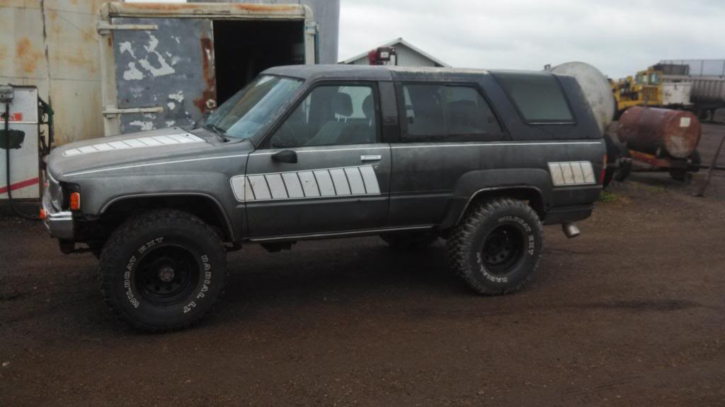

So I went to look at this thing yesterday, after calling the guy minutes after he posted the ad the day before. Was all set to buy it and he tells me someone else offered him 2k to hold it for him. Well the guy never showed and I ended up getting it today for the price of 1700. Which is really good if you ask me. As good or better condition than my 81, and also it's a 4runner.

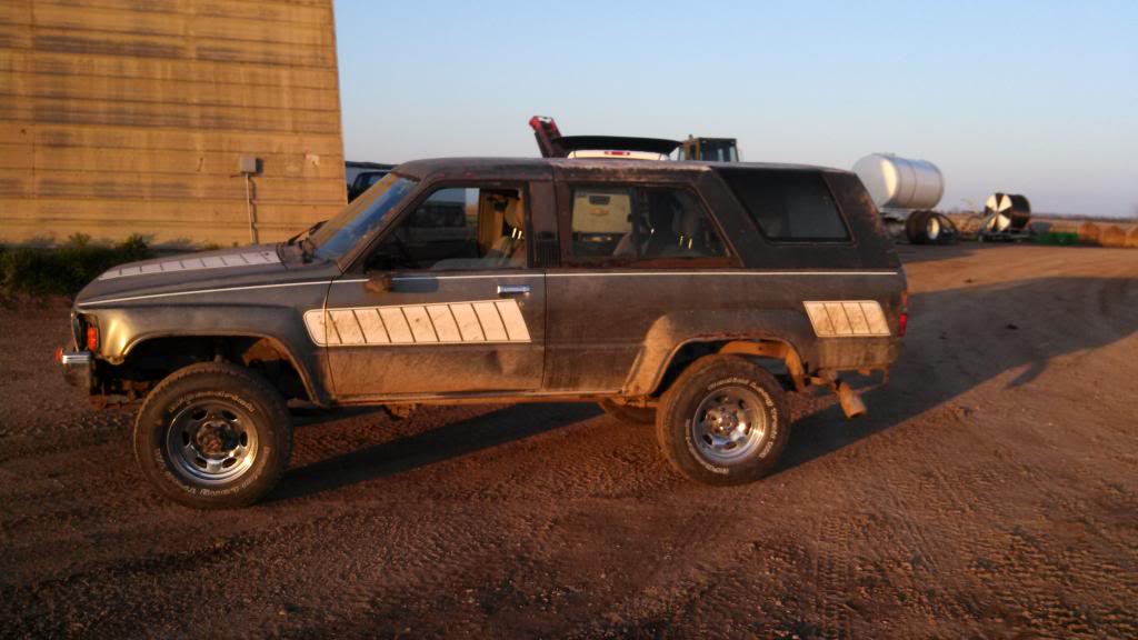

It's in OK condition. Runs and drives better than my 81, which is weird as there's only 2" of clearance between the bumpstops. I guess it must have better shocks or something.
It came with a good set of 33"s + spare, which is awesome since I have the tires off my 81 I can use as street tires.
Goal is to make it a reliable DD. Not doing any lifts or anything. Just going to fix a few rust spots on the body (frame is solid) and then drive the thing. Also going to try to find another engine to rebuild and swap eventually since this one is tired enough already. I could barely get it to do 65 lol.
In the meantime I'm going to rebuild the axles off my 81 so I can eventually swap it to this and rebuild the axles off this.

Those stripes are interesting--it's really close to the original SR5 stripes but not quite--looks like someone tried to replicate them.
I bet it would run on the highway a lot better with 28-29" tires. If the axle gears are stock, 33's really move you way out of the power band and increase the distance between each tranny gear. I'm impressed you got it to 65 on 33s if it has the stock 4.10s.

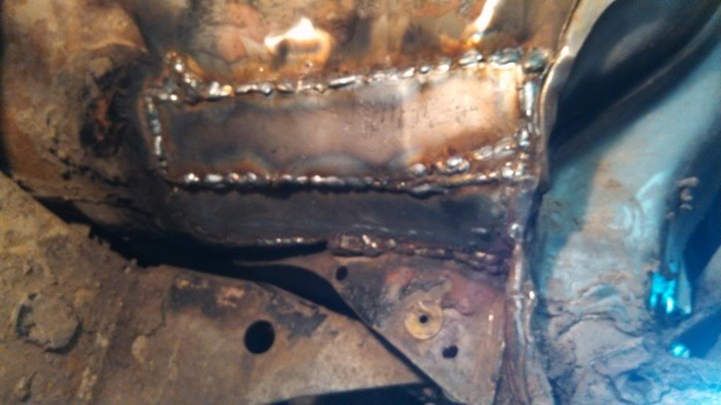

Patched up the front left floor board today. Still got like 4 holes on the drivers side I need to patch. Passenger side isn't nearly as bad, there's one in the front corner, but everywhere else is just fine. I painted it with some rustoleum and some duplicolor bedliner which probably won't last very long but it will get me by. At least I don't have to worry about mud getting flung into the cab through that hole.

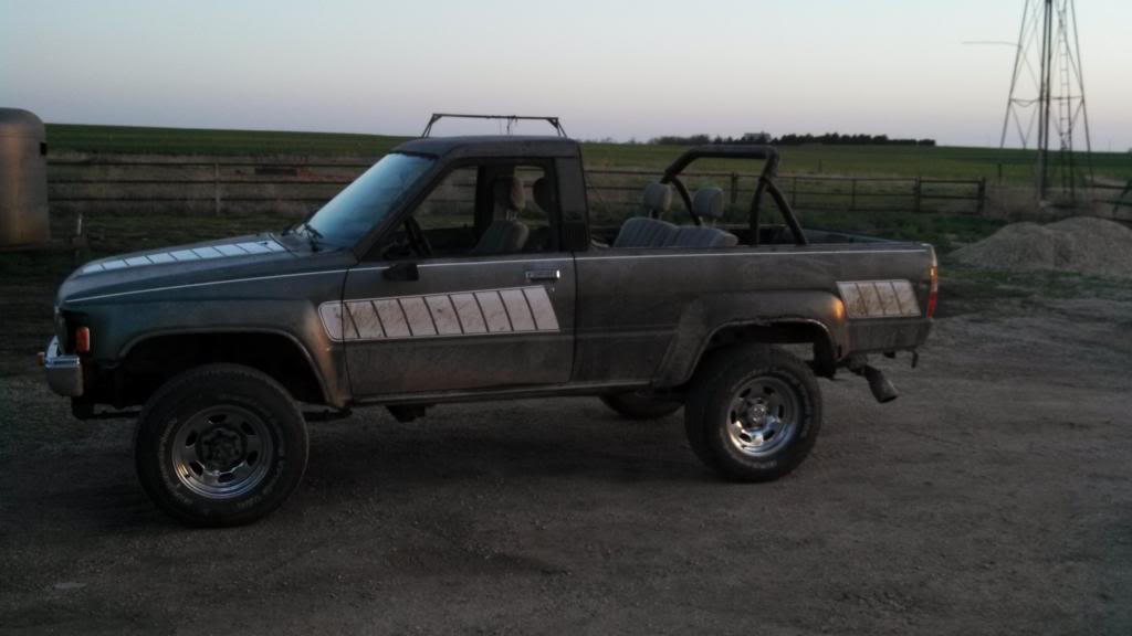

Also switched to the stock size tires with stock rims I got with my 81. I like the look better actually and it seems to have a bit more power. Pulled the top off to see what it looks like too.
I also flexed it out and heard this loud banging noise coming from the rear. It turns out my rear u-joint caught the tranny skid plate when the axle moved and it pulled it around. So I've got to unbolt the driveshaft tomorrow and bash it back in.

Logan, nice 85 , glad to see you have taken the top off I haven't had the courage to take mine off for some reason on my white 85 , I to have stripes very similar to yours and the same wheels , at first I didnt like the chrome steel stock wheels but they grew on me , now I think there cool.. I only have 1 1/2 clearance in front from bump stop to frame

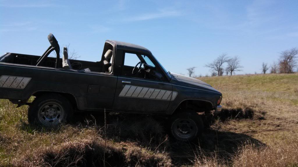

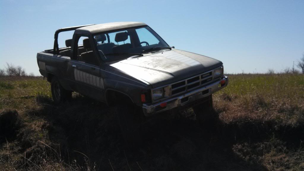

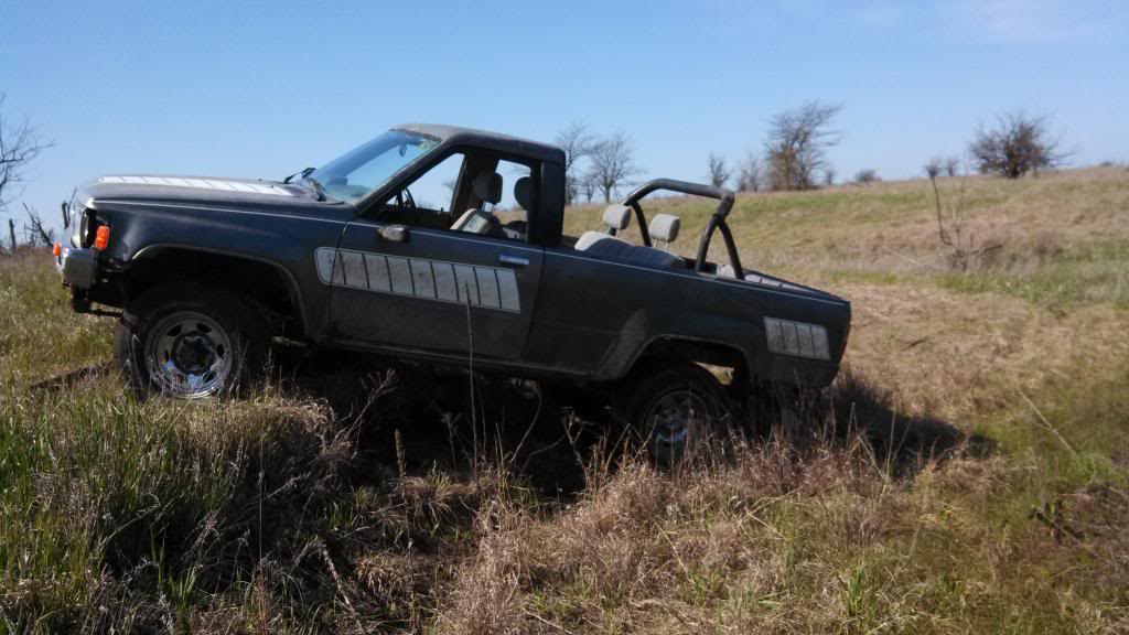

Picked up some more spray paint and bedliner and an oil pressure gauge today (where am I supposed to hook this up?) I drove out to a couple pastures and managed to get stuck once. I did get out of it though.
What do you guys think of hood mounted gauges? I have a hood off a second gen pickup I might experiment with.
