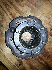

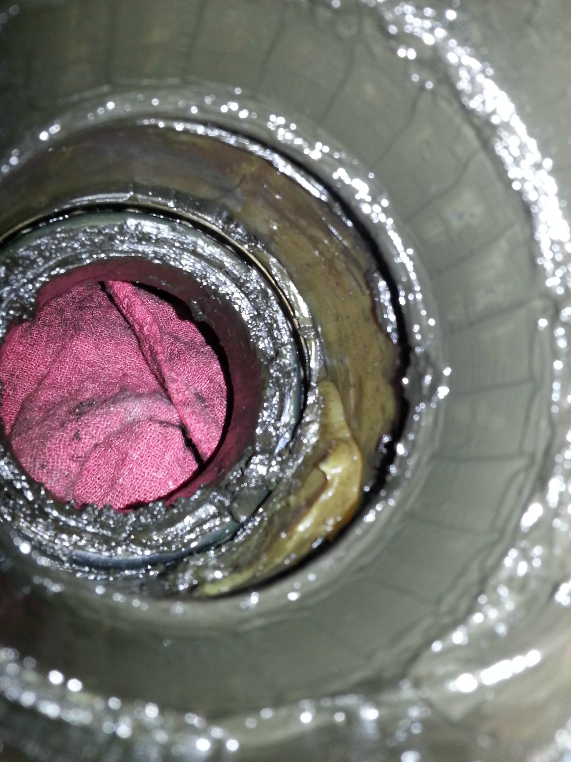

This seems fine but will not result in anything like what I'm seeing in the hub currently. There is a big band of relatively clean grease around the entire circumference of the hub body that is probably 3/4" or so deep(based on a little poking with a screwdriver)
Is the book procedure accurate or should I end up with something like I already have? Did somebody previous just do some serious overkill? The band of grease is so evenly applied that it makes me think it was factory, but then again maybe it was just piled in there and centrifugal force spread it out. I've also never packed bearings. Is the book procedure in the picture good or should I know more / do it differently?

The large amount of grease inside of the hub is overkill. When I was young and overly enthusiastic, I would load the hubs up with extra grease, but it performs no useful function, and makes cleanout a bigger pain the next time repacking needs to be done.
A thin wipe of new grease inside the hub cavity to avoid rusting is sufficient. There must, of course, be some grease at the bushings that carry the drive axle stub at either end of the the spindle itself, but you haven't been clear wether you are going in that deep.

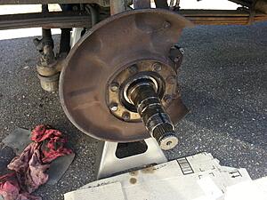

This is how far in I've gone:
You may want to consider replacing those springs in the near future. When they start to get weak like that they can fail under hard braking, even with the torque arm and the sway bar intact.

All gaskets in the hub are deemed non-reuseable by Toyota but lots of people re-use them. I always recommend replacements.
As stated above pack the bearings with grease correctly and thoroughly. Toyota actually specifys the center resesed cavity of the hub to be filled with grease all the way around. Caution:
Over greasing the hub can present incorrect bearing pre-load and hub tourqe.
