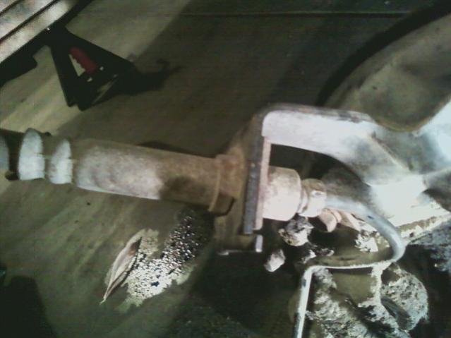

I'm trying to remove this brake line from this bracket. Any input on how to do this?

soak it with pb blaster take the small hard line off then loosen the nut on top ?

well I got the hard brake line off. I'm having a hard time remove the soft break line from the bracket. The nut on the top isn't wanting to turn, in fact it was bending the bracket. Anyone know how to do this? I think there is something else to it.

I am guessing it is seized up with rust. I had a soft line on a old Bronco II that wouldn't break loose. Heated it up with some Mapp gas, which ended up breaking the line but I got it out in the end. Went to the dealership and ordered up a new rubber hose.
So with that said, I would see if you can get a new hose quickly enough to finish the job, if not leave it be and paint it where it sits.

That nut on top is part of the soft line and is what you hold to remove the hard line. There is a clip underneath that nut which holds the end of the soft line to the bracket. Grab the clip with a pair of vice grips and pull it straight out.

Invest in a good set of channel locks as they work great on brake line nuts and won't round them off like a wrench will do. Snug up brake lines, don't over tighten them.
That connection/bracket has 2 clips holding the soft line in place. One that is bigger and looks rectangular with a U cut in it and a smaller C shaped clip.
Easiest thing to do is hit it with some PB Blaster etc and then pull the rect clip loose or tap it out with a long flathead screwdriver using the little lip on it.
You can then slide it out of the bracket and take off the C clip.
When working on brakes another helpful item is vacuum hose caps to cap your brake lines so you don't have to completely rebleed your brakes when done working on them.
