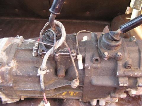

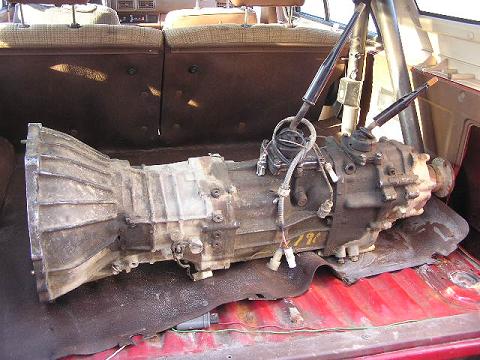

Hey guys, I just picked up a used Toyota 5 spd and transfer case for cheap. The guy wasn't sure what it came out of. I'm looking to do a swap into my 85 4runner, how do I find out if the tranny I bought is the right one? He thinks it came out of an 87 4runner but not 100% sure. I have pics if it helps. Thanks, Smoke

post up a pic and I will tell you.
EFI Trannys are Top shift cases
Carb and Turbo trannys are forward shift cases
If it came from an 87 4runner, its a Top Shift with 6 bolts holding down the actual trans shifter plate. (4 more hold down the tcase shifter)

Here are some pics. I appreciate the help.
84-88 EFI Top shift W56
