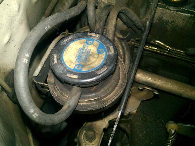

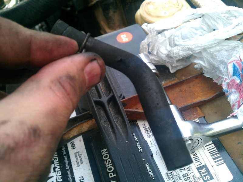

Found the culprit. Replaced this hose with a hole in it. It was easy to find because it had fallen of it had gotten so loose.
Hooked everything back up. Finally felt the power that a rebuilt transmission, new clutch, and a rebuilt carb should bring! It was a fun ride.
Can someone tell me what this part is [PICS]? The bad hose ran from the bottom of it. (I'm still very new and learning as I go)

EGR Modulator (has a filter in it if I recall correctly..)
Should show in the vacuum hose diagram sticker underneath your hood
