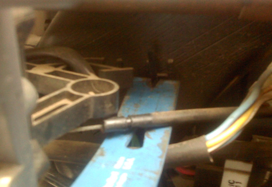

Now that I’ve scored a decent dash pad I have to get the rest of my heater work done. Right now I have a question about my Heater Control Unit (HCU) which has a problem. As I mentioned on my first post – I moved the lower lever to the “warm” setting and heard/felt a snap and heard a small piece fall on the floor. I haven’t found the piece. With the HCU face plate off and dash pad removed I was able to see where I believe the missing piece should be. From other posts I’ve read I think the missing piece is a clip that holds the outer cable in place so the inner portion of the cable can move to change the “cool/warm” setting. I’m not sure exactly what mechanism it moves but I see that the cable goes close to and under the heater core enclosure.
In the following posts are my pics of where the missing piece seems to have come from. You can see an indentation where the piece/clip that held the outer cable left a mark. The blue thing you see is a tool I placed there to give some contrast to the parts – it is not part of the truck.

This view is from above the HCU. The missing piece/clip I believe goes in/near the round hole just above the blue tool where black end of the cable is touching it.

This view is through the blank space to right of the HCU. You can see the indentation on the cable better in this pic and a side view of where I think it may have been attached to a clip of some sort.

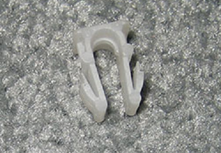

Now the questions are . . . Is it something I can purchase? If not is there a known substitute piece or a fix? A cheapo thing that comes to mind is using a couple zip ties in place of the MiA piece. Has anyone tried using a couple zip ties or something like that?

55931 CLAMP, HEATER CONTROL WIRE
55931-10010 for an 86.
They might come with the cables also,
55909 Cable Sub-Assy, Airmix Damper Control
55909-89110
Old Jan 13, 2017 | 05:01 PM

Thanks to Co_94_PU I think I've found a pic and a nearby source for the cable clamps.
I just want to verify with anyone here who has seen the part that this indeed is it.
Thank you.

Yeah clip looks about right
