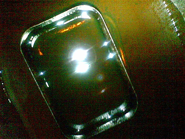

Well it looks like a slosh tank is EFI only... I went out to get pics of a parts truck I have, and it didnt have one... It was a carb truck.
THIS is a slosh tank... Notice the small tube on the side...

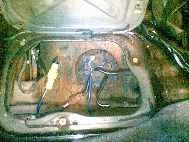

And THIS is how you get to it...

awesome, the tube is on the right,right?

When you get yours a part make sure the pan (slosh tank) hasn`t broken loose, if it has there is no way to fix it, you will need to replace the gas tank.

Originally Posted by GranVille-4crawler
right,right?
right
EDIT: looks like up at the top and around and out the right side.

Here's what you need to do:
Find a nice level spot. That's gonna be where it sits while you test it, inspect it and fix it.
You're not going to wanna do this with much more gas in the tank than in my pics. So don't fill up right before you do this.
EDIT: The 1st thing you're gonna wanna do is test it. Let it run till it stalls out, then you're gonna wanna inspect it. Just flip the seat up and go abouts removing the fuel pump.
You will not want the battery connected...
There are two lines as seen in my pic, on the right as you're looking at it. There are two so a good way of not mixing the two up is to slip the clamp of one line off and onto the metal part of pump access. The other clamp, slide it further on the hose. So you can't mix them up... no marking the hoses needed.
Now you pull the FP out... But it will be tight... Very tight.
Being careful of the fuel line and FP power supply, pull the FP all the way out.
Now you can see what you're dealing with and if the fuel level OUTSIDE the slosh is higher than INSIDE.
Now you can go abouts McGuvering how to flush it.
I had about as much fuel in mine as the pics above. I ran a piece of hard metal fuel line about a foot long with about a 3" L at the bottom.
I had an air line, and blow gun and made a piece of rubber line connect the two.
Put L in the tube and blew.
Assuming the level isnt so high you lose sight of the tube, don't worry. A little agitation of some gas getting in behind the air source will prolly only help things.
Mine was tarred and laqured up... I had to work it a while but I got it...
