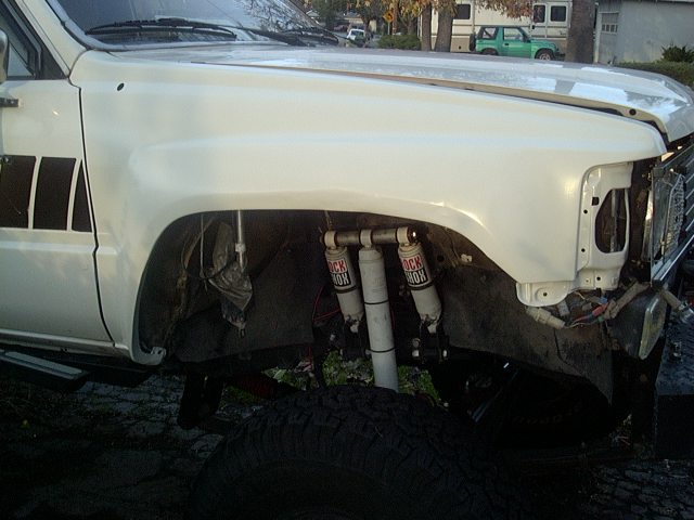

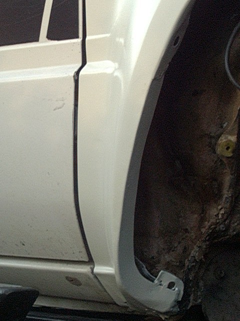

As mentioned above, hammer the standing seam behind the plastic wheel well liner flat (2-1/2lb. sledge hammer is a good tool to use). Then trim back the wheel well liner if needed:
Then if you need to cut the actual fenders, this is what I fid:
But the real answer is to move the front axle forward:
33x9.50s w/ 3.5" lift, stock axle location:
33x15.50s, ~3.5" lift, axle 2" forward:

As noted in my post, initially moved the axle forward via re-drilling the perch (3/4"). Later, did the rear-front swap (gives 2" forward move):
- http://www.4crawler.com/4x4/4R_suspe...II.shtml#Front
Then later made a new front spring hanger with a 3/4" forward hanger bolt hole location:
- http://www.4crawler.com/4x4/CheapTri...ringHangerDrop
For a total of 2-3/4" forward axle move.
