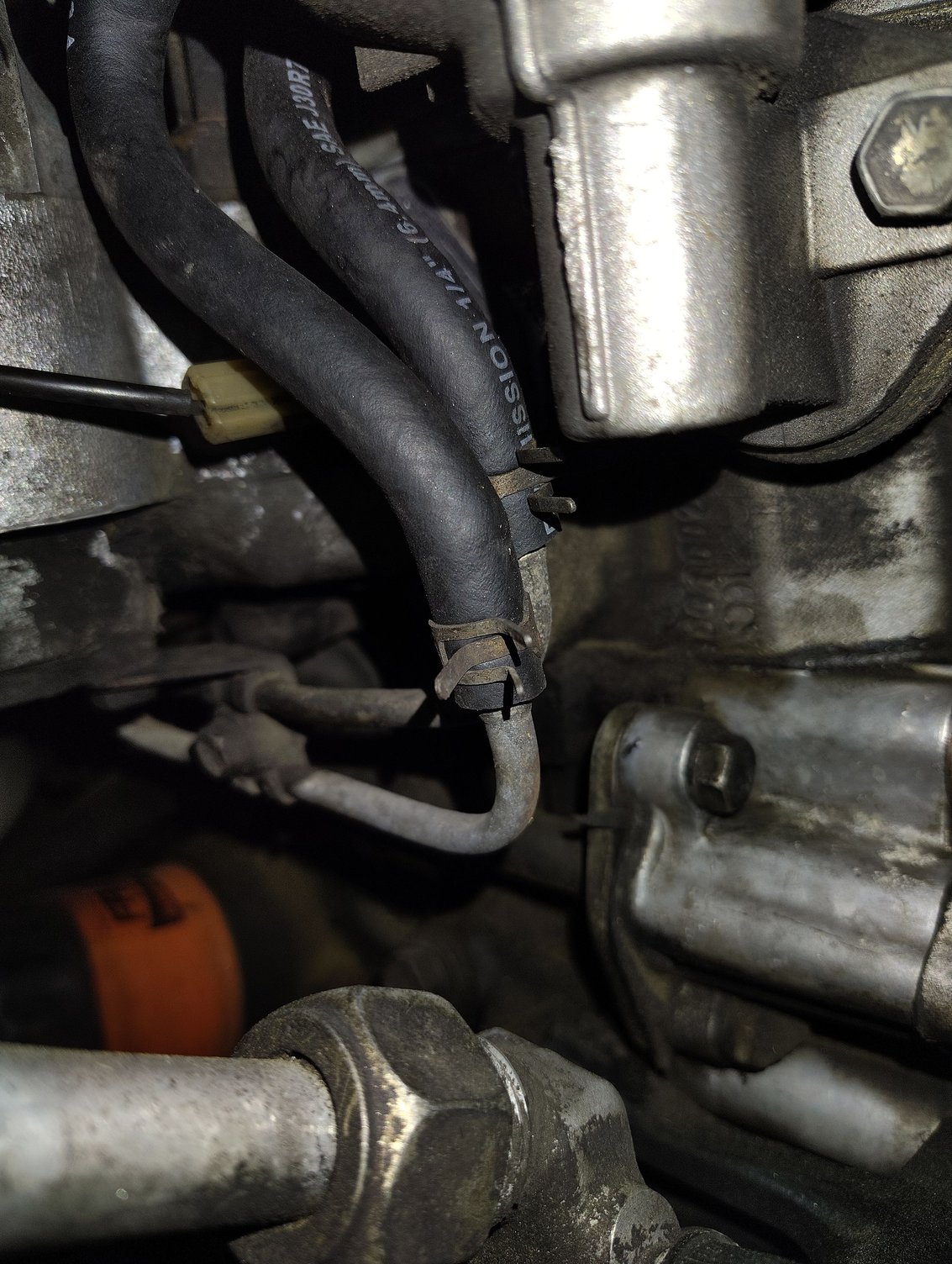

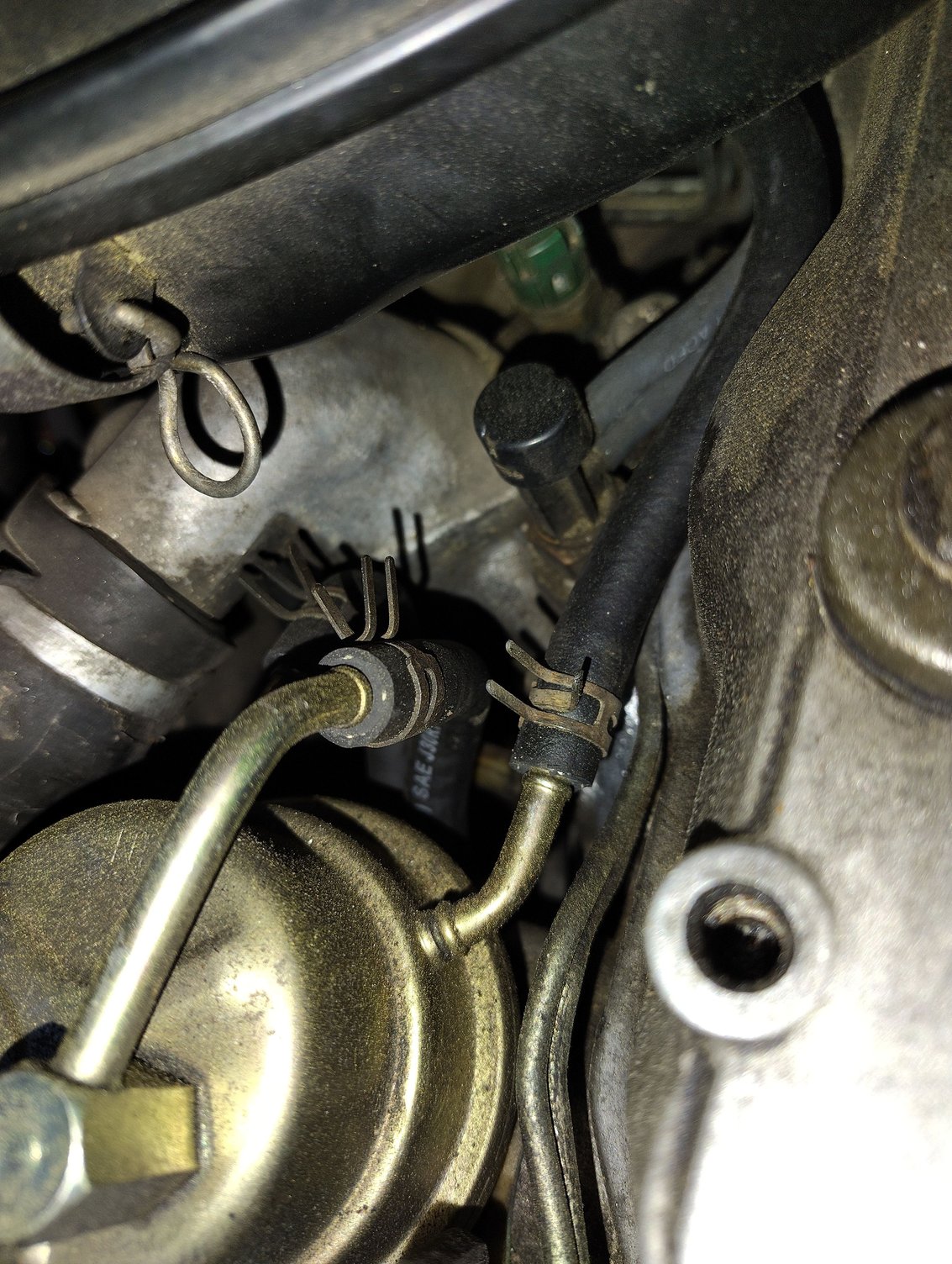

Here's pics of my fuel lines from pump.

Do you have pictures of the fuel lines?

That's what I wanted to make sure. Thank you!
I'll get pics soon. Pretty sure that they were reversed. I changed them already. I got suspicious when I unscrewed the fuel cap and it had air pressure on it from just turning the engine over several times. The vent may also be clogged. I believe I have a cheap/weak pump also. Got to dig into it, just have a LOT of things going on....
