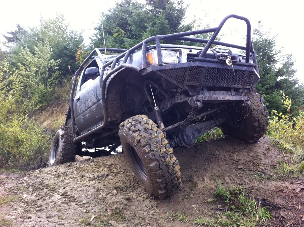

Is your shocks limiting your drop, or the spring? Drop on one side will give more up travel on the opposing side.

im not too sure. when i lift either front wheel, i am bottoming the shock ( i think i show about 2.5" of shock at ride height) on a 12" bilstein 5125. well, the pitman/tre issue prevents that on one side, but its like 1/2" tops. the opposite side is showing 10+" or better. i know these shocks don't measure an exact 12" but damn close. so im not sure then if its the shocks or springs.
