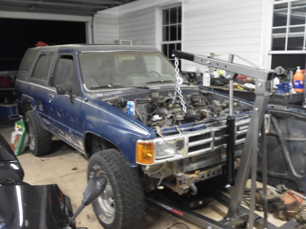

almost time to pick back up on this project, had some free time so I got the motor out. Plan on tearing it down to see if I can hone it and put a std. bore rebuild kit in it or if I will have to get it machined.

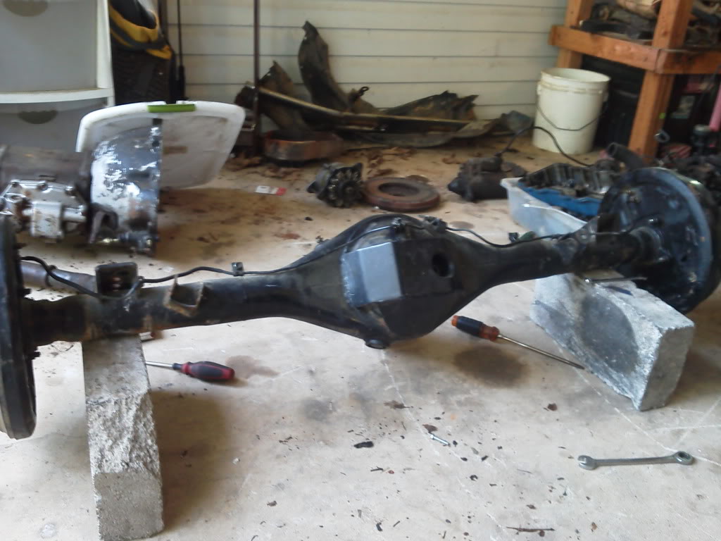

Found some gears... nothing much just going from 4:10 to 4:38's should help some. Plus I put them in this sexy 58" axle tube I had laying around

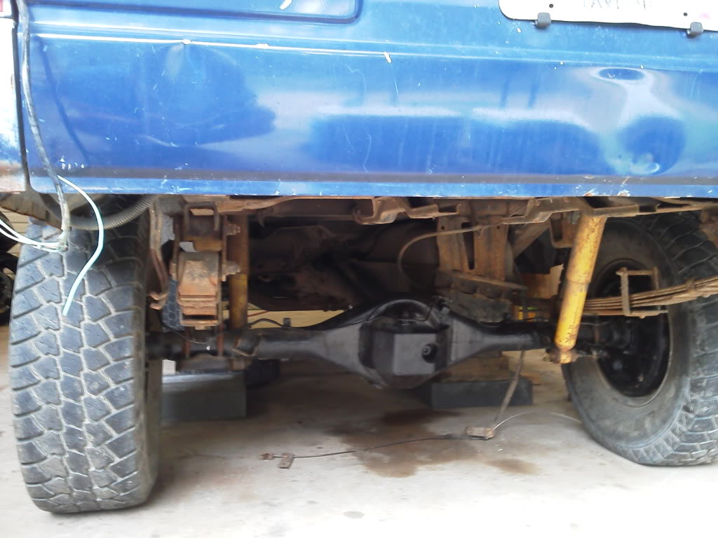

Swapping the front gears a caliper and a few other parts. I didn't swap the whole axle because it was an earlier tube style axle.

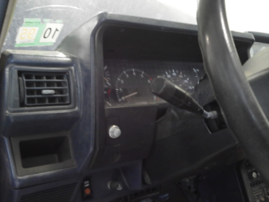

Also had to hook up a push to start as my ignition took a carp on me. I picked up a 2 pin momentary switch ran one wire to the solenoid on the starter and one wire to the positive side on the battery. Turn ignition to on push the button vroom.

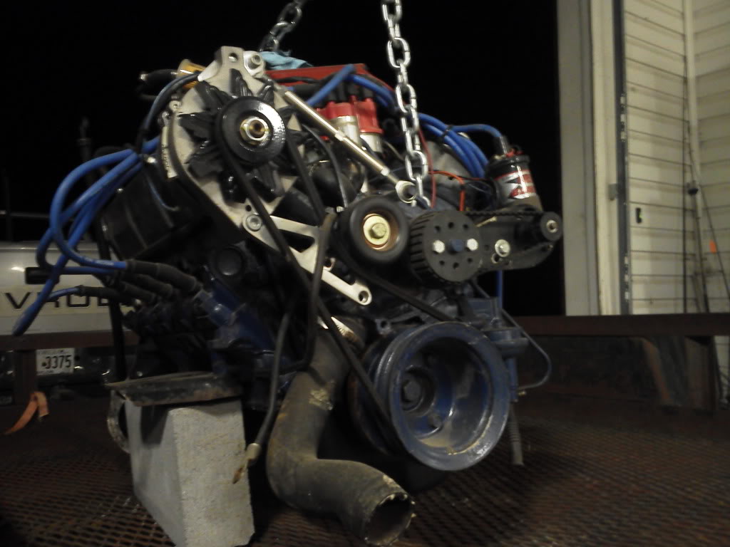

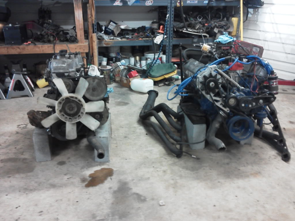

Blew the 22 bought a 302 that is all

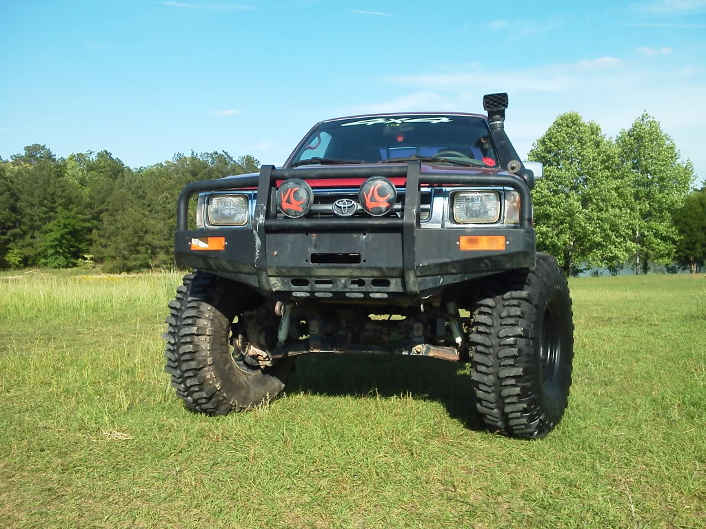

New plan. Go stupid with the runner Rob the tires from my pickup and street it again and build the 4runner to beat on.

4runner to fordrunner lol... dizzy in the front and the weight put me on the 302. Its carbed, msd ignition, mechanical fuel pump, and it has a c4 behind it. should work out simple. Looking at nwor mounts and tcase adapter. Running the rad battery and fuel cell in the bed. Also doing a body lift to help with clearance.
