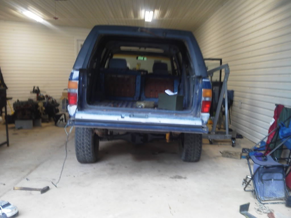

Stage 1 strip truck and prep. Engine is out. Still need to pull trans tcase and drive shafts. Ive removed clutch slave master pedal etc... all factory ac components, all vacuum lines, heater hoses, all unnecessay wiring etc. Only things I plan on leaving are power steering res. Brake booster wiper motor wires associated with running lights.

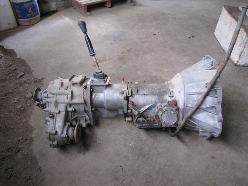

Pic of a c4, adapter, and toy case. Rumor has it all my drive shafts will work with this setup.

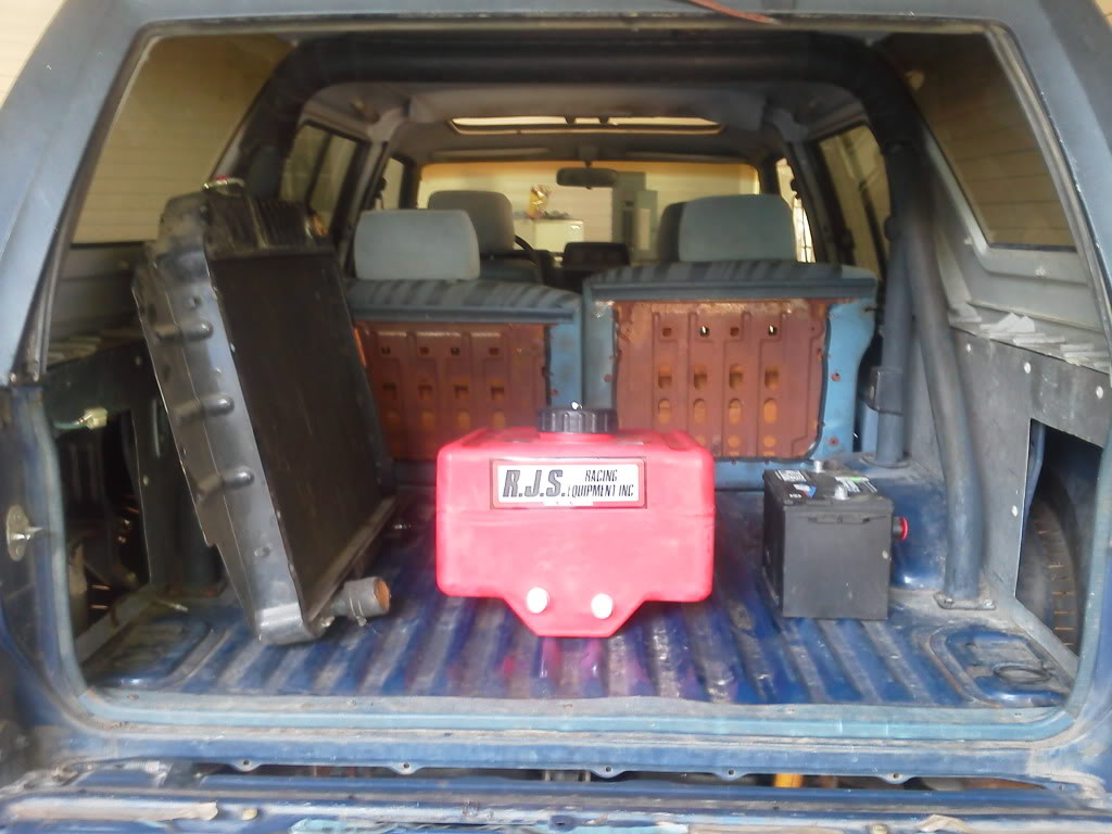

It's not necessary but I'm looking at running my battery fuel cell and radiator in the back to help balance the vehicle.

Found a radiator: bone yard special out of a 92 Ford van $40. Guy there said he had a yota with a 383 with that same radiator and had a 18" thunderbird fan and that setup worked great. So now ive got to find a tbird fan.

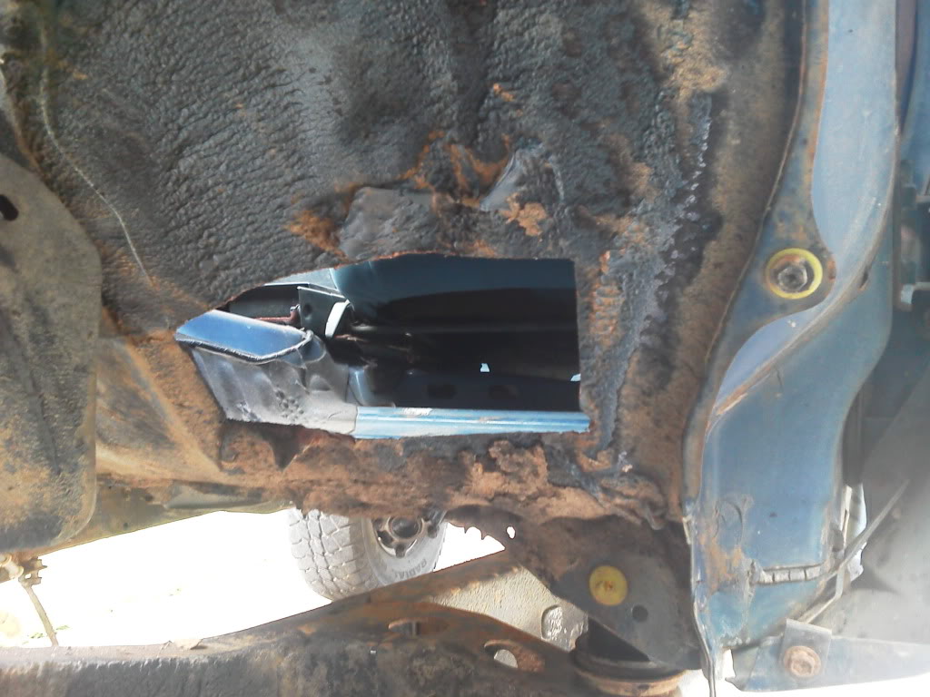

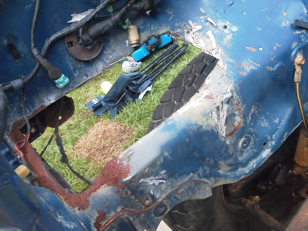

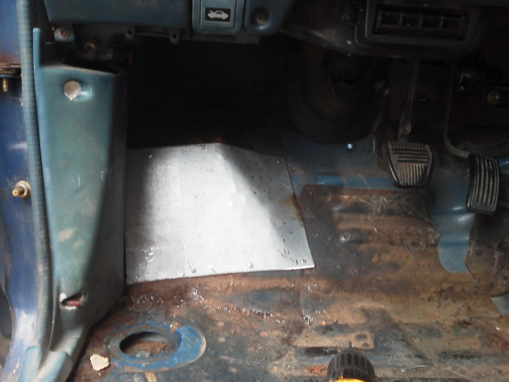

Cut out some rust today

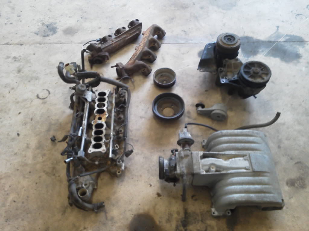

Gotta love friends, buddy of mine fixed me up with most of what I needed for the serp. Set up. Ps pump, ac compressor and mount, (onboard air), crank pulley, water pump pulley. I just need the mount for my alternator and the pulley for my alternator. He also gave me a pair of manifolds, intake and plenum from an efi set up if I wanted to convert later.

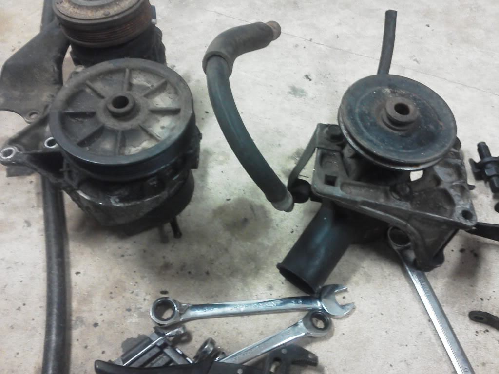

Fml serp set up wont work. I have the v belt set up on the motor now with a standard rotation pump. Serp set up uses a reverse rotation pump which I have but the the reverse pump is not compatible with a mechanical fuel pump. so I am looking at mounting either the Toyota ps pump or the Ford ps pump only. Whichever is easier.
Alternator is set up with a march belt adapter water pump is electric I just have to figure out the ps.thought Serp was the easy way but was wrong.

Found an old ps pump with a vbelt pulley swapped it over to the pump I had.

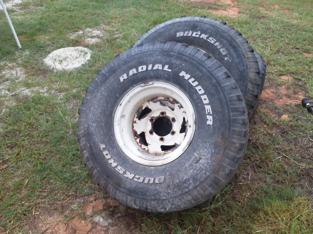

Also had these jewels gifted to me. Time to break out the sand blaster.

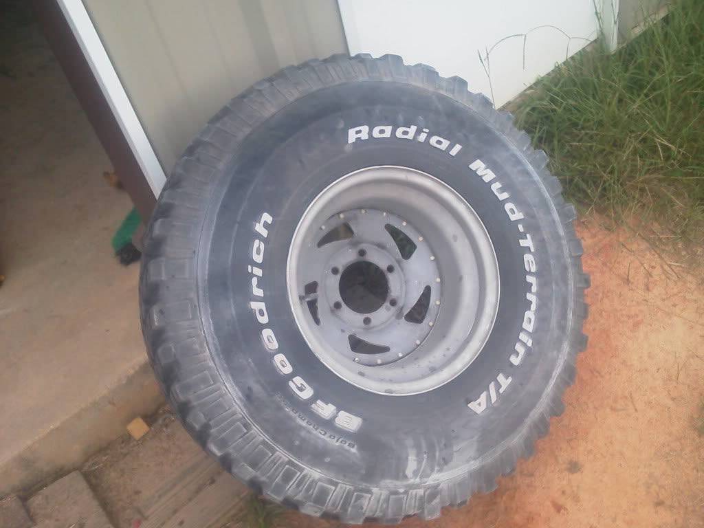

Wheels came out nice. Tires need a good cleaning now.

Looking good! Did you take the tires off to blast them? I have the blaster and the my wheels need it too, but I was thinking I'd have to take the tires off. It doesn't look like you did so.
