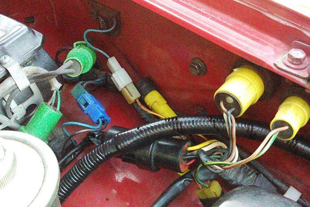

so far, what has been done: the plug black lower plug as posted in pic below was welded together and overheated so it was opened, cleaned and otherwise looked good, a wire bypass was installed

I would get rid of that cheese but connector. and probably that damaged connector for the alternator to start. also, start looking at the ground and fusible link connections near the battery.

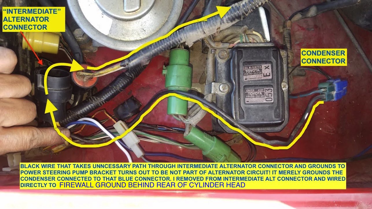

Furthermore, that round intermediate connector does not add value to the truck- just clutters it up. I wired my alternator wires "S" (white), "IG" (red) and "L" (yellow) as directly as possible.
Only the white, red and yellow wire on that connector belong to charing circuit. The black wire is ground for ignitor noise suppressor capacitor. Toyota must have put it on that connector to make assembly more efficient, not for us users.
Black wire does not belong to charging circuit

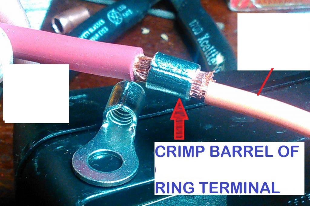

Just bypass that connector by crimping wires. Use "Parallel Crimps" not "butt-connectors". Parallel connectors put ends of both wires into direct contact with each other. Current does not have to flow through flimsy metal of the butt-connector.
I made my own parallel crimp connector
