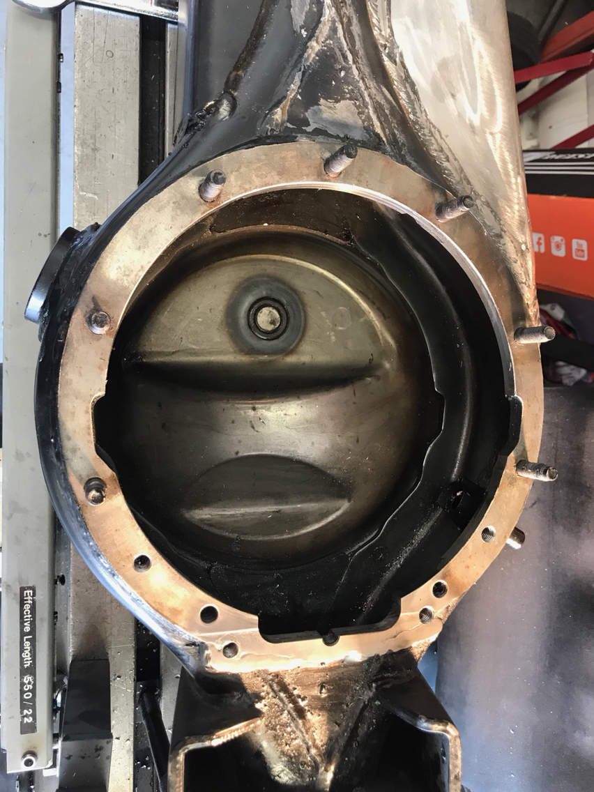

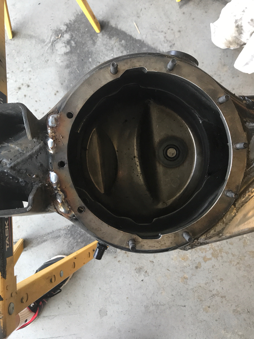

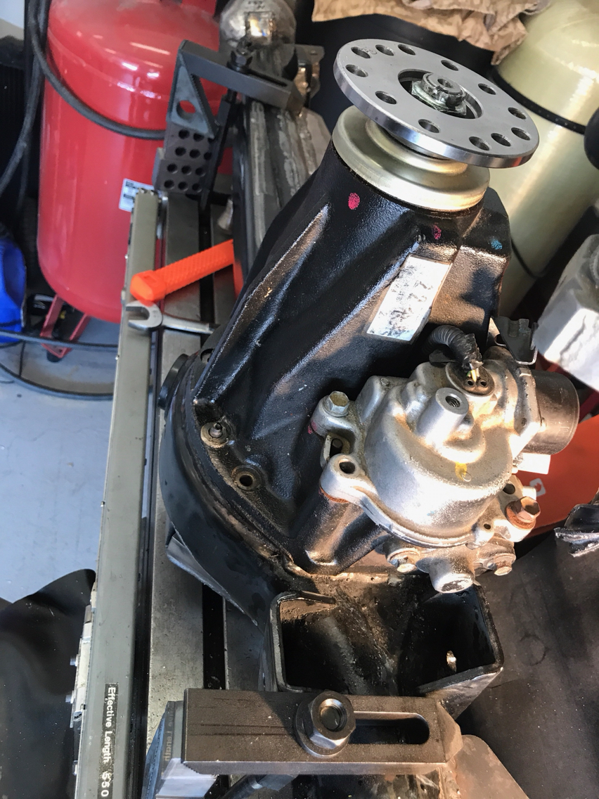

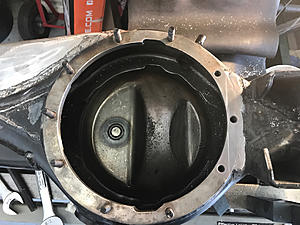

Just milled out my 85 axle housing today to fit an elocker diff for my sas.
Attached Thumbnails E locker up front in my 85 Xtra-Cab-photo761.jpg   E locker up front in my 85 Xtra-Cab-photo866.jpg   E locker up front in my 85 Xtra-Cab-photo518.jpg   E locker up front in my 85 Xtra-Cab-photo984.jpg
That's pretty sweet Dude, SAS with an E locker is badass. 😎
