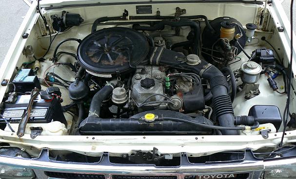

I recently did this to my 85 22r 2wd pickup mutant flatbed. Here are some before and after pics. Once I got things dialed in, which was about a week ago, its run reeal nice. Was having problems with dieseling at first. Advanced the timing a bit, leaned out the weber a little more and turned down the fuel pressure reg. Running better than ever... not sure about longevity though. Bad thing not to be sure about.
