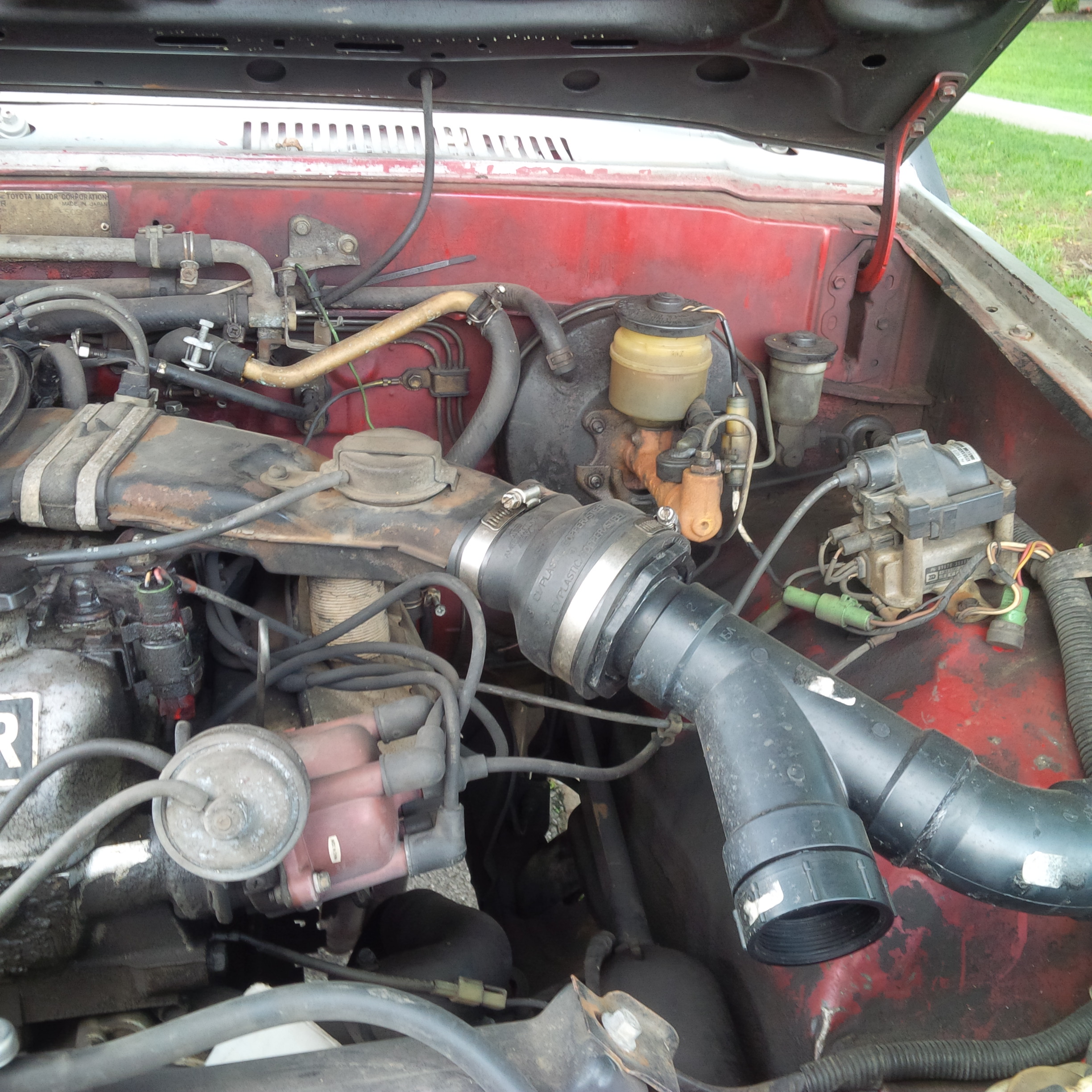

My 84 toyota pickup with 82 22r motor
Lowes parts list
2x3 rubber adapter
3x2 ABS DWV adapter
2" Y-elbow
Threaded female 2" threaded adapter
2" threaded plug
2" street 45 x3
2" street 22.5 x2
2" 22.5 x1
2" 45 x1
6' ABS DWV pipe

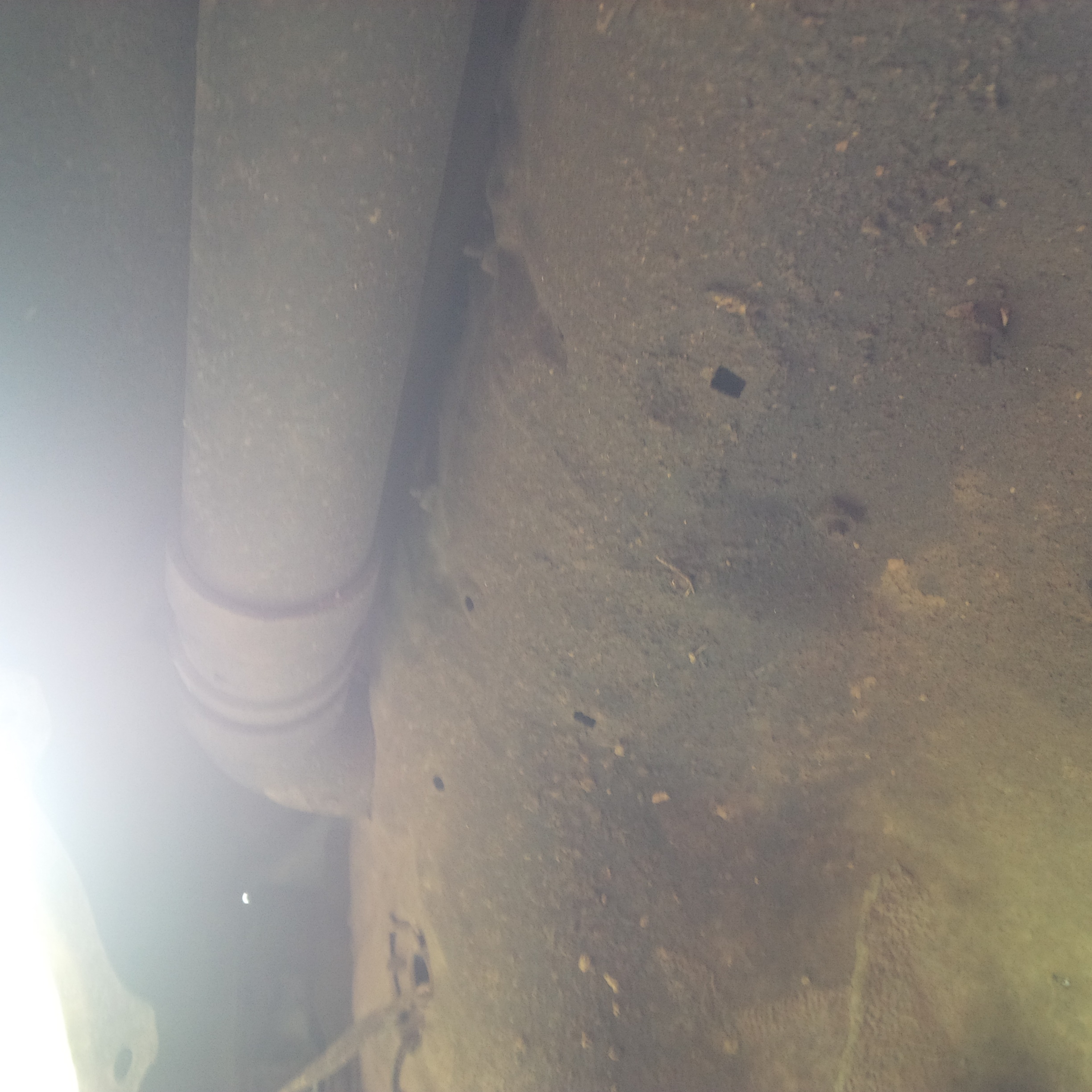

2" hole saw worked good for a nice clean hole

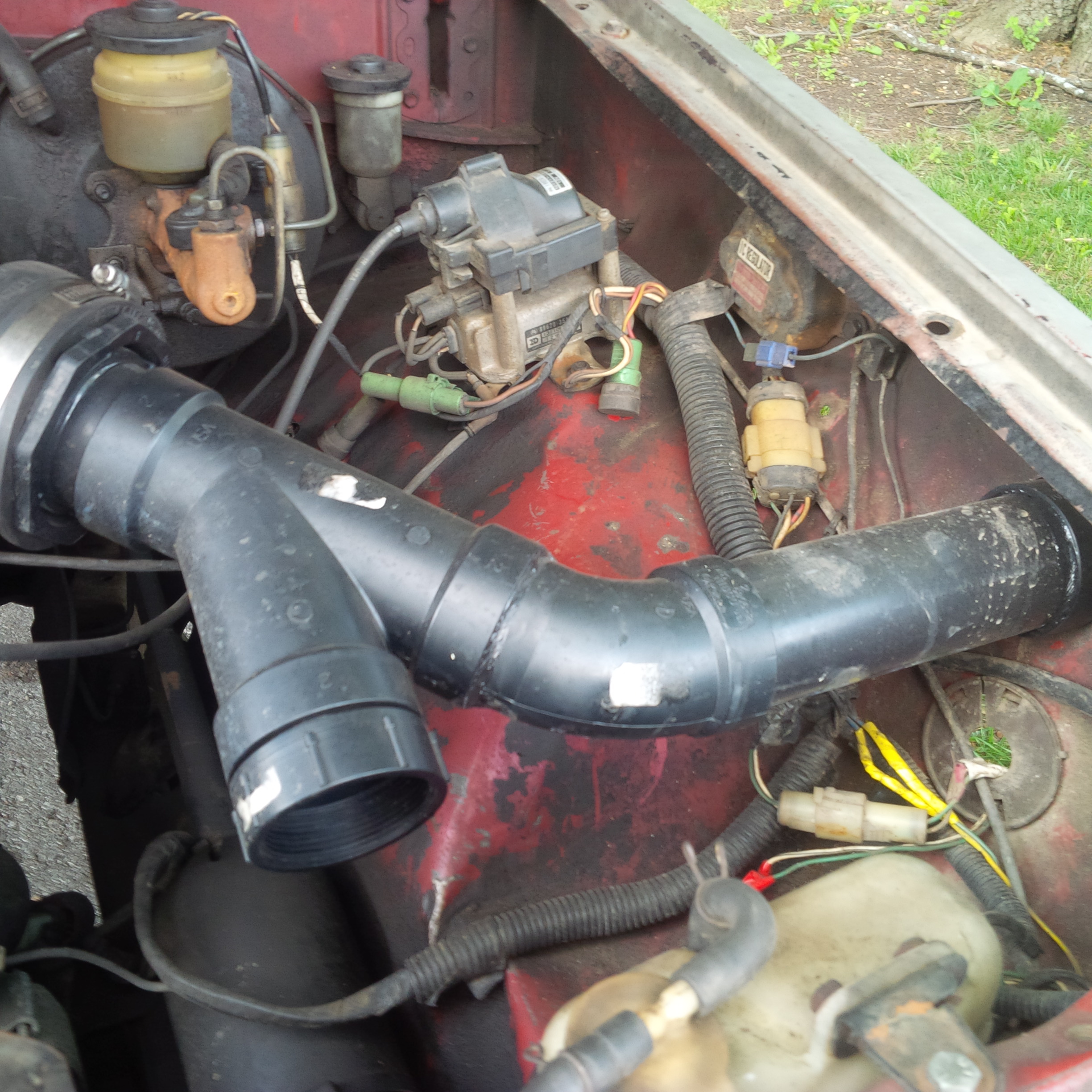

Its a little dark but its run under the fender instead of on top like most the ones I've seen running in the hundreds
I know my second hole isnt quite as pretty... grinders dont make them as nice... An lack on bondo...
Good enough....

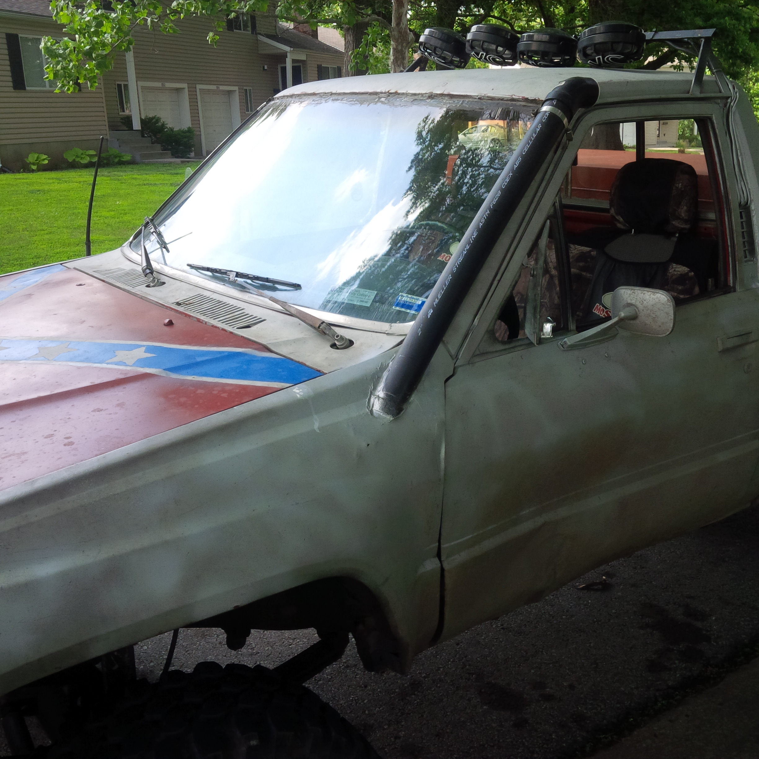

Side note... Home depot stopped carrying the ABS DWV pipe (which is the black pvc)
Apparently alot of places are starting too... Lowes in my area has not
Snorkel seems to work fine... I havent gone slow through any water. But had it coming over my hood in small crossings... no problems...
I can hear it sucking area as I whirl down the highway...
