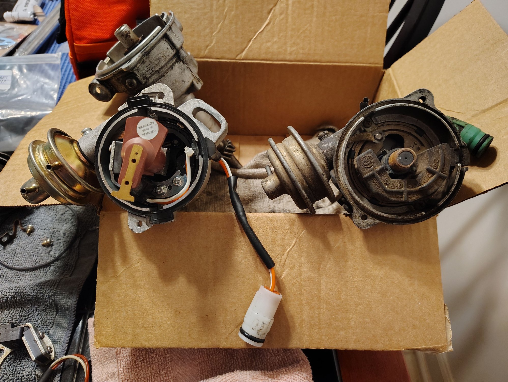

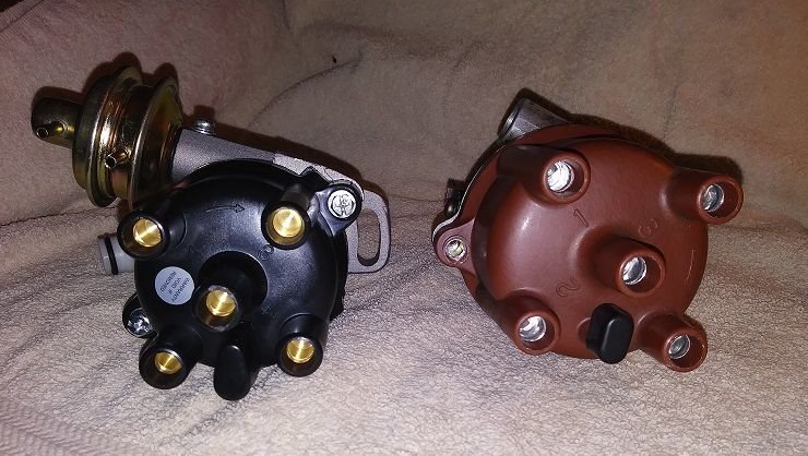

I've been meaning to post about an issue I've had this year with 22R distributors. It's a long one. Bottom line is I've bought 4 distributors, all of them are not the same as OEM. The vacuum advance ports point in the opposite direction, the caps and rotors are smaller, and the connector wire is routed differently. The first was CarQuest branded I bought from RockAuto in January. I took it to an Advance that use to be CarQuest shop before the buy out. The folks there know me by name. They could not tell me what cap and rotor to order when it came time for a tune up. I missed my return window with RockAuto. I ended up needing to use it a few months ago. It failed in 2 weeks (a spring broke) and I think it chewed up my distributor drive gear. When I first installed it, it took too much force to install it. Once I replaced my distributor drive gear, there was no getting that distributor installed.
So I ordered a Cardone off RockAuto. It matched the CarQuest branded one. Sent it back. Had to eat the shipping charge. Ordered a WEI from OReilly. It matched the CarQuest and Cardone branded ones. Returned the OReilly one. I then ordered one off Amazon where the pics showed the vacuum ports pointing in the right direction. It too matched the others, ports point opposite direction, cap/rotor smaller, and connector routed different.
The only thing I can figure is all these brands are sourcing from the same manufacturer. So either the aftermarket ones that do match OEM are not available and this smaller one is being substituted, or the makers database on the design is fxxked.
I'm currently using an old original Toyota distributor. I've been in touch with a guy about rebuilding the old Toyota 22R distributors.
fishdan does yours look like the one on the left in this pic?

That is definitely the one I have.
Mine has worked fine but knowing this I will start looking for a replacement.
THANK YOU for this information.
