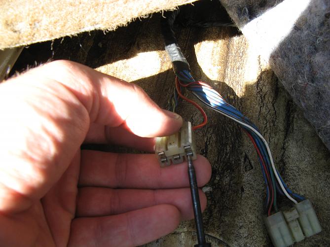

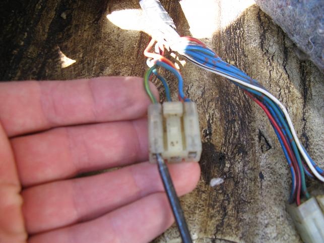

So, after trying several different things Im still at wits end with my 85 4runner back window. Here's my newest info. To start: 4Crawler, I did check for the wiring under the carpet and it was present. Thanks for the advice. I pulled the switch out that the present owner had disconnected and left in the glove box and plugged it in under the carpet. No Luck! So, I then tried a switch from a doner rig. No Luck! I then plugged in the second relay module from the donor rig thinking maybe that was the problem. No Luck! I then moved back to the switch where it plugs in under the carpet. I figued that if it wouldn't work plugged into the harness that I would at least find out what pins held what charges at different up/down and neutral settings on the swith and just hard wire it to the rear window motor. I know the motor is good because I tested it with a battery. So, I figured the best way to start testing was with a test light. I figued one of the pins had to hold a constant + charge from the ignition, and one had to be grounded - (I don't know any of this to be fact, I just assumed). So I grounded the test light and this is what I found when I started testing. Of the five pins, when the tester touched the bottom right (red wire) the window rolled down. WTF! Then when the tester touched the top left (green and yellow wire) the window rolled up. WTF! Somebody please tell me where they think my problem might be! Thanks for all of your input. Also the bolt that allows the window to roll up and down when the top is off is in place.

You'll find most of the switches make connections to ground:
- http://www.4crawler.com/4x4/CheapTri...leshootingTips
