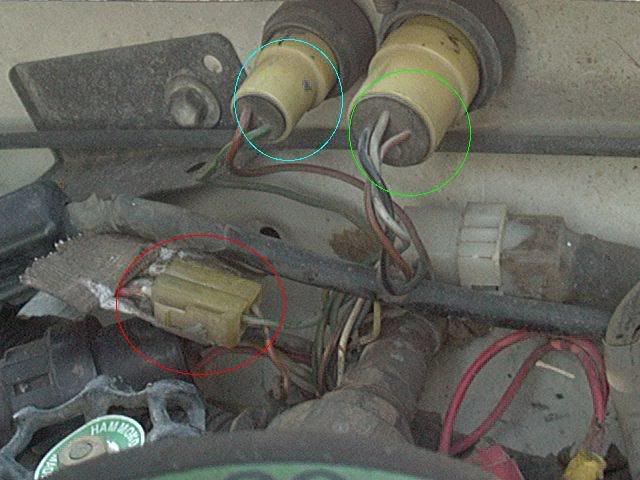

thanx for the link. Tha will be a big help. Anyone happen to have a pic of this terminal? I have 4 yellow plug all right next to each other? which one?

The one circled in blue, take a paper clip and connect the two termianls, and switch ignition on and count the blinks.

Thanks, I found it...funny though. It only blinked once meaning all is well...... I swear my truck really did become a women when I named it sarah. She pms's like none other pretty much once a month. Hopefully all is well, otherwise going to mexico this weekend could get interesting : )
