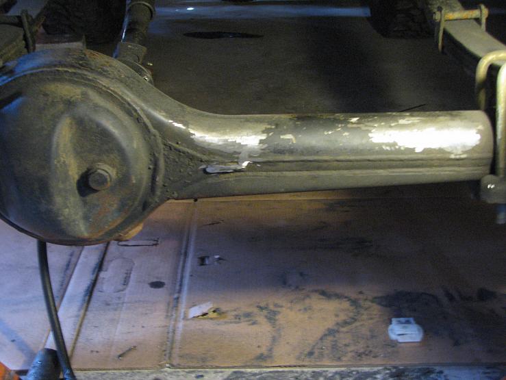

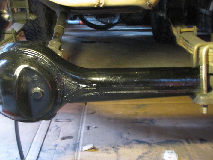

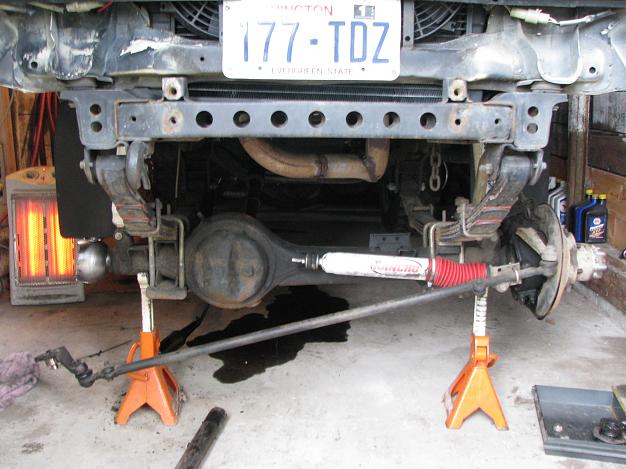

finally got some time in the shop. I started the hysteer process while i wait for trail gear to send the goods. I removed the stock stabilizer bracket and third link. looks alot cleaner down there!!!!!!

looks good, you are gonna love the difference between the push-pull and the IFS steering box.
what front DS are you using?

my tg parts should be here 2morrow. i need to find a steering box quick. do i have to have a steering stabilizer or should i be fine without it?

Steering stabilizer is usually personal preference. I wouldnt leave home without mine.

they always say if you plan on driving over 40 or someting, some guys dont run them someguys stand by them I run with one. you'll be fine without one though

It looks like Toyota just dropped it off at your shop. That's a great job! You'll be ready for anything with that setup. Good luck with your high steer install.

i have heard of Reiter pit. is that near you guys. i am going to run a stabilizer, i removed the bracket from the axle very clean so i can reuse it up top on the frame. Walker valley in skagit is pretty sick!

Just a suggestion when it comes time to mount your IFS box. Mount that puppy as far forward as you can. I run RUF and I had to cut out my radiator support to slam the box forward. It keeps the drag link and tie rod from rubbing. Have fun!
