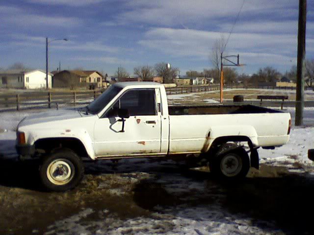

Looking to see if anyone's running these stock wheels and what tire size they will handle?

Can we get a better pic and are you sure those are "stock" wheels?

15x6 or 15x7, no wider than A 10.5.
Tires in pic look like maybe a 9.5. Hard to tell on my phone..
A 33x9.50 would lOok good on that truck(maybe that is what they are )

these

My truck came with those steel wheels stock. Theyre 15x6, thats narrower than the stock 15x7 sr5 alloys. I thought of mounting my old 32x11.5 on them but after a closer look they probably will rub on the upper control arms. The backspacing is like 4.75. 33x10.5 would most likely work thoug.

A 33x9.50 would lOok good on that truck(maybe that is what they are )[/quote]
those tires are 235/75/15 mudders, they guy sold the truck and now has 33s and soft 8s he lives in the same town as me
