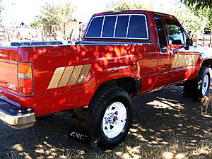

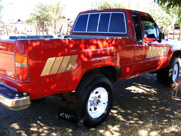

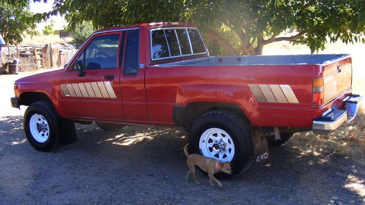

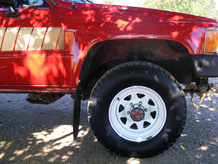

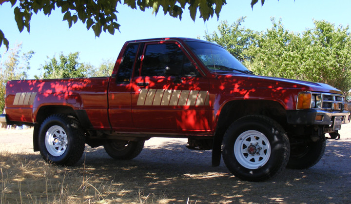

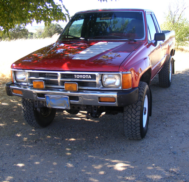

So I adjusted my timing today from 5 degrees jumped to around 7-8 degrees jumped and what do you know, it idles and runs a little smoother, but still bogs...just not as long I guess lol........ when it bogs and rpms drop down to under 1k it just doesn't stay there as long and recovers alot faster than before... does this point to anything guys?
Also I finally got some pics of my rig that I know you guys would appreciate to see! A bit rough around the edges if you have a good eye but who's isn't?
The puny 30x9.50 Remington 'Wide Brutes' and the cool retro wagon wheels the previous owner put on. 33s are in my future for sure.
Sorry for no flex pics haha.
