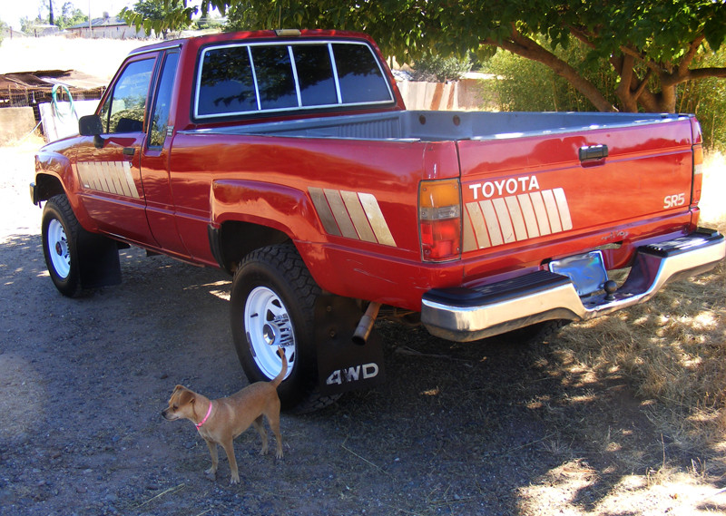

1985 Toyota Pickup Xtra Cab SR5 4x4
22R-E @ 148k miles
A/C, Power steering, etc..
A340F Automatic Transmission (19 bolts)
Just bought last month...So my automatic transmission skips second gear about 80% of the time and goes straight to third gear. It seems to get really bad when taking turns.. shifts into first and then immediately to third gear and really bogs down. It also won't kickdown even when playing with the gas pedal at WOT and pumping it. I have to manually downshift it to 2nd gear when I go up hills or when it bogs down around town. I've read all over the forums and searched all over the place including the AW4 transmission found in Jeeps which are the same.
My searches turned up into it most likely being the solenoids coming stuck so I went ahead and replaced all three of them today. Found no abnormal amount of shavings, filter looked fine, and bright red and smelly as new. After the test drive, it was still bogging down and skipping second or shifting way to early which of course about pissed me off considering the prices of solenoids. I've no clue what it could be now other than TPS or just rebuilding the whole dam tranny.
