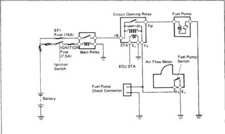

My 85 22RE fuel pump does not come on until you turn the key to start. The fuel pump is turned on by the air flow meter. It has a baffle (compensation plate) in it that engine vacuum pulls and turns the fuel pump on. FSM chapter 5, EFI system, page FI56 shows opertion and checks.
Fuel pump circuit attached:
Attached Thumbnails 85 p/u 22re HARD to start HOT or COLD!-0001.jpg
