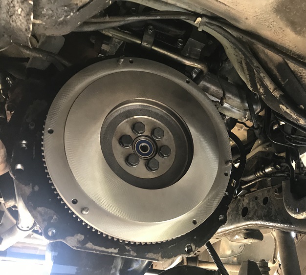

Attached Thumbnails 85 4runner Auto to 5sp conversion-jack.jpg   85 4runner Auto to 5sp conversion-ground.jpg   85 4runner Auto to 5sp conversion-out.jpg

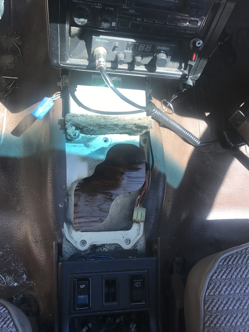

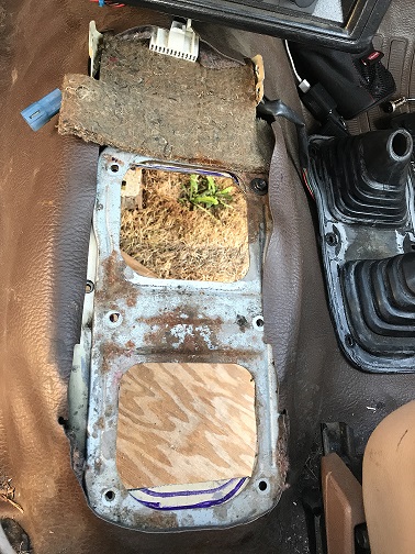

Ok everything is out now...Do have a few questions. See picture YEA! ( and thanks folks)
Looks like I do not need to cut anything just need to get the 5 speed shifter assembly and mount into existing area pictured? Is that correct?
Also, there are two plugs the one on right was for PWR and NRML switch buttons to auto trans ( not needed any more),
The one on left I suspect went to starter, I guess, and I have 3 questions about that?
(1) Can someone confirm that please?
(2) Will I need to complete the circuit using those wires to make vehicle think it is in park ( to start?)
(3) Seems to me while doing this I could wire a hidden switch to that system of wires making a theft prevention system?
ANY OTHER THOUGHTS ABOUT ANYTHING ELSE BEFORE I GET STARTED INSTALLING NEXT WEEK? thx....
Old Jul 27, 2017 | 08:02 AM
irab88's Avatar
iTrader: (4)
Joined: Jul 2010
Posts: 6,499
Likes: 37
Is that a rear-driveline disconnect?
The hole in the floor will need to be opened up a bit.
The N/P switch will be bypassed, instead going from the starter relay directly to the circuit opening relay. I forget what the clutch-switch wiring is like. Look at a wiring diagram to find it. Basically, it will be a lot simpler.
A theft prevention system is a good idea. And yes, it would be a good idea to do it now. Just don't show us where you hid the switch!

I do not understand the first question... Unless you are asking if I removed the rear drive shaft - yes..

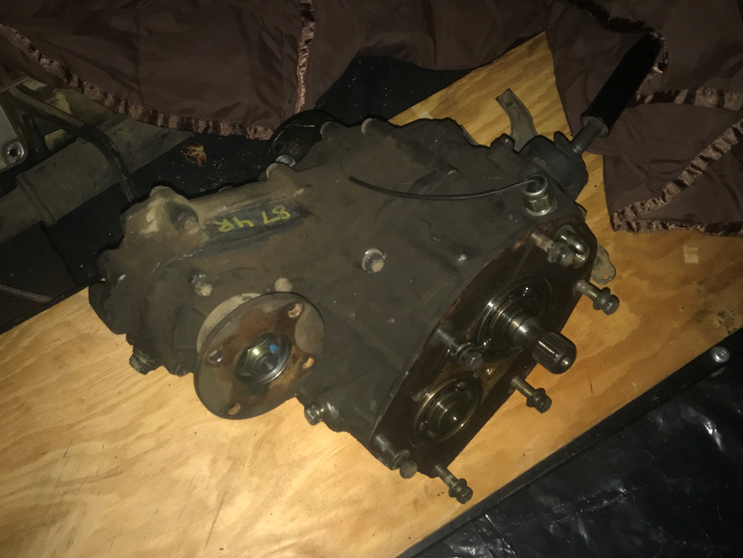

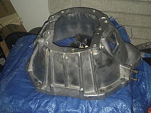

Got the goodies! Cleaning them up.. waiting on a few things...Bought new shift dust boots for tranny and tcase, tcase to tranny gasket, and new fork.
What can I use and where to get them? for Hard metal line master to slave?

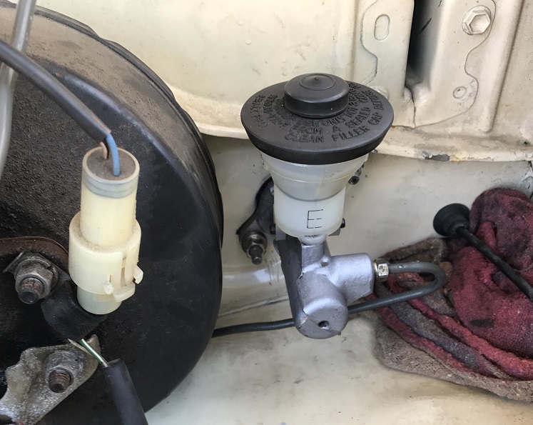

OK got started today and found a few trucks at the salvage yard and saw the routing for the hard line clutch hydraulics on a rig there. Seems two clips that route the brake hydraulics on my truck have a spot for the clutch line until it goes down to the transmission. I needed one more clip for hard line and got it off the salvage yard truck. An issue came up in that the top mounting bracket where the soft line to the slave cylinder starts ( upper) is not on my truck. I broke the welds off the salvage truck for the part and will have to get it attached. No room to weld it so I guess bolt it in through the floor board. (Suggestions???)
Getting the master cylinder hole drilled was a pain as I could not find my step bit and spent most the day looking for that. The old peddle bracket for the automatic would not come out, or getting access to, without removing the lower dash cover and the venting there. I also had to dissemble the larger break peddle to get it out. Once out I compared it to the manual assembly peddle brackets and there are some minor differences, but the important stuff is the same like bolt pattern, master cylinder mounting, and brake peddle alignment. So back in with the automatic peddle bracket so to get alignment on holes for master cylinder. The manual peddle bracket has studs to bolt on master cylinder , the automatic peddle bracket does not have studs for master cylinder, so holes need to be cut before mounting that. I can't find my router bits to smooth cut out so will just go buy some more tomorrow to smooth edges. I left about 1 mm to re-verify center and smooth edges.

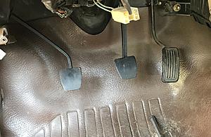

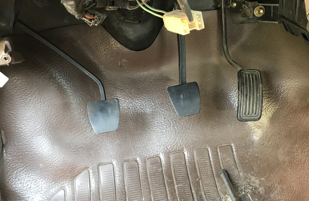

OK progress made today. So no markers on 1st run 85 4runner firewall as to where to drill holes for master cylinder, and bolts, free styled it but got the hole cut out well. I used a 35 mm spade bit which gave me a center from inside cab tapped with hammer and made a hole through fire wall. The 35mm spade bit was a good fit for the hole in pedal bracket which receives cylinder. However, the hole for the master cylinder is only about 30mm. Then it was drilled out with a step bit from the engine side drilling into the vehicle. Had to remove coil to make room for drill. I made hole cut to under 2mm short of what is required for Master cylinder. From there I filed it down with a half round file and it needed bias to the bottom and left. I was a tiny bit off center originally. By the time it was done I think I got it perfect! Was well lined with pedal.
The 86 pedal bracket had a minor misalignment on one bolt, but other then that all went in well. I think there were 8 bolts and the two studs for master cylinder for the 86 pedal assembly. I had to remove the brake to get it in and out. 7 of the bolts and the two studs lined up great ( missed lower stud by a few hairs no biggy). The last bolt pictured was just over 1/8 - 1/4 right of target due to a minor change to pedal bracket I guess. I just booger-ed out the hole and drilled a few cutting bolts in a bit sideways. The first few stripped bolt threads but by the 4th it seated well and torqued down. Definitely qualifies as "IN"..
A little measuring from adapter plate to floor opening, and measuring from front bell housing to stick shift cover plate on tranny on my floor, gave me the measurements for new bracket to house shifter. Cut all that out and hopefully I didn't go stupid during this process but will find out tomorrow. Tomorrow the clutch on and tranny back in...

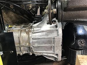

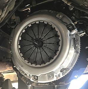

Alright clutch and tranny back in. All went well no major surprises. Pictures show the story. The transmission adapter on the floor jack with tranny on it W56b at the highest point was 26" ( top of the bell housing). Able to get car frame up 24" in back yard and just wiggles tranny forward and back to get into area under truck then lowered truck back down to do work. Tranny/tcase shifters lined up well with cuts in floor board. Since I no longer have welded bolts under floor board, to secure shift bracket, I was worried about lower nut access on the 6 bolts/nuts holding down bracket. I put then bracket in to mock up tranny shift alignment, but will have to remove for shifters to go back in. But plenty of room to all 6 nuts - non-issue.
Two of the automatic bell housing bolts ( top ones) were too long by 1/2 inch. Not sure if that is an auto to manual swap thing, or an 85 4runner auto with 86 4runner bell housing thing. Bought the Marlin Crawler transfer case mount that went in OK just took a little finagling and a few road bounces and she will meld to a custom fit for next time. The back right passenger side cross member bolt is spinning so I will get a longer bolt and another nut and lock her down that way.
