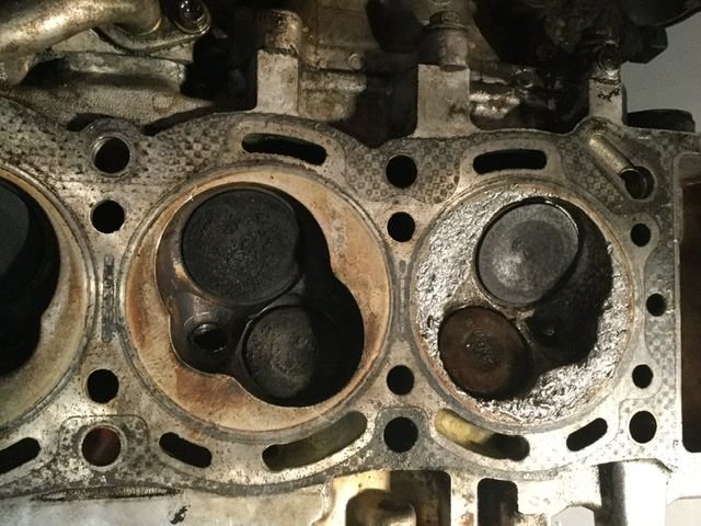

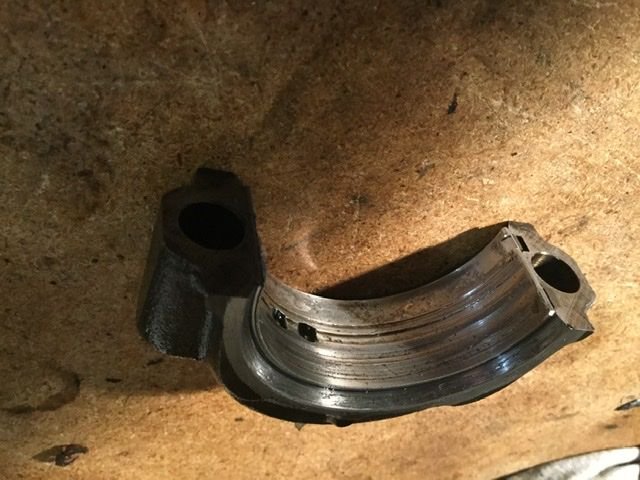

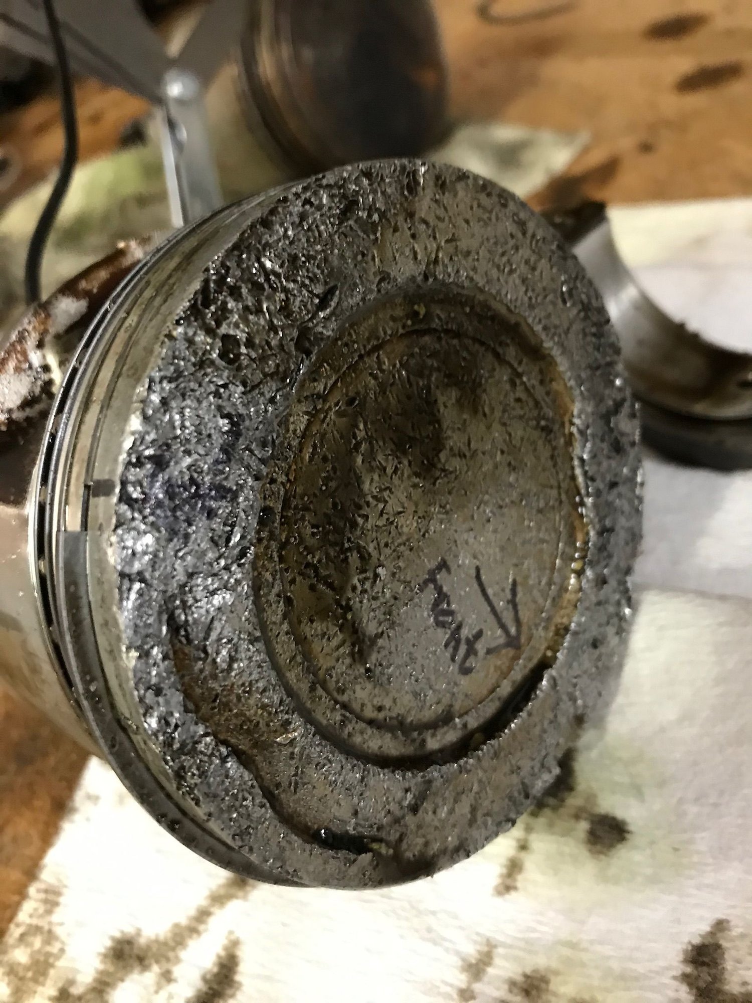

I am new to the forum but have been reading threads on here for several years. Recently had problem with 85 Toyota pickup 22re valve seat falling. Head was damaged along with top of no. 1 piston. I purchased a new head and decided to take a closer look at the bottom end while the engine was apart. No. 3 connecting rod bearing was bad, and appears as crankshaft is damaged. I will be replacing all the main bearings and connecting rod bearings. Is it best to just buy a new crankshaft or have the original one repolished? Also, should I replace all four pistons and rings, or just the damaged one? I’m trying not to disturb any more of the engine then I have to. This pickup is also a work pickup that rarely sees the highway, so I’m trying to get it back going without putting a ton a money into it.

If you pulling the crank put new pistons and rings in. You already have a new head and are pulling the crank. So send the crank and rods out to be checked and sized for new bearings. Find a machine shop to flush & bore your block so you know what size pistons to order. Most machine shops know the places to outsource work like cranks and stuff if you dont know one.

Precision measurements are essential to determine the condition of cylinder bores and crank journals before deciding what repair/replacements are necessary.
Reconditioning of a sound, uncorroded, genuine Toyota head casting is preferable to any new aftermarket head, with the possible exception of the Very expensive Spanish made ones.
All others I have examined are Chinese junk. Some not even having the oil dams that provide cam lobe lubrication cast properly.
I wouldn't trust Chinese metallurgy to exhaust valves that must operate at continuous red heat either.
A polish or regrind of your existing crank should be as good as the purchase of any other reworked crank, if your choice of machine shops is good.
Replacement of only part of rod, or main bearing shells, or of one or two pistons and rings is foolish.
Pistons, rings, rod and main shells are very inexpensive, and the work to change all is insignificantly more than that to change part of any of them.,
Hard to be sure from the images, but I don't think I see the Toyota OEM marks on the valve faces.
I would be interested to know if the head that dropped a valve seat was OEM.
