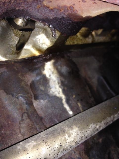

Thanks for the quick response Brotha!!!!! I've been wrecking my brain on this one and you've helped me solve it! I was hoping it wasn't going to be the HG but with 298K on her it was bound to happen. Just found this leak on the engine block side, Cylinder #2. Looks like coolant to me. Damn!
Thanks again for your help, much appreciated
No problem man thats what we are here for sorry about the HG just dont give up on her and dont cut corners there is great info on here about what parts to use i would suggest checking out http://www.engnbldr.com/ you wont be dissapointed
