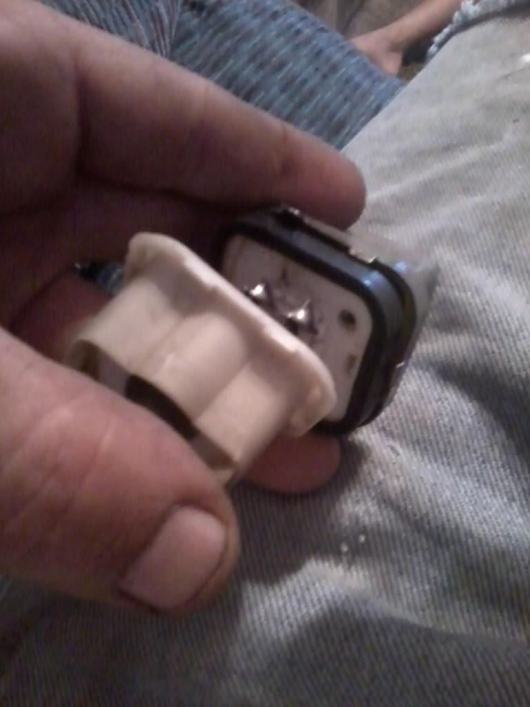

Cleaning the Starter Relays contacts helps as well. I will see later if I can find the link showing the contacts. I got it somewhere, just got to find it. I used some fine grit sandpaper to clean the contacts. RAD4Runner has some great info on his build thread as well.
I used a screw driver to work around the edges of the seal to help free the cover.

Nice
Good picture.
