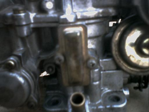

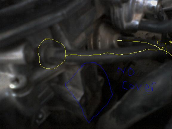

yea... but a whole second carb for 50 bucks is still a good deal. I got a few questions about some parts missing on the carb on my truck that ARE on the other carb i got. First pic(pic of carb i bought today) is the piece that is missing off the side of the carb on my truck right now. Second pic shows you that its msising and there is a "vaccum" line that when i blow into it it doesnt have any resistance or anything just flow into the carb. It goes into a t then into the module that lets the seconday flap open. Problem is that my secondary doesnt really work on the carb on my truck right now. Once in a while it works but 95% of the time it actualy starts to kill bog out the engine when i put my foot into the secondary while drive(doesnt matter if it under a load uphill or on the flat or even going downhill). couldnt not having that plate have somthing to do with it? The fuel cut solenoid doesnt have anything to do with the secondary does it?

Let me try and be a little more specific, the 83 carb should work on your truck, but might not have all the same vacuum conections or the same electrical conections as your stock 84 carb. with a few changes (the electrical plug and vacuum line changes) it should work. looking at your first picture, that cover is not used on the later carbs (i can`t remember what its called), 2nd picture i can`t tell, the picture is not very clear. as an example, my truck is an 85 and when i got it the previous owner had the wrong carb on it, i found the stock carb in the bed under a bunch of junk and when i put it back on my truck wouldn`t start, so after some checking i found the fuel cut solenoid to be bad. i went to pic n pull and found a solenoid cleaned up the carb and put it back on my truck and it runs perfect. i did go back to pic n pull and find another carb so i would have a spare. so the 83 carb will be different from your 84, carbs on 84 and 85 trucks are exactly the same, carbs on 86 trucks are also the same but they changed the electrical plug.
also make sure that all of your vacuum line are hooked up right.
