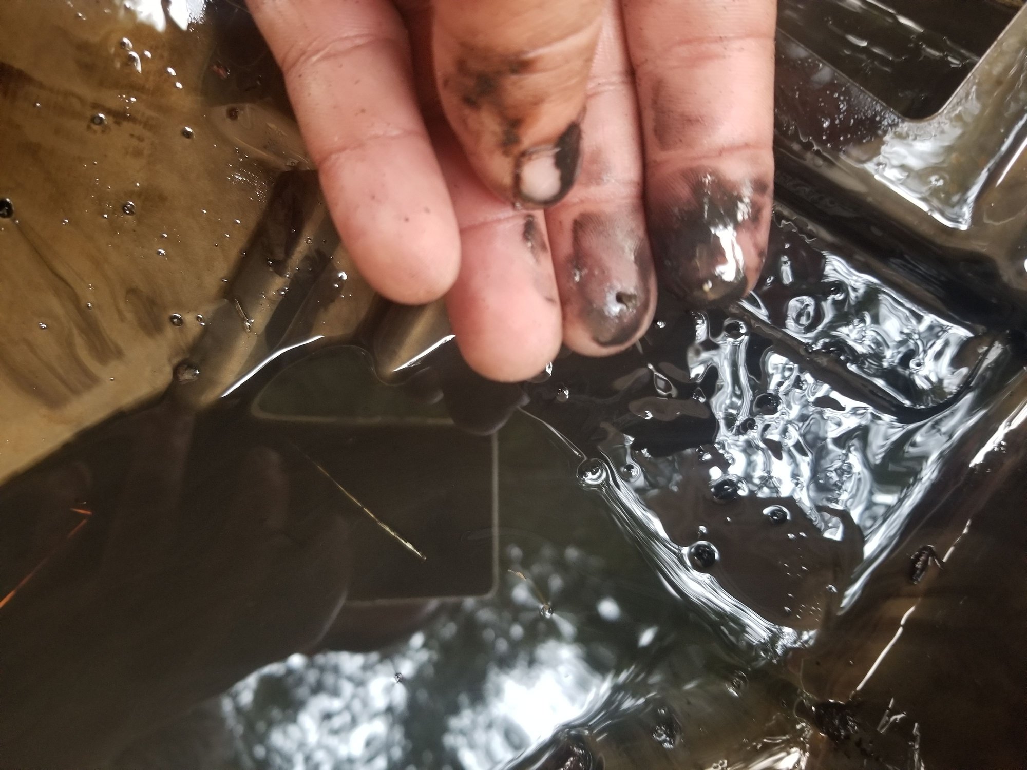

Found all kinds of metal in the oil pan

Not to doubt you but did you take a magnet to any of those little pieces to make sure they are metal? I know a freshly rebuilt engine shouldn't have that in it but just wondering if that material is something other than metal. The 22R is famous for shedding pieces of the timing chain guides (especially on the driver's side guide) over time, which are plastic. Can be hard to tell with all that oil on them.
Which makes me think of something else. Did the engine rebuilder use a new timing chain set or just recycle your old one? Or maybe never even touched the chain? That wouldn't be good. Sometimes that rattling noise can be a slack timing chain, due to multiple issues with it e.g. stretched chain, worn sprocket gears, plastic missing from guides, broken bolt hole(s) in guide plates, broken guide, bad/failing chain tensioner. That could explain the weird timing & idle issues too. A slack timing chain will retard timing; that would account for you previously stated timing setting of 18 degrees (I assume at idle?) to get it to run. Should be 5 degrees for the 22R, so that's 13 degrees out, reasonable enough symptom for excessive timing chain slack.
There are 2 ways to check this. Take off the distributor cap so you can see the rotor. Put a socket on the bolt on the crankshaft pulley and rotate the engine (in the normal running direction) with that while watching the rotor. The rotor should turn almost immediately when you rotate the engine if the chain & it's parts are good. I use the crank pulley timing mark as a guide, starting with it on the mark. If you can rotate the engine 5 degrees or more in either direction before the rotor starts turning I'd say the timing chain has a problem. I also rotate the engine back & forth a bit to account for any "normal" slack in the chain; the chain setup has a tensioner that operates on oil pressure, so there will be a small amount of slack even on a good chain setup, but it should certainly be less than 5 degrees.
The second way is to take the valve cover off & have a look at the chain setup. With a flashlight you can see if any of the plastic on the guides is broken or missing, if the guides themselves are broken, or if the top cam gear has any significant wear. Also look for any deep grooves in the guides. You can also get a big screwdriver down there & push on the driver's side of the chain to see how much slack you have. You can also push on the driver's side guide to see if it moves excessively.
Sure hope this isn't your problem. Not difficult to replace the timing set but it is a fair amount of work.

Sorry quick reply. Didnt read all you posted I am driving. It's hard plastic parts. I will read more and reply. It has been machined 2x that I know of. So if it's been machined to much I will have to add shim. I need to measure block and head. And no I dont have paperwork on any of the machine work.

So turned motor by hand alot of slack on the driver side of the chain. Everything new in there. He put plastic guides in and not the metal ones I ordered. Guides dont see any markings or ware. Another friend if mine told me I need to measure the block and head to see exactly how much was machined off. Cause if to far off it would need to be shimed.

It's starting to sound like a lazy & dishonest "engine rebuilder" victimized you. IF all of the timing chain parts are new & the engine was TOTALLY rebuilt, there should be no reason to have small plastic parts in the oil pan. They are likely leftovers from the old guides, & he didn't even bother to take the pan off to clean it out & put in a new pan gasket. Not a good sign. That also means the bottom end wasn't even touched. There is no way to unbolt rod caps & remove the rods & pistons & replace with new with the oil pan on it.
You said the guides don't have any marks or wear, yet you have a lot of chain slack. I'm suspecting that only the guides are new because the old ones were chewed up & making noise. He may not have replaced the chain, gears or tensioner at all. I'd still like to hear the results of the 1st test I previously described (turning engine by hand, watching for rotor movement). That would definitely tell me if this is true or not. When you have more time to read what I wrote I think you'll see what I mean.
Your friend has a point, but I would also suspect that if this guy took those other "shortcuts" he probably couldn't be bother too much about getting the head, much less the block, machined. May have just popped the head off, threw a new head gasket at it & called it good. Also, if the head & block had been machined so far that they would need to be shimmed, you would have known this a while ago, as the clearance between the valves & head would not be there. Without the shim, the valves would have beaten the piston tops to death & the engine would have broken/stopped running pretty quick. The noises from that would be unmistakable, as would the VERY poor running, if it would run at all.
Knowing now that there is reason to suspect that the "rebuilder" short-cutted the process, I still think your main problem is the timing chain & related parts. It sounds like the guy did just enough to get it to run without sounding like a bunch of marbles in a tin can. Have at the tests I told you about & go from there, & don't worry about head shims right now. No substitute for good diagnosis. Again, I'll try to help you from here as much as possible.
