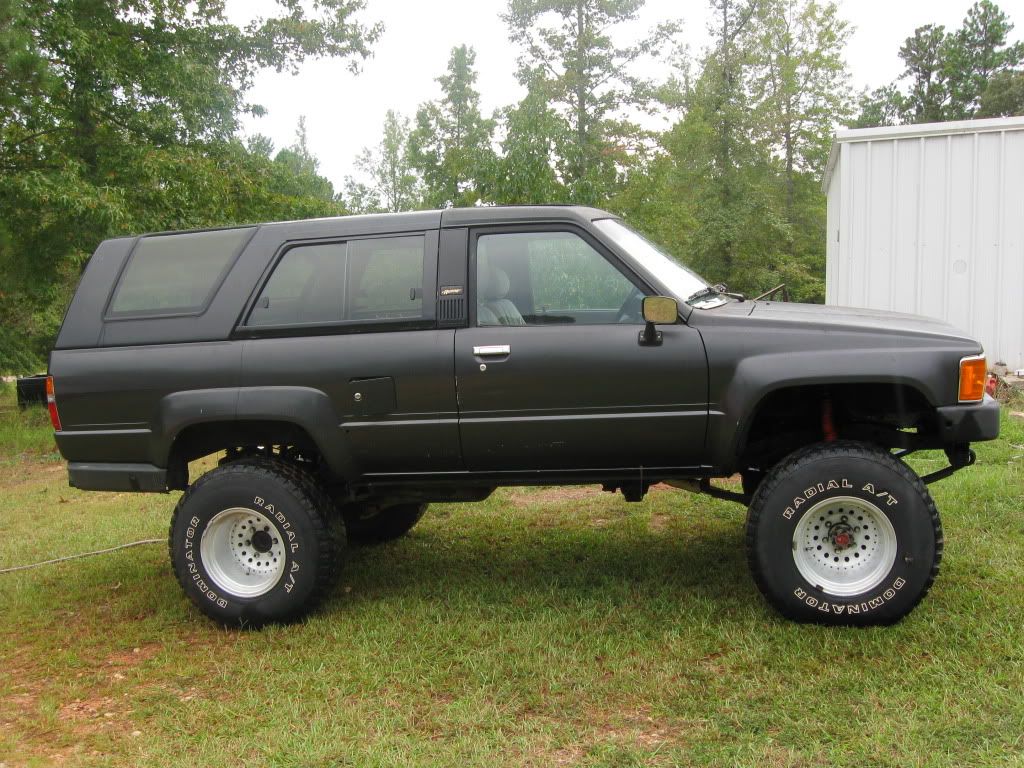

I bought this 85 SR5 4runner for $300. It has new 5.23 gears w/ loc right's and a new transmission. It had a blown head gasket when I bought it. I checked compression had a 180 PSI in all cyclinders. I checked the head once it was off and found the head was cracked. I got a rebuilt head, instaled new head, hoses, t-stat, and changed the oil twice after repair. Truck ran great for a while and then started knocking. Removed pan and found one bearing had spun. I removed all the bearings and found they had rusted, the truck sat for five years. So my question is can I use a real fine emory cloth on the crank and put new rod bearings in it? The crank is not scored. If I need to rebuild it should I rebuilt the 22re or put a chevy 4.3 in? I have a holley TBI and a computer for a 4.3, bought to swap in the future. I plan on using the truck as a back up vehicle, camping, and light trail play. Any information would be great, thanks for looking.

P.S. Is this your truck?

Thank you for the feedback. I guess I will tear it down. My 87 runner is torn down also. I might just fix the 87 runner and build the 85 for trails. Yes that pic is my truck. That is the after pic after a few hours of pressure washing with bleech and water to remove all the grim. I will post inside pics later. The previous owner tore all the panels out on the inside, but they are all there along w/ the SR5 seats. I will rino line the inside from the firewall to the tailgate.
