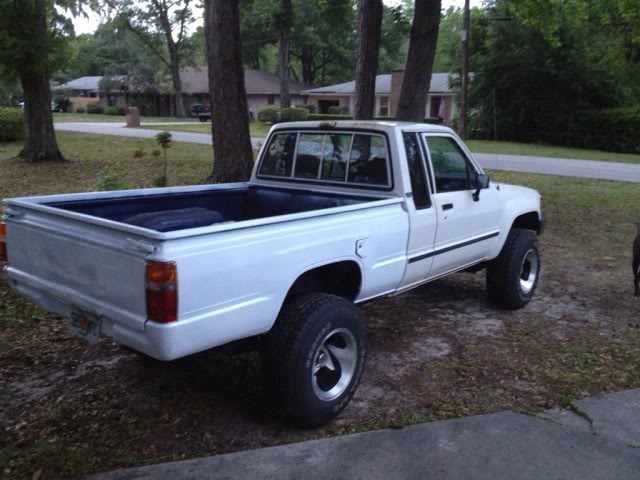

I have a 2wd bed on my 4wd extra cab,Bolted right on,lines dont match up too well but when you have no bed at all itll work in a pinch

FYI the american 2wd and 4wd beds are the same thing. The japanese beds are the one like pictured above and don't have the bulge over the rear wheel.
Edit: This truck was a 2wd to begin with. Notice the bed is exactly the same as a 4wd bed. This would be the American bed.
