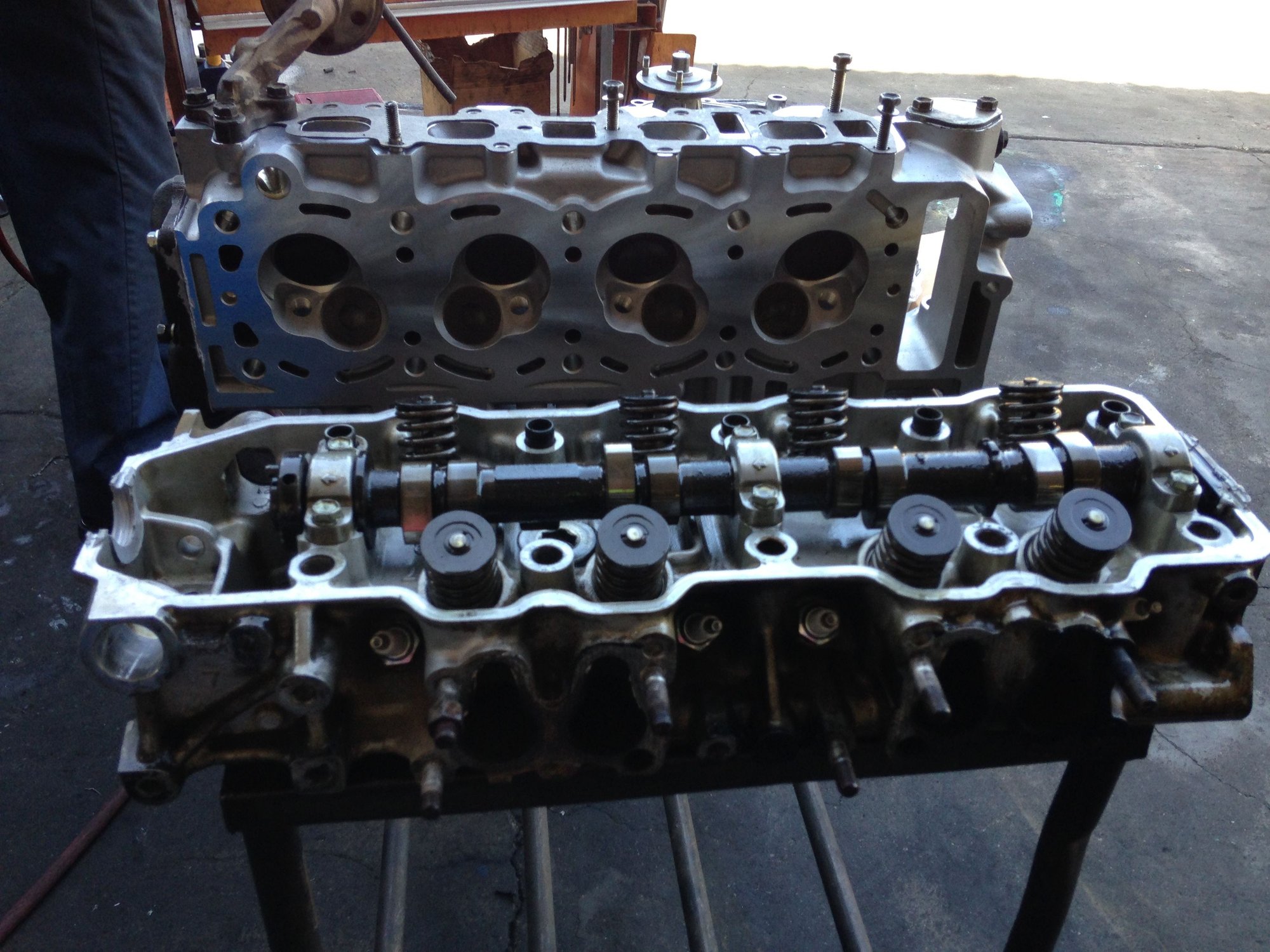

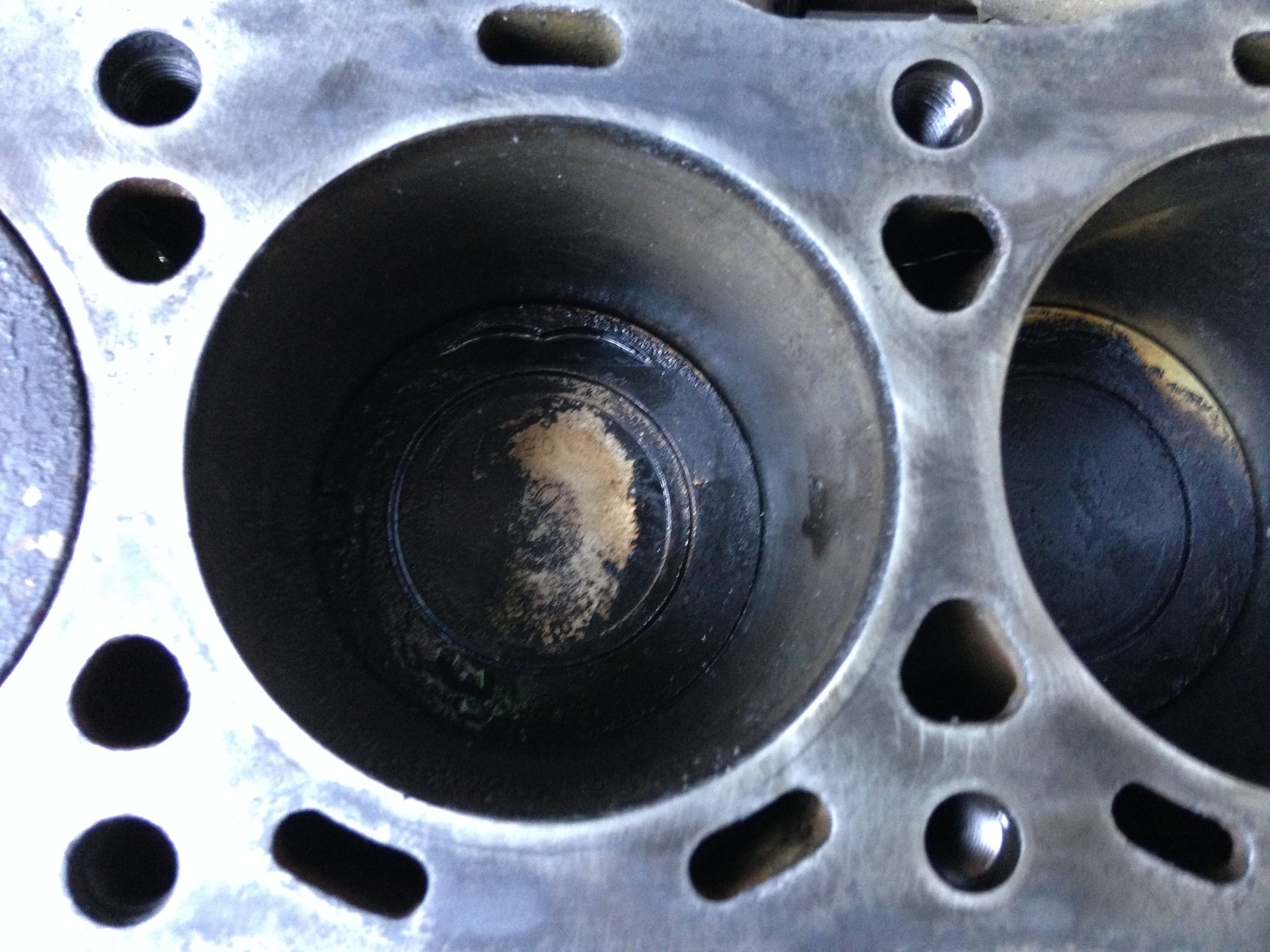

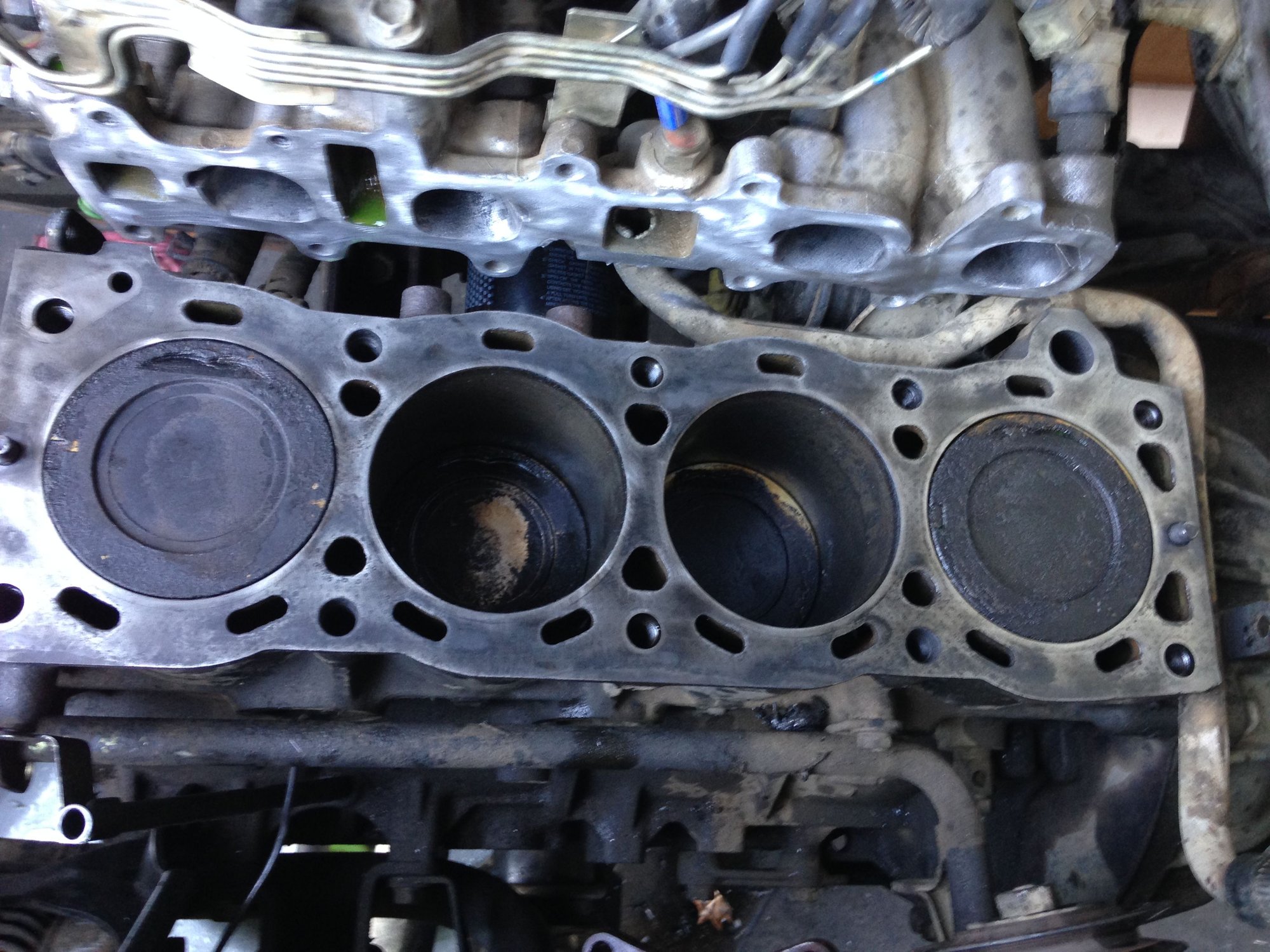

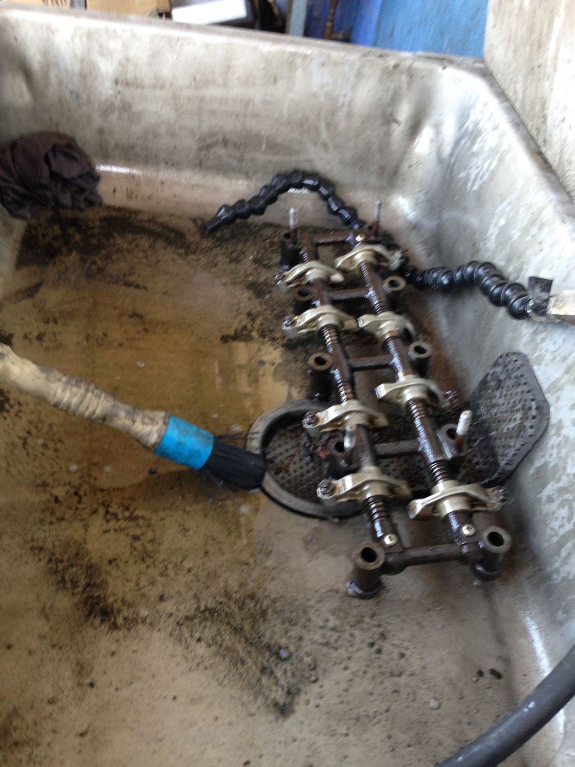

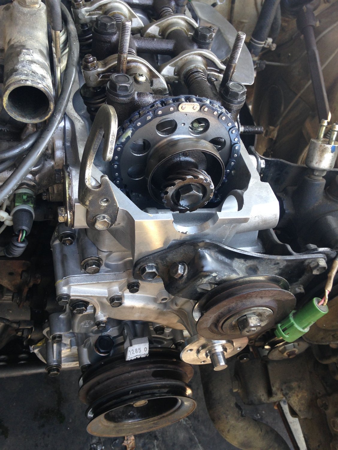

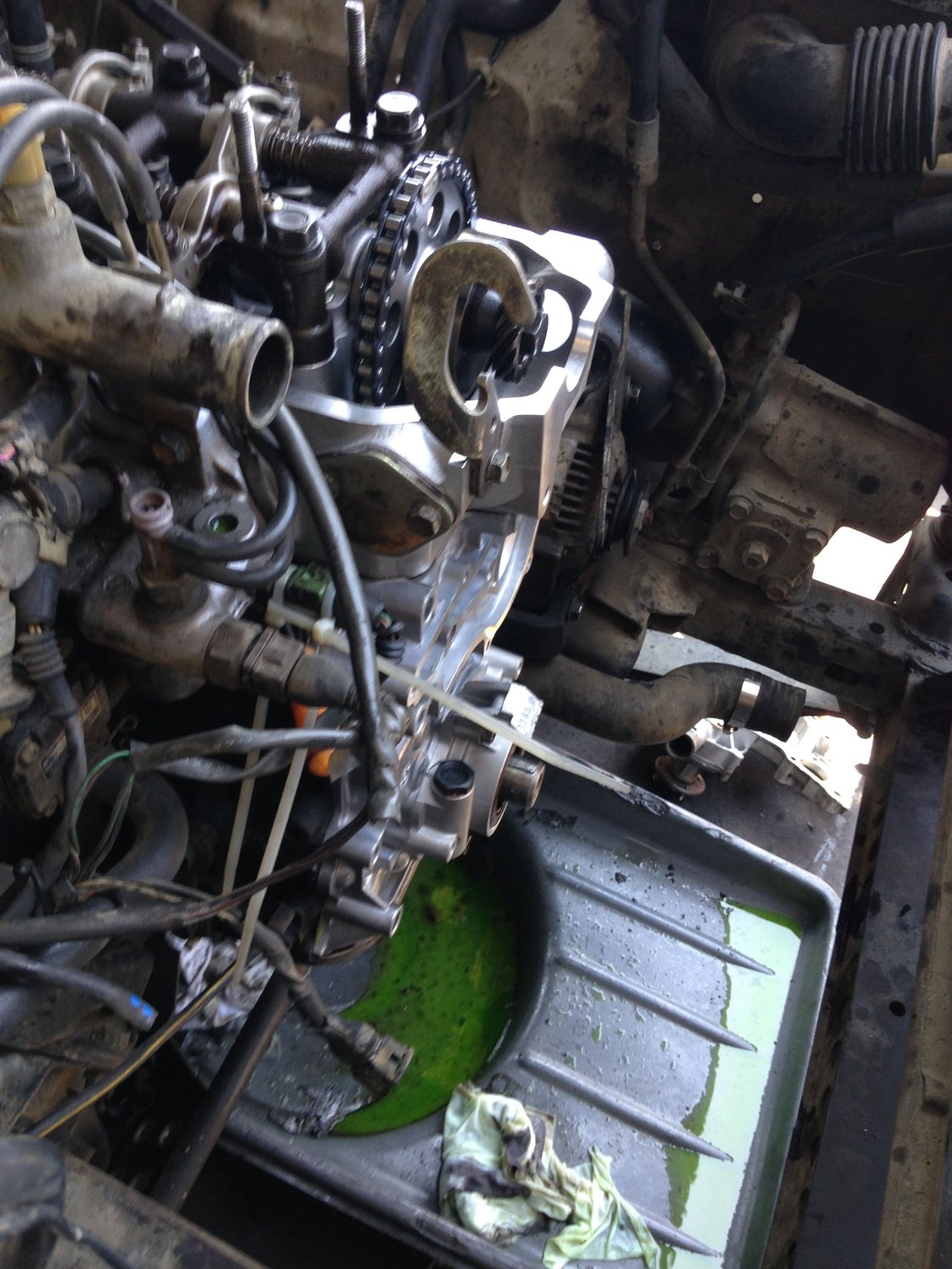

Hey guys, OK did a lot of work since my last post.
Lonfu, after looking back at that video just now I am amazed it ran myself! Yep, that's why I bought an old Toyota, so I could majorly mess something up and still not completely destroy it, haha. Love this truck, its already taught me so much in just the few months of owning it. It and you guys on this forum!
What you're saying about it being the wrong head makes SO much sense, I never even thought of that. Whatever it was...its gone now. I thought about trying to modify the chain or get an adjustable cam gear, but after seeing the prices at enginebuilder.com ($348 for new completely built head, $68 for new cam), I figured might as well just go for it.
I know a lot of you will probably say I should have just done a complete rebuild at this point. It basically boils down to cash, or lack thereof. I bought this truck pretty cheap and I got it to learn about how to work on it, so this seemed like a good project to do.
However, I didn't really have a lot of trust in myself after the timing chain disaster, so I knew I would need some help on this one. A small mechanic near my apartment drives a late 80's yota...after I talked to him it turns out he loves toyotas and working on the 22re motor! He actually offered to let me hang out while he did it and teach me a few things along the way. I was stoked!
Anyways, we did the job a couple days ago, and she is running SO much better!
PICS:
Timing chain is nice and tight now! All that noise is gone and she runs like a champ! Actually feels like more power than when I first bought it a few moths ago, when it was running well (pre-timing chain event).

That is the greatest timing chain pix that I've seen so far on the net, WOW what a great pix.
Glad to hear that you figured it out. I think it is very difficult to find some one elses screw up and fix it after the fact. great job!!!!! Your work looks very professional to me! fantastic job!!!!

Quick question? were the valves on the old head damaged due to interferance with the pistons?
