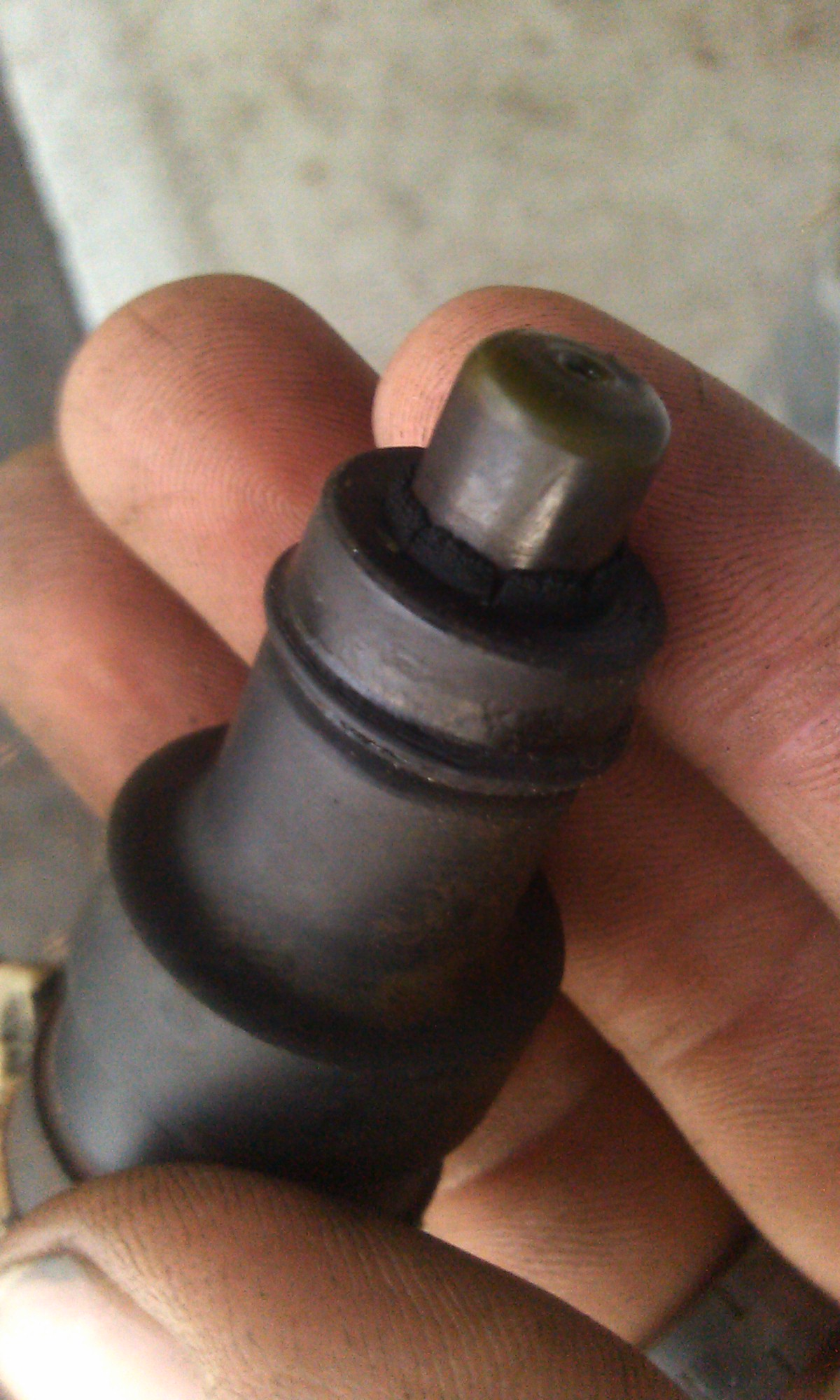

Good thing it was suggested that I replace the seals after I smelled that gas. They look pretty crispy. Was probably just waiting to happen anyways

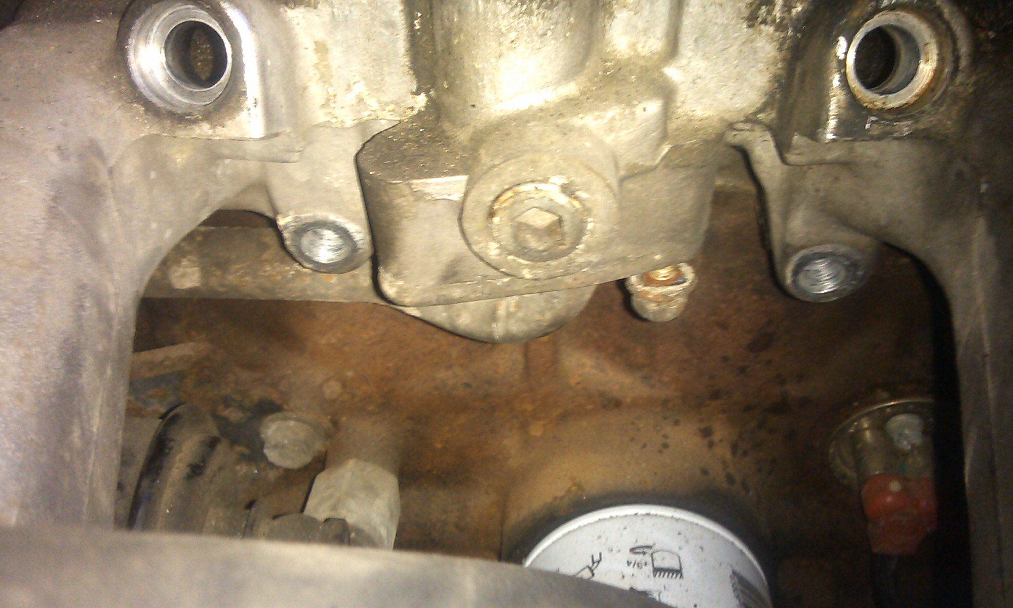

Haven't been making much progress today, it's raining off and on and every time it stops I run outside and take off a few bolts, then it starts back up raining again. Got the fuel rail off and injectors all set aside, and all the bolts I can see off the intake, but it would appear I have to remove this pipe first. Not sure what it is, or which end I should remove it at, but it feels pretty solid. Do I just take the two bolts off the bottom? I took them off already but was afraid to break the seal in case it wasn't supposed to come off...what is that huge hex nut for?

I believe that allen head is another drain. But thats a coolant line that runs AROUND the back of the head to the heater hoses. Just take those two bolts out.

There are coolant lines that attach to the timing cover on both sides of the engine. The one your thinking of has like 3 inches of hard line then immediately loops up and around to the throttle body/IACV. The one pictured is a line that wraps around the head to the heater hoses. Then on the driver's side behind the exhaust manifold is a straight pipe that also goes to the heater hoses.
