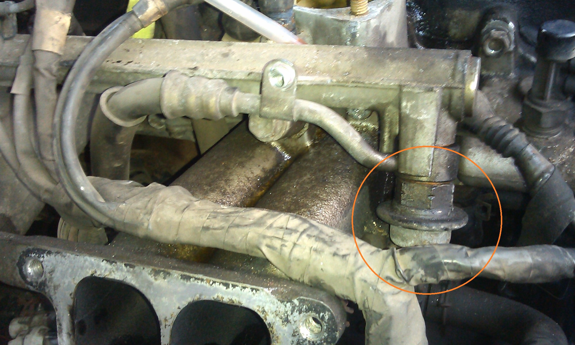

It appears I'm going to have to figure out that other bolt either way, maybe you know if this is what I have to remove to get that pipe out of the way? I had a wrench on it earlier but it wasn't budging and I was afraid maybe it wasn't supposed to come off.
okay just unbolt the intake from the head, its like 6 bolts, 12mm. its that simple... please don't undo that big bolt lol it'll never seal properly after

As far as that big bolt goes, is there a way to disconnect it at the other end of the line then? I kind of wanted to remove the whole manifold from the bay to clean it, but I suppose I'd probably have to remove the fuel rail anyways then. It would probably be best to just leave it be.

Why wouldnt it seal properly afterwards? I've reused the copper "gasket" before...it never leaked. Yes, it makes a mess to open, but if you do it RIGHT (placing a cup or something underneath) you wont end up with much or any dropped fuel.

Damn. That makes cutting the allen bolt pointless now that I'm going to have to remove the fuel rail anyways >< I could have just taken the fuel rail off and got the bolt with a vice grips haha. Live and learn I guess.
Looks like I am going to have to take that big bolt off anyways now. It's REALLY on there though. Also I read in the manual that I was supposed to basically run the truck out of fuel before starting all this...which I didn't do. Does that matter other than making a mess?
more i don't want him to risk unnecessarily, also most gasket kits come with new o-rings if you're that worried. but you should be fine as long as its not dripping heavily when running. also thats good that you haven't driven it much, had me worried there for a minute haha, when i first saw smoke out my tail i shut off and got a tow home and started tear down.
