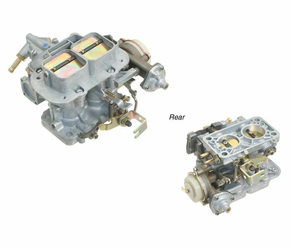

The choke are the plates on top, the throttle plates are the ones in the bottom picture.
The choke functions by closing (mostly) when the gas is pumped before the electric coil warms up. By restricting airflow it causes the engine to draw more gas from the carb while choke is engaged. When warmed up (the electric coil) the choke plate will stay open after the gas is pushed decently. That should drop idle to where it should be, like 700rpm ish vs 1100-1200 or so while choke is engaged.
Your problem could be that the choke wants to stay closed, but it think it's more likely that the throttle plates aren't returning all the way back to closed/idle position.
